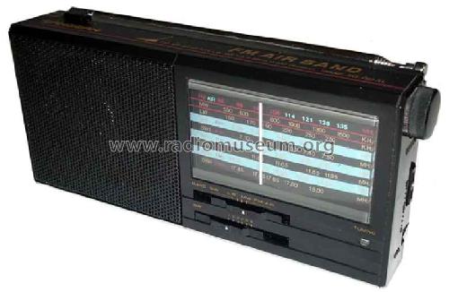

Hi and wow ... thanks a lot for the huge quantity of information.
I will try to read something but i am slow to learn.
Actually my need i think it is much more basic. Very basic.
I am looking for some kind of buzzer that put close to a component buzzes more when the component emits RFI.
For instance for temperature there are those handy and cheap infrared guns.
Is there a RFI gun ?
I mean, in a smps a capacitor or a resistor for sure they do not emits RFI or much lower than other components.
I need to spot those parts and try to shield them.
This is my main goal.
I have no chance to understand about how to design a pcb with attention to RFI issues ... no chance at all.
In general i am not so naive to hope to be able to design anything.
At least some modifications and not on smd parts for sure.
I would be more in the modding than in the designing of things.
In the end the equivalent of a Geiger meter for RFI that the more the RFI the more the buzz of the measurement.
This is the immediate goal.
Thanks a lot again. gino

Hi and thanks a lot for the kind and valuable advice.
In this phase i just need some kind of probe, the put close to the emitting part starts to buzz or gives an indication of the RFI presence.
The idea is:
1) to spot the RFI emitting parts
2) try to shield them
3) test again to understand the benefits of the shielding
Thanks a lot again, gino
May I present my favorite instrument, my most useful tool, which does exactly what You had been asking for?
Ciao, George
Hi George and thanks for the kind reply.
You mean that if i point the antenna of a radio on a pcb i could spot the parts responsible for emitting RFI ?
Now i have to find a radio ... i have not used one in years 🙄
Thanks a lot, gino
Use the radio in the medium-wave (AM) range, with it's built in ferrite antenna.
Try to tune in to the most sensitive spots in the frequency spectra.
Just turn on your device, close to your faulty smps and you will understand at once what I am talking about.
Can try also a scan through different frequncy ranges, try to tune through also the short wave bands. Though I find most useful MW.
Then move the unit around.
Try the diode bridges in your Linear! power supplies, of your pre-pre, pre or power amp..
Try the screen of your computer. The LCD screen of your laptop.
The huge TV set right in the middle of the hifi-console, so popular these days.
Try your amplified antenna cable descending from the attic.
The neon bulbs in the kitchen. The LED lights in your apartment. Even worse, the fluorescent bulbs of today, everywhere.
One could go on, forever..
Ps.: Forgot about the cordless phone bases, should be the first to depart with an elegant ballistic takeoff

Hi and thanks a lot again for the very helpful advice.
I would like just to precise that the smps is not really faulty ... it is just spitting RFI around because it has no shield at all.
I found it quite strange in an audio unit.
Even my pc has a shielded smps ... 😕 what the hell this people are doing ???
