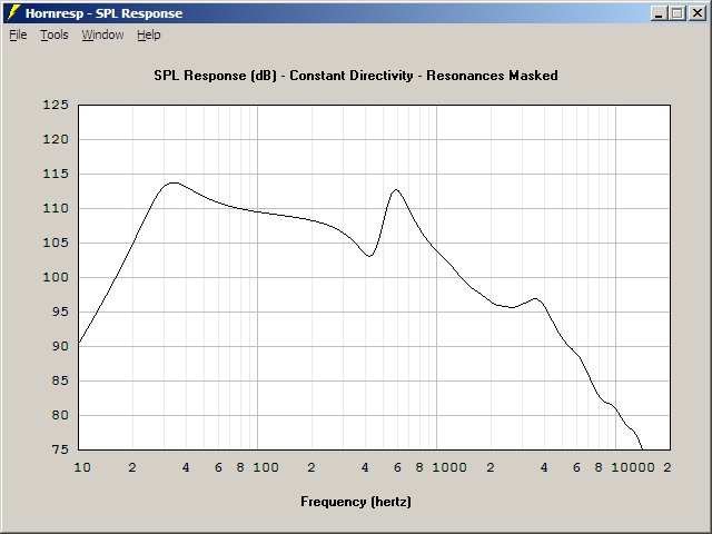

I modeled it a different way. I modeled it as if the enclosure was backwards. So there's a ported *rear* chamber, with a six inch port that's one half inch deep. (We don't know the depth, but we can guess.) The volume under the cone should be about 3.3liters. Again, we can only guess. Reducing the volume will change the tuning frequency of the bandpass.
Here's the modeled frequency response.

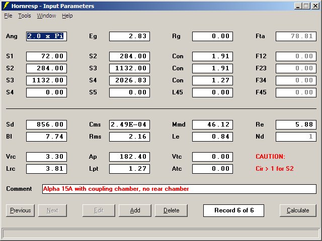

Here's the parameters I used. Note that the "horn" is actually the cone of the woofer itself. It has a diamter of fifteen inches and a depth of 1.5". I also added a baffle that's 20" wide.

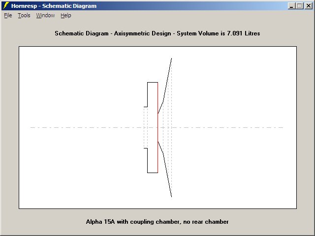

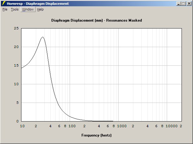

I don't know why I didn't think about the obvious reason to use a bandpass chamber in a dipole.
It reduces the excursion!
duh, how did I miss that?
So you tune the front chamber carefully, and you can double or quadruple the power handling, by reducing the excursion.

Hey John
I don't follow the cone excursion reduction. With a 100 Hz LP there will be no effect to the excursion below 100 Hz.
gedlee said:
Hey John
There's a 48db/octave electronic filter at 100hz.
But the coupling chamber in front of the woofer forms a physical lowpass. If they tuned it at ((2 * FS) / qes), then the reduction in excursion would occur at 53.59hz.
So that seems quite clever. You get a reduction in excursion at the tuning frequency, a reduction in 2nd and 3rd harmonic distortion, and a dipole radiation patterns.
If you're into dipoles, this seems like a serious improvement.
