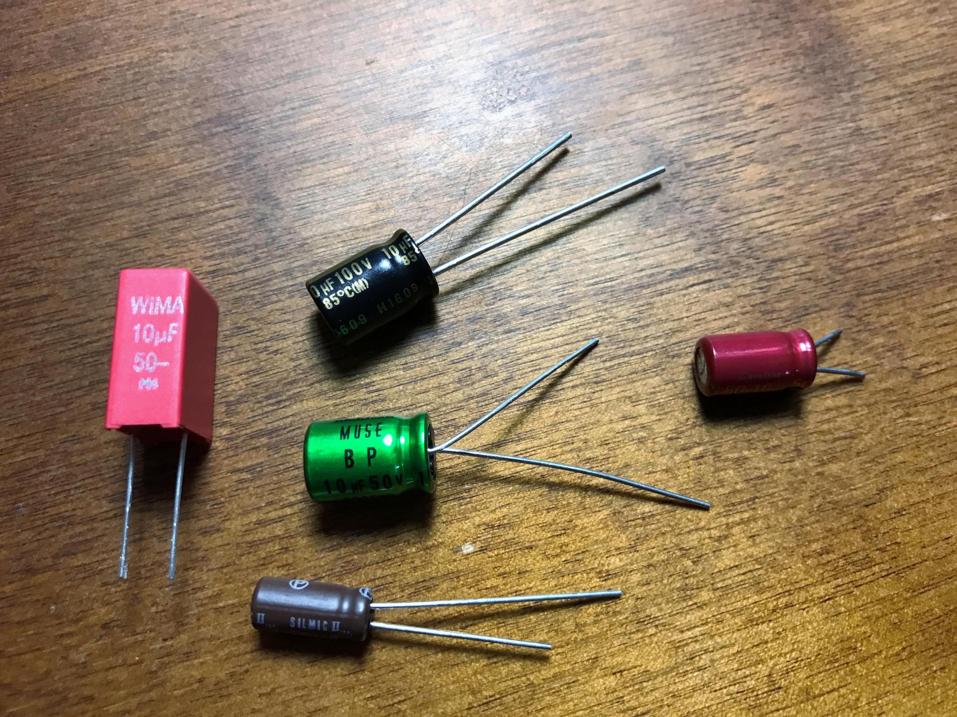

I want to replace the caps (10uF) in my power amplifier (VHex+) should I use the Jantzen Audio Cross-Caps or simply the Elna Silmic II?

Where is the cap you would like to replace? And what type of capacitor is the one you want to replace?

Just use a Wima film cap, that's what is used in a lot of high end solid state amps commercially availeble and it's not that expensive, probally even cheaper than a Jantzen cross cap. I would not use electrolytes as input or coupling cap, a film cap does it way better.
I would use these if you have the room.

The Wima MKS are only $3 and 7 x 16 x 11mm. Half the cost and 1/10th the size.

The polyester cap I mentioned (MKS2B051001N00JO00 WIMA | Mouser) has the best specs/size of any 10 uF capacitor of a reasonable size. Yes, a polypropylene cap has the lower DSR and ESR, but at a HUGE size that simply won't fit most applications. If you have found a better cap than the WIMA 10uF MKS, please share it!!

Cheap and pretty good, just not really small, but sometimes you can find a way to run leads to be able and mount larger parts. These won’t have an issue if there are leads, unlike power decoupling. I have glued these on before, as there is a good flat surface to make that possible.
