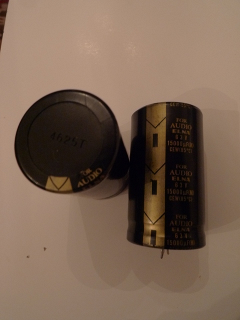

Hi ,
Recently I purchased on ebay (from Chinese seller) 2 Elnas for audio15000uF/63v.
They look quite suspicious to me, so I am not sure if they are genuine elnas.
They have black plastic top with sealed number 4625T. They do not have any coding on the sides like most of caps.
Can anyone assess if they are real or fake?

Well.... I recently purchased a very versatile LCRZ meter which allows me to measure from 40Hz to 200 Khz all wanted cap properties, and I am currently doing a very large aged cap survey, including also some new Elna power supply caps. I bought some genuine Elna Tonerex 63V 6800uF from germany and some doubtfull ones from china, labelled Elna Tonerex Kenwood 73V 8200uF. The latter are much slimmer, which is odd for a higher voltage and higher capacity. Secondly the tan delta (DF) and ESR are really collapsing after 5kHz, as where the genuine one goes on much longer (though not eternal). I intend to finish the measurements soon and to put it up here.
So I expect the slimmer one from HK to be relabelled fake ones, but I have to admit that the plastic sleeve and printing is almost identical to the genuine, including the aluminium top with typical Elna sword-shaped rupture path.
In your case, there are 2 things to check first: what is the manufacturing date? There should be some small printing like 0420 (meaning 2004, week 20). Depending on the date, we have to look up the Elna datasheets of that year, to see if the dimensions fit the Elna datasheet (first indication). I have seen genuine Elna's with plastic top cap before. Elna makes a lot of custom series for HiFi OEM clients, since they want certain looks, dimensions and voltages, and eventually some surplus is dumped in the market. My 'Kenwood' might be genuine, despite the odd size, odd voltage rating, and poor measurements (but I think it's crap).

Thanks Oscar,
I just looked at the caps again and definitely there is no any sort of coding or numbering except 4625t on the plastic cap.
Thanks for proposition of checking their electric specs but I afraid it is not worth of both ways postal cost. I will check at the post office tomorrow.

This is actually becoming a huge problem. At work we discovered some fake electrolytics b/c a power supply didn't deliver to specs. We eventually troubleshooted it down to the 'lytics and tested them with the HP4194 analyzer. They had about half the rated capacitance, and when compared to a known good real cap, we noticed a slight different font on the labelings. I can't remember which supplier we got them from, but they quickly threw out the remaining stock when we informed them. Turns out fake parts is a growing problem. My guess is the 'hotter' a component is, the more likely some fake clones are circulating the market.
Hi Semperfi, that's interesting; do you have any one of them left?
I've been digging deeper into the datasheets and I'm pretty sure one of my Elna's labelled "Tonerex / Kenwood / 73 V / 8200 uF(M) / Elna / CE 85 C" is probably fake, because:
- 73V does not exist across the LAO/LPO/Tonerex series (71V does)
- the can size (30 x 50) does not exist in that capacity range (it should be 35 x 50 for @ 71 V)
- the manufacturing country is missing; the data sheets and my genuine Elna have Thailand or Japan printed on them
- the font type for the word 'Tonerex' is different
- the snap-in terminals are longer
- the sword-shaped vent rupture groove is not across the whole diameter, actually not even nicely in the middle
- the sword-shaped vent rupture lines seem 'stamped' afterwards (deformed surface inwards), as where the genuine cap is really deep square groove
- and finally, the the ESR is double/tripple while the DF (tan d) is going to infinity around 5 kHz (don't want that in your amp....)
So bartmallow, what are the dimensions of your caps? They seem pretty slim to me for that capacity / rated voltage, and there is also no country printed on them.
And more sorry for this: 15000uF @ 63V does not exist in the Elna LAO / LPO datasheets. 42 volt is last one for that capacity, sized 35 x 50 H.

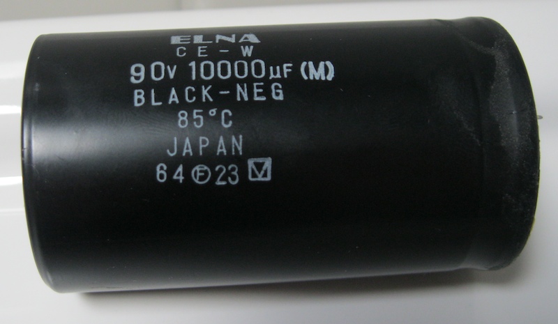

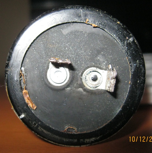

I just pulled some Elnas out of an old Kenwood amp and would like to reuse them.
I read that If they were custom caps for a manufacturer like kenwood they sometimes missed some lettering. Does anyone know what the 64F23 means?
My question is: which connection is positive, is it the one with the black dot?

It states right on the cap in your second pic the black is negative.

Then Kenwood was buying fake caps 15 years ago. I doubt it.
cbdb, if that Kenwood amp is 15+ years in age I would be very reluctant in reusing those caps
Why? I was using them, the tranny and the bridge to give me some power to start playing around. I will probably start with testing the power supply, including the caps.
I was replying to bartmalow (remember... that's his thread....) 😉

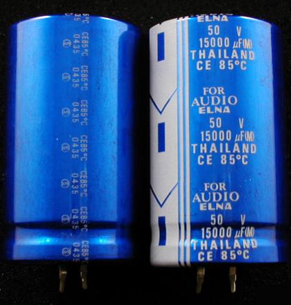

A bit later then promissed, but hereby some pics to show how you can indentify a (probably) fake Elna. The one the left is a genuine Elna LPO Tonerex.
As I said earlier, the following observations can be made:
- the gold printing is much lighter (higher bling-bling factor)
- the character spacing between is much less
- the font type for the word 'Tonerex' is different (other series with 'For Audio' should have same font as the tonerex on the left here)
On ebay, the first thing to check is the can size: Elna has mostly unique can sizes for given capacity/voltage. There are many close lookalikes which have dimensions that do not exist in the Elna datasheets.
PS; the fake 'Kenwood' model below is still on sale with HK ebayer, and there are several other 'Denon' and 'Marantz' ones, in fancy blue colors.

A word of caution on capacitor size, however... Elna and others also produce OEM type capacitors, with Kenwood, Sony, etc, own specifications, so there could be some OEM capacitors not exactly the same size as standard ones.
Also, the gold exact color can vary from batch to batch...
But it's true that with 30% less volume for the same energy storage capacity, is very suspicious, and there are so many "For Audio" out there that most must be fake
To conclude, what do you think of these...? they have the longer snap in pins are you pointed out, the flashy blue color, but they have the "Thailand" marking, and are sold from a reputable seller.....
To conclude, what do you think of these...? they have the longer snap in pins are you pointed out, the flashy blue color, but they have the "Thailand" marking, and are sold from a reputable seller.....![]()
Thanks for putting those pics up, the labelling looks good.
Well, have look at the datasheets (download from here, too large to attach). 50V-15000uF exist (type I only though), but are they 35 x 50 (diameter x height) sized? This is what I meant, it's easy to put a fake sheet around another cap which looks very much like an Elna, but it is hard to find Elna can dimensions if you want to fake one....
In the end, to be sure, you have to measure their properties. Will come back later on that.
But I agree that it is likely that Elna makes OEM caps, but why with different can size? At least your printing looks reasonable genuine (verify with data sheets), but mine is obviously off spec....
PS: and if I was in the counterfeit business, I would also print Denon, Marantz etc on it... I have seen your blue babies with 'Denon' printed on them, which is something else as 'Thailand'
EDIT: how does the top of yours look like (is the rupture groove across the whole diameter?).
