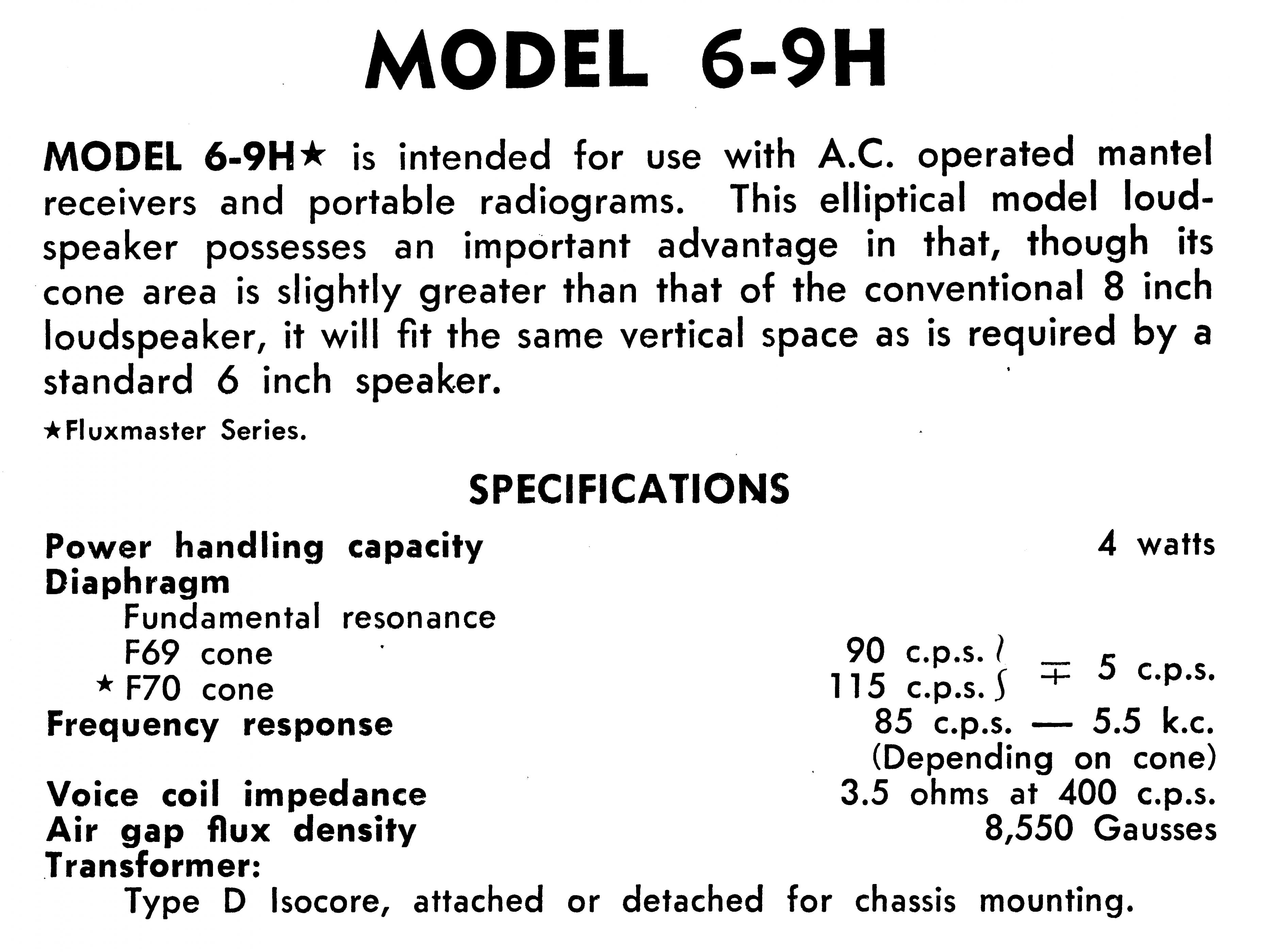

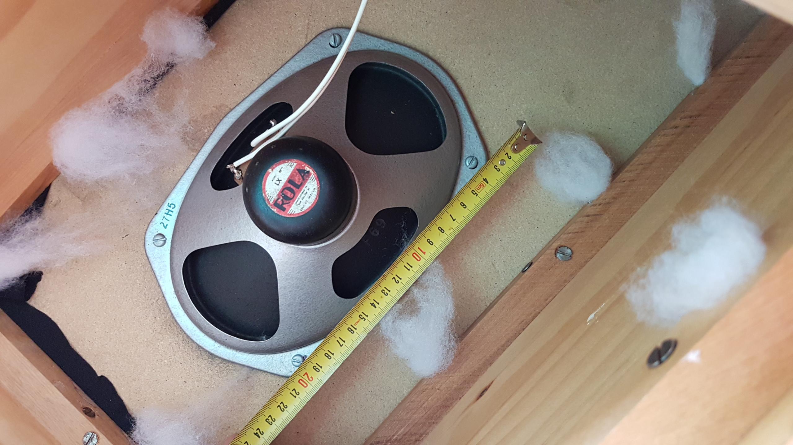

The pair I have are vintage Rolas, which are marked 'LX' on the back of the magnet, and '27H5' on the chassis. Kinda hard finding information on these online, and apart from a scanned copy of an old Rola catalogue, I've found basically nothing, not even any pics/images of what I have. The closest thing in the catalogue is what is referred to as a '6-9H' although what I have is different, having a 5x7" cone (presuming that's what's meant by the numbers in their catalogue)

You'll need the Thiele-Small parameters to figure out what sort of cabinet they'll go into. Frugel-Horn XL would be worth consideration - I don't think they'll fit into a normal FH3.
Chris
Thanks, have just done a little reading on this, it may be something a friend can do for me, he builds and tests all sorts of gear.
Am I going to end up needing to go the custom cabinet route? Or are there generally cabinets that suit a certain range of values?
I think you're gonna have to see how the T/S come back. I'm expecting a Qts >1, which is really only suitable for open baffle or leaky enclosures.
