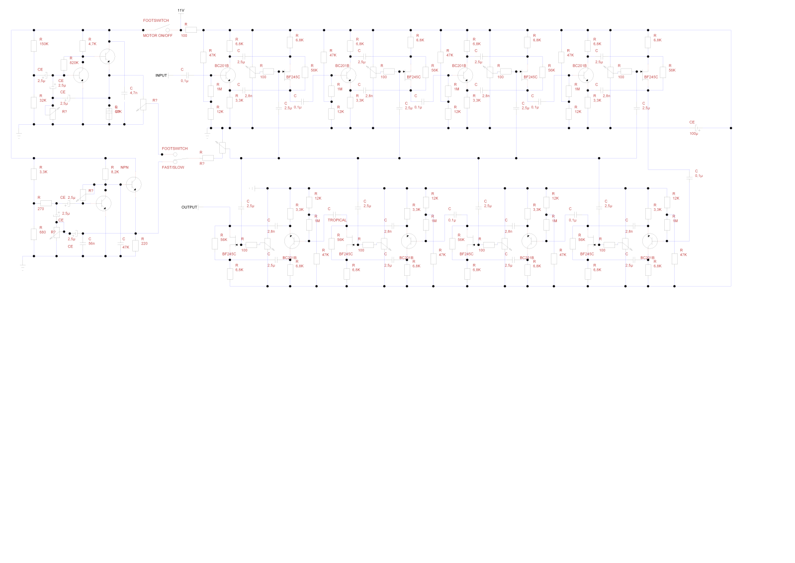

btw, there's also some kind of leslie-simulating-effect for the woofers (there's no spinning drum, like in the real deal. Instead there's this simulator). I made a schematic of that print. I'll post it here, maybe it will be usefull to someone in the future.
i added it as an attachment.
measure dc voltages?
ok...pretty straightforward opamps...if you just measure and report the dc voltages on all the pins, that would be a great hint!
Replace any tantalum capacitors you find. These have a limited life span and when they fail, they go short circuit and typically explode! Though i dont actually see any on the photos. Metallised polyester and ceramics are fine.
Electrolytic capacitors in the signal paths going bad could cause all sorts of weirdness. You really can't diagnose anything else until you rule out failed caps by replacement.
The leslie simulator looks like some sort of EQ circuit

PS: here's a direct link to the leslie sim schematic, it's easier to read 😉
http://i56.tinypic.com/fk9ogo.png

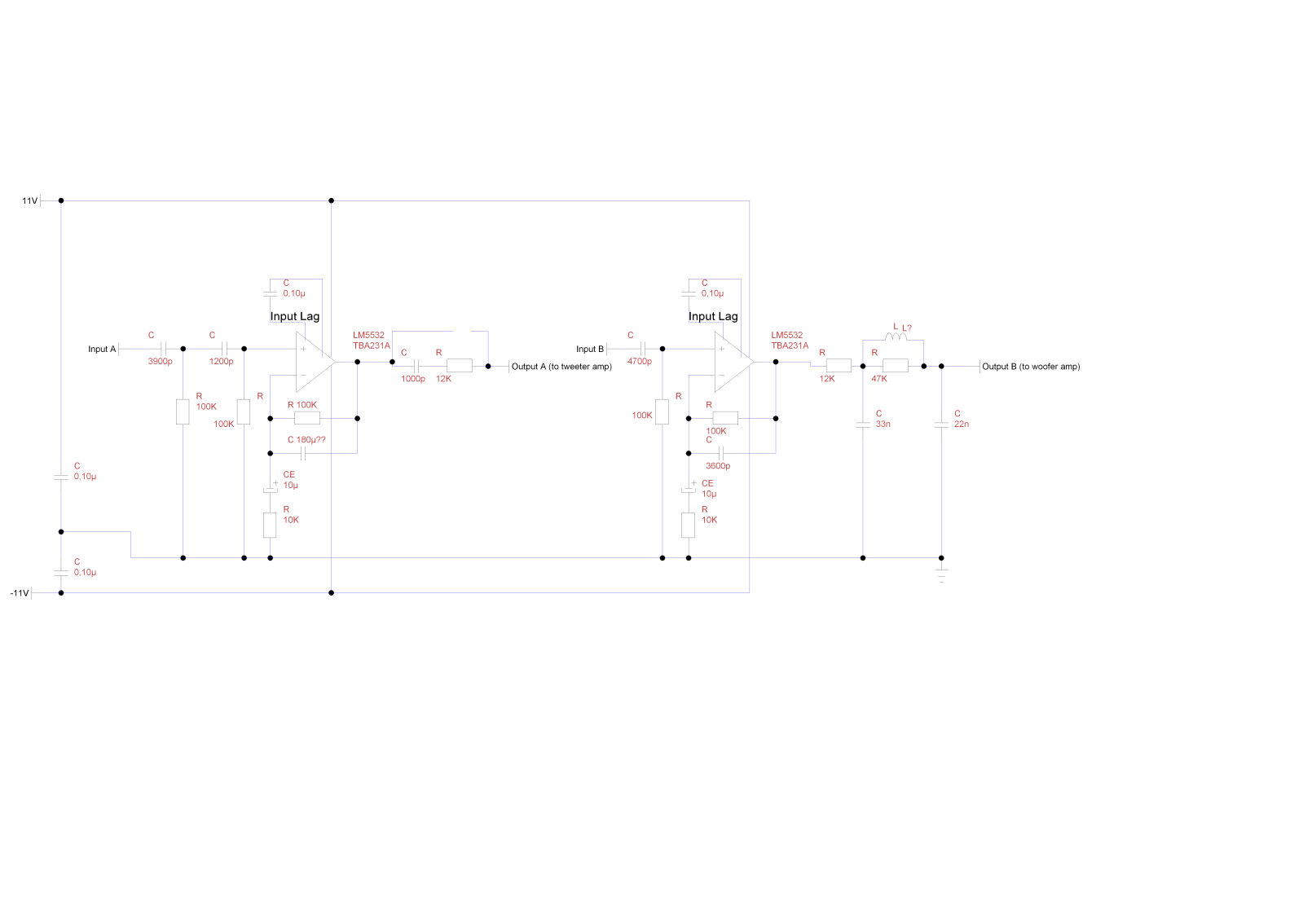

okay, did the tests:
INV. INPUT B: not stable. when i put my test leads to this, it reads a few volts but then it drops down to almost nothing. Like some capacitor is decharging over my voltmeter.
NON INV. INPUT B: -0.136V
INPUT LAG B: 6,00V
INPUT LAG B: 8,34V
OUTPUT LAG B: 10,93V
OUTPUT B: not stable. See INV. INPUT B.
V+: 11,08V
V-: -10,82V
INV. INPUT A: -0,08V
NON INV. INPUT A: -0,07V
INPUT LAG A: 7,29V
INPUT LAG A: 7,27V
OUTPUT LAG A: 10,07V
OUTPUT A: 0,0148V
INPUT LAG B: 6,00V
INPUT LAG B: 8,34V
V+: 11,08V
V-: -10,82V
INPUT LAG A: 7,29V
INPUT LAG A: 7,27V
OUTPUT A: 0,0148V
Opamp A seems ok.
Opamp B is either defective, or the feedback from the output to the input has opened up. There should be a resistor from the output to the inverting input, typically 100K or less....with power off, can you measure that resistance?
Opamp A seems ok.
I made a schematic of the opamp. The tweeter preamp is A, woofer preamp is B.
There's a large capacitor in the tweeter amp between the inverse input and the output. It's a tantalum cap. I followed the color markings, it says 180µF, but is seems much too much in comparison with the 3600 pF cap in the woofer preamp. That's why I put question marks next to it.
You can see i made an interupted connection between output a and the output of the preamp: that's a connection on the circuit board that has been cut through with a knife!
In the woofer preamp, there's a coil near output B. I don't know if that is a coil, it looks like one (see attachement 2). There's no number or code on the outside of this element.

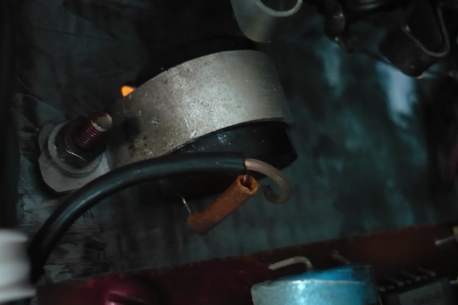

I want to replace all the caps around the opamp to be sure, but i don't know the types.
The yellow ones are polyester caps, the blue ones are electrolytic caps of course and there's one tantalum cap.
But I don't know what kind of cap those big white ones are. Same problem for the 'Arco' cap and the '3400 J' cap.

Hi! First an update on my project:
My Elka is working okay now, the preamp IC was indeed faulty. Unfortunately, the amp does not sound very good. It is also very noisy. The speakers are good, the leslie spin effect is good, but the amplifier itself isn't very linear. This probably has something to do with old caps and components (FETs) in the first stages, but the amp is also very old and an early solid state amp. This one came from an era where proper PNP output transistors didn't exist or were very expensive?
I don't think i will get it to sound as clear as a new Hifi amp. So i'm thinking to build a passive crossover and connect a new Yamaha amp to it.

Inside my pedal, there are not a lot of different components. You've got 2 switches for the belt motor (Motor on/off, Fast/Slow) and one switch for the reverb, and some (variable) resistors. I think your Elka doesn't have a reverb, so you can ignore that one.
The motor on/off switch, is a simple DPDT (double pole) switch. One half of it acts as a switch that cuts the power to the belt motor.
HOWEVER, the other half of the switch activates a special electronic circuit that 'emulates' the rotating drum for the woofer (there is no mechanically rotating drum for the woofer). In my amp, this circuit is quite complicated. Please note, the major part of this circuit is located inside the amplifier cabinet. Something wrong in the pedal, might damage something inside the amplifier too. The circuit consists of 2 analog oscillating circuits, they control the bias voltage of an array of FETs (transistors) that are preamplifing the audio signal for the woofers.
One oscillating circuit runs at slow speed, the other one has a higher frequency. This is where the 'Fast/Slow' DPDT switch comes in: one half of this switch is able to switch between both oscillating circuits, thus switching between the emulation of the drum spinning at high or low speed.
This is the electronic 'emulating' speed circuit. You can see it in this picture, in the bottom center. It is the largest print on the picture. The small wires on it come from the pedal. http://i892.photobucket.com/albums/ac125/OlivierS/P1050494.jpg
This effect is only audible through the low frequencies (woofer), it sounds like some kind of vibrato. If something is wrong in this circuit, it only affects the bass frequencies (unless you've got a short circuit - then, the fuse will blow).
I have posted the schematic of this circuit, but it is complicated (look on the other page of this topic).
The other half of the Fast/Slow and Motor on/off switches, are used for adjusting power supplied to the belt motor. This one is also quite complicated... The motor current is controlled by two large 2N3035 transistors (one for each speed, they are also located inside the amplifier cabinet). The transistors are connected to the motor. The fast/slow speed is achieved by controlling the bias voltage on these two transistors. The variable resistors in the pedal can adjust these preset fast/slow voltages.
This is a picture of the circuit in the amp cabinet. The two large transistors are mounted on the outside of the chassis, you can see the pins coming through. Please note the black cable with all the small brightly coloured wires. These wires come from the pedal.
http://i892.photobucket.com/albums/ac125/OlivierS/P1050495.jpg
If something is wrong with this circuit, it CANNOT affect the amplifier (both tweeter and woofer). Even if there is a short circuit, because this circuit has its own fuses.
This circuit wasn't broken in my amp, so i didn't need to draw a schematic for it and (i'm sorry for you), i'm not gonna do it, because i need to unsolder a big bunch of wires to be able to reach it.

I'll be honest, the power amp circuit is nothing special, and is indeed from the bad old days of solid state. If this was me, I'd probably be inclined to forget repairing it, but gut it and build my own in there.
The important parts for the "sound" are the preamp, Leslie simulator, and the speakers themselves. You could build these with modern parts without too much hassle at all. The power transformer and the heatsinks could be reused, along with the casing. There's three power amps in there - two woofers and the tweeter ? Probably not neccesary nowadays.
You are completely correct. However, I'm gonna try it with my external hifi-amp first. I just need to build a crossover and that takes less time.
