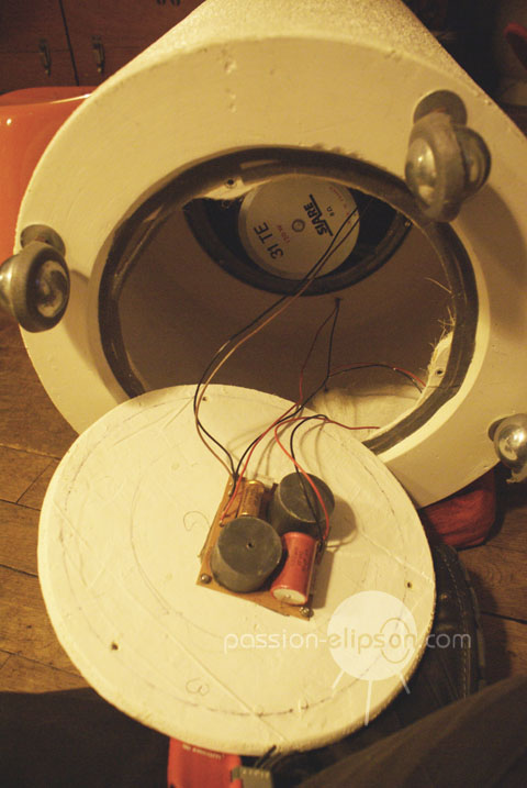

Do you mean Elipson - Siare 31 TE instead of "21 cm (8") Audax" 😕

No the siare 31 te is 30 cm wich would'nt fit as the ouside measurement of the 1303 is 30 x 30 cm and about 106 cm high.
