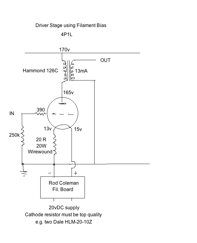

The best way to do this in the driver stage - and what I've done myself - is to use a DHT in filament bias. This requires some knowledge, but isn't complex though it does require a DC filament supply to each DHT. You'd have to change your amp - add stuff and make an additional hole for a second tube in the driver stage.
My driver stage is a 4P1L (mu=10) which would give you about the gain you desire. I run it into a Hammond 126C interstage but a 126B may be better. Cathode resistor is 20 ohms so no need to bypass. 165v on the plate, 15v supply to the filaments in filament bias, so this feeds the filament and cathode resistor in series and the resistor sets the bias.

Going back to filament bias - I think this is the "free lunch". No input cap that you'd have with battery grid bias, and a cathode resistor that doesn't need to be bypassed. I'd prefer the sound of a good 20 ohm wirewound resistor (needs to be as good as possible - I use 20W DALE surplus stock off ebay). I've compared all these options - including LEDs etc in the cathode - and to my ears a properly executed filament bias is my preferred sound.
It's unconventional and there are only a few tubes you can use comfortably at lower voltages but these include the 26 and 4P1L, which is enough for me. Basically for a driver stage you need a bias voltage of up to 15v and a low filament voltage ( 26 = 1.5v, 4P1L = 2.1v) to get away with a supply voltage of around 20-24v into a filament board such as Rod Coleman's. For a preamp, you can use a supply of as little as 12v and a bias voltage of more like 4-5v. Easy stuff - I've even used a standard DC 12v mains supply! Choke input is even better - the supply really needs to be uber-clean. But satisfy these conditions, and in my view you have your "free lunch".

You asked for a picture of the 4P1L in filament bias, and here's a roughly drawn one for you!
I haven't tried the 126B. That's rated 30mA, but only 44H inductance. 126C is rated 15mA and 105H. For a driver stage the 4P1L could be run at around 20mA or even up to 25mA.

Ammended version - the 4P1L is used in triode mode with grids 2+3 connected to plate (pins 2+3+4). Filaments are wired in parallel (1+7 and 8)
