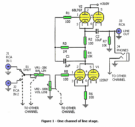

I'm cleaning up the wiring in my "Brute Force" linestage to get rid of some hum (built with 6SN7 instead of 12SN7). In the process I started looking at the heater elevation - I have separate heater windings, one for the 6SN7s and one for the 6BL7s, is it necessary to elevate the heaters for the 6SN7s in this case? Or can I just make a "virtual ground" for this winding with a pair of 180R resistors? Right now all heaters are referenced to 100V.

The bottom 6sn7 will live fine with filaments close to zero. A 250-500 ohm pot
with the viper grounded will allow some hum-cancelling adjustments.
The top ones ought to be close to the cathodes of the top 6bl7's
The best result in my experience, is to take a second heater winding in the traffo, and refer it near the cathode voltage, but not couple directly to it, otherwise all traffo intra-capacitances will be in parallel to the output. So, taking from the cathode a 100KΩ resistor, decoupling it with, say, 1µF @ 250V to ground will place the wright DC voltage but no AC signal in the filaments.

It turns out that most of the hum came from one of the 6SN7s. When I switched them over the hum appeared in the other channel. Also, the heater wiring was too close to the signal input wiring and I guess that contributed a bit. I’ve rerouted the heaters and changed the inputs to shielded cable instead of twisted wires and it got a lot better now. I have another set of 6SN7s I’m going to try out.
For the heater elevation I ended up using a 220k/100k divider from B+, bypassed with a 33uF cap to ground.

Showdown, how did you come up with those resistor values? 100 ohm in the cathodes and
10k in the anode of the bottom triodes? Also, why the 10k resistor at the ac-output when it
could be put to good use feeding some additional current to the 6BL7 cathodes?

I was just wondering why on earth one would want 100ohm in the cathodes, wich would give just 1V Ug at 10mA and squander 100V on the anode when having only 310V Ub.

My suggestion:
to be able to feed the heaters of both tubes from the same transformer winding
make sure that the upper cathode stays well below 200Vdc and elevate the transformer winding halfway.
6SN7(per section):
Double Ugk by increasing Rk from 200ohm to 680ohm.
Reduce the Ra voltage-loss and increase Ua/k of both tubes by reducing R4 from 20k to 10k.
6BL7(per section):
Increase Ug by increasing Rk from 200ohm to 330ohm
that should increase Ua/k to at least 120V to be safe regarding h/k voltage.
Increase Ia to 12-14mA by connecting a 22-27k resistor between grid/cathode-resistor junction and neg. supply.
Take the output from this same junction (or from the cathode with a 100-220ohm serial resistor to the cap).
Reduce the waste in the 10kohm resistor connected to the output (increase to 100k or more)
Reduce Rg to 1000k and reduce Cg to 0,047-0,1uF.
Unless you want to drive loads lower than 10kohm 1 section per tube will do.

I've done some measurements now:
I have 430V on the last reservoir cap and B+ is 339V after the regulator.
V1 - heaters referenced to ground:
plate/anode: 120V
cathode: 1.6V
That should mean that each section is drawing 8mA?
V2 - heaters referenced to 100V (should probably be more):
plate/anode: 339V
cathode: 287V

Ok, my suggestion wont work for you any better than what you allready have (except for h/k voltage stress).
A related, but different circuit would be better.
What is the impedance of your phones?
What is the current limit your ps can provide?
How much voltage amplification do you really need (needed input sensitivity)?
Do you have to use a 6SN7 and 6BL7 or can you choose any tube you want?
