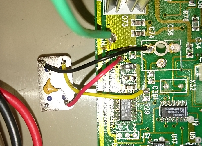

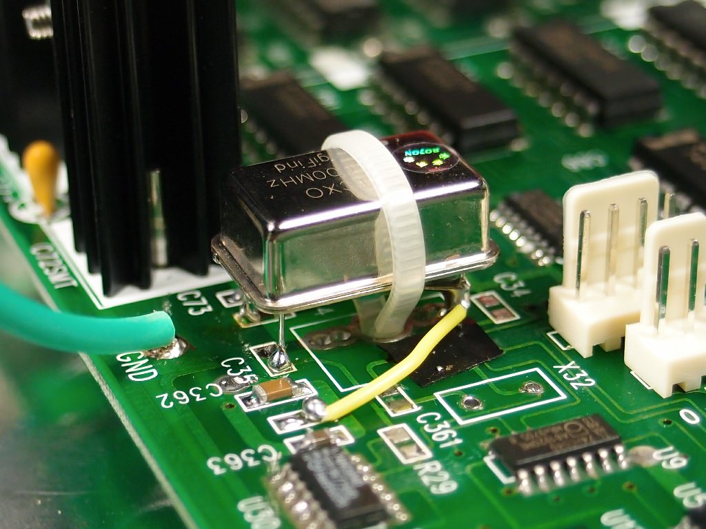

To mount the new TCXO I first removed the old timebase components - X32, R29, C34, C35, C36 and C361. The crystal and trimmer are thru-hole and have to be unsoldered from the board bottom which is easy to get to. Prior to mounting the TCXO I soldered a 0.047 uF decoupling capacitor between pins 7 and 14, about halfway up the can leads.
TCXO pin 8 solders to the C35 pad that goes to the R29 pad and then pin 13 of the 74HCU04 (U30). Pin 7 goes to the ground side of surface mount capacitor next to C73. Pin 14 touches the board near a via hole so I first insulated it with a bit of electrical tape on the board. Then I ran a wire from the pin to the +5V pad between C362 and C363. Finally to secure the TCXO I ran a thin cable-tie through the C36 trimmer hole, around the TCXO and back down the hole. See the photo.
I am very happy with the modification. Now after the counter powers up I get an instant reading of 10.000000 from a rubidium standard. The only down-side to this project is that the F-1300 has been discontinued by Elenco. You will occasionally see one for sale on eBay but I have not discovered any other source. But if you are able to obtain one, perhaps this mod will prove useful.

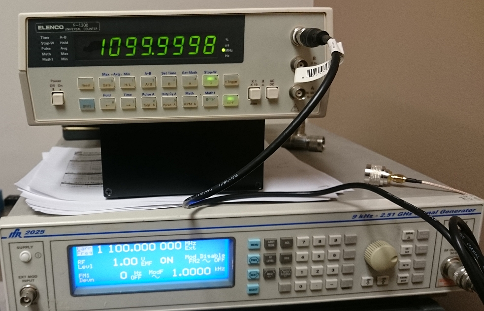

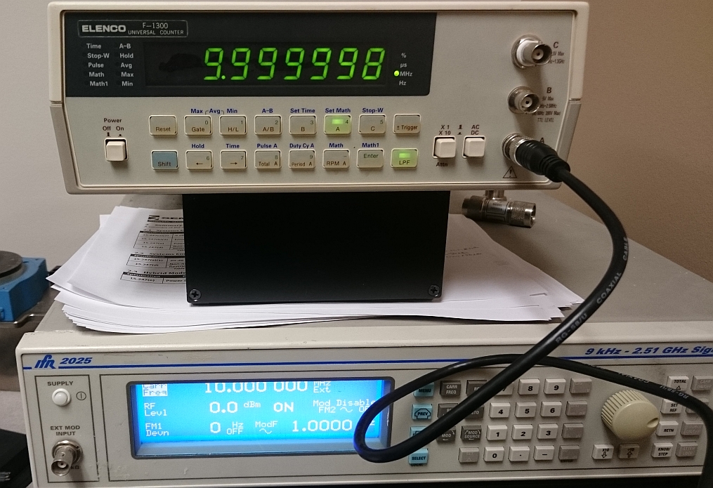

Thanks for the post! I too have an old Elenco F-1300 and wanted better accuracy than the XO provides. I bought a high accuracy (claimed 0.1ppm, actual ~0.2ppm) TCXO on eBay for $10. I mounted the TCXO to the enclosure deadbug style with hot glue and followed your directions and voila...a much more accurate counter! If I were doing this again, I'd add an SPDT switch and external BNC connector to the back panel, and use some thin coax to give the counter a switchable internal TCXO/external reference so I could use it with a lab standard.
The only caveat for others considering this counter is that the F-1300 only has 7+1 digits of resolution so at 10MHz, you have 1Hz resolution (0.1ppm) and if you are looking at VHF/UHF frequencies, your resolution is 100Hz. That said, the gate is pretty quick and with the TCXO, the counter is reasonably accurate too.
If you're doing the mod: 1) Disconnect power!!! 2) unscrew the 4 screws in the black feet at the bottom 3) Lift top cover off (the back panel sits in the enclosure and can remain attached to the PCB) 4) use hot-air to remove the parts specified in the OP 5) Install the TCXO as shown and hot-glue in place. 5) reassembled and test!
