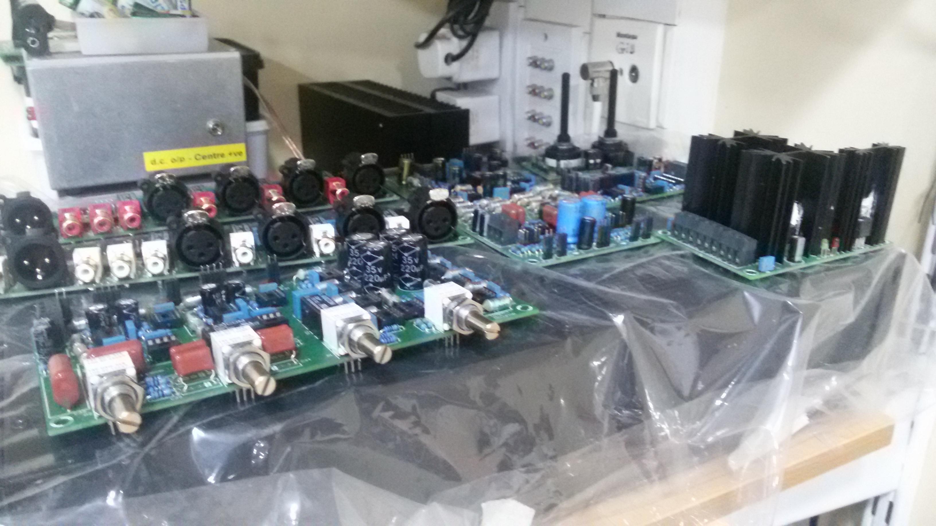

Getting ready to put together.
Just stuck on how to be able to drill the holes for the Input PCB (x2) and also for the Front Panel PCB.

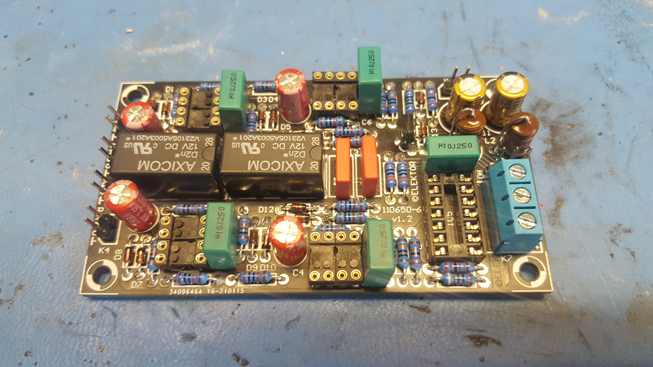

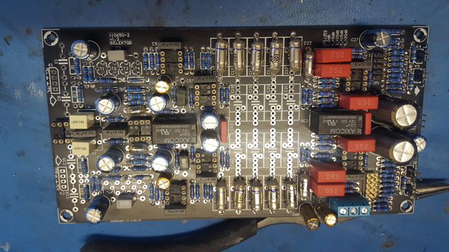

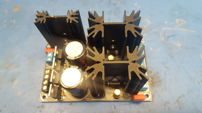

The transistors for the phono pre are no longer made. The 15pF polystyrene caps, FSC 160V 15PF+/-1PF, were just discontinued by LCR Components. I think I got the last few before someone bought out remaining inventory. Also, the 4700pF polystyrene is on back order until June from Newark. I had to find a different source to complete my build and I just got them in on Monday from U.K. I also found I had to order different .1uF decoupling caps, as the ones I initially ordered were too large for the footprint.
I still have to wire the interconnects, mount the ICs and transistors, and solder the polystyrenes that just came in.

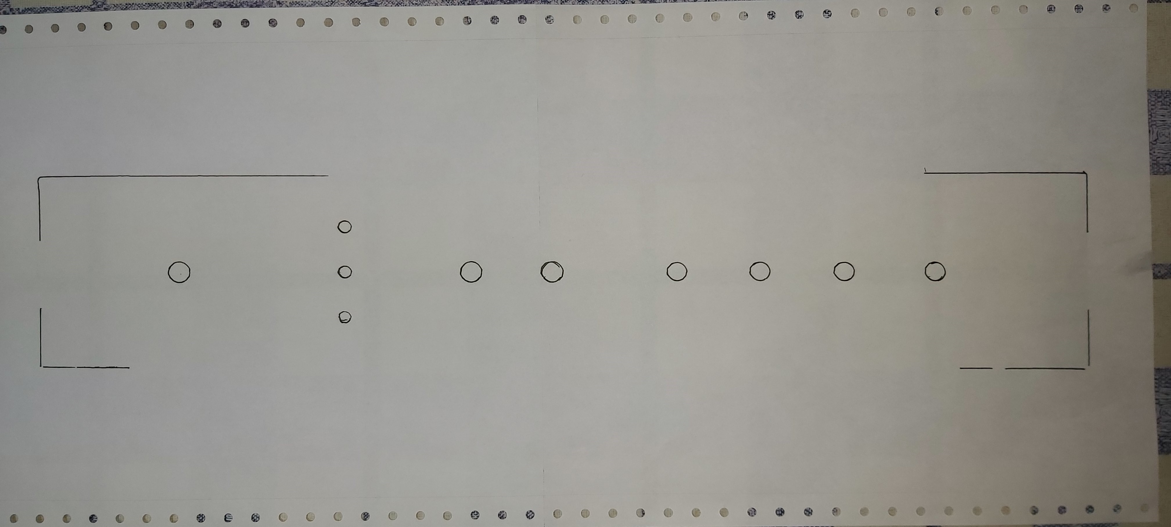

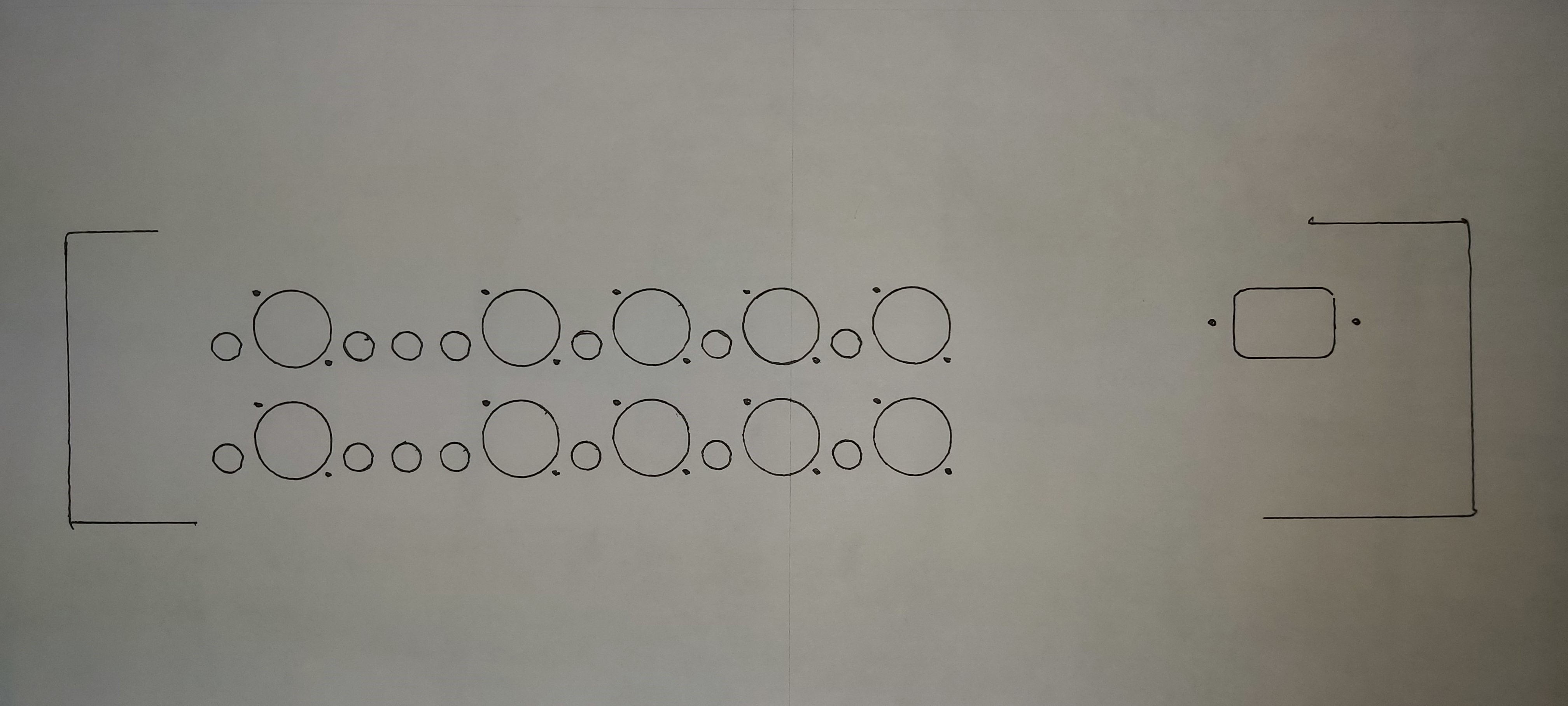

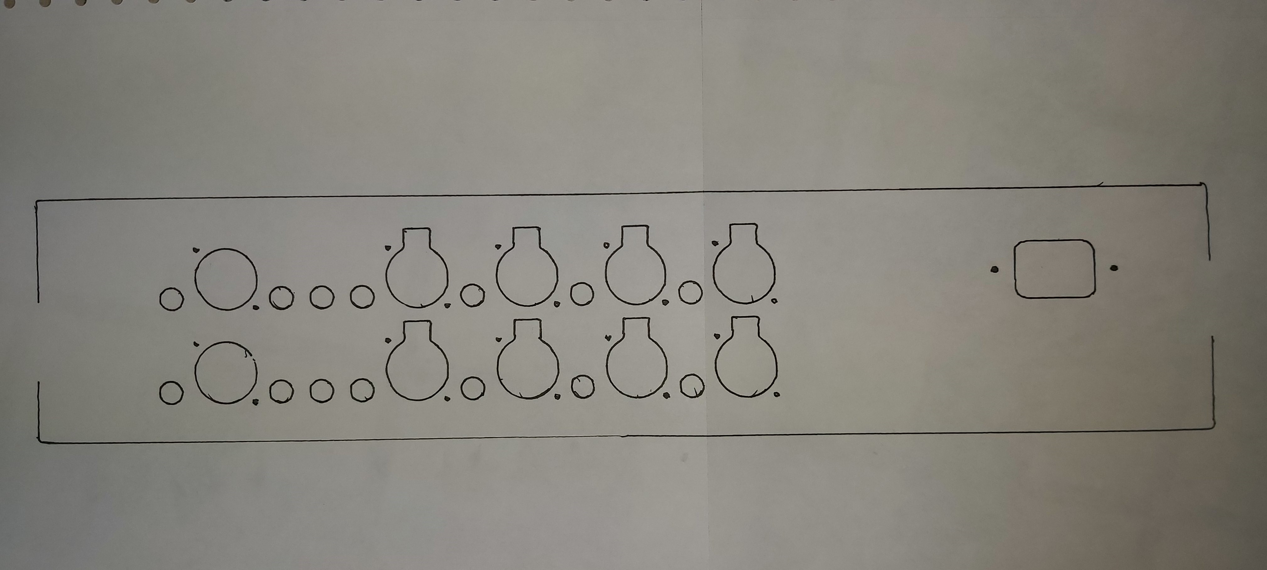

Templates & Case
I used the case from R.S. Components for my build going back a few years (see attachment).
Based on this case, i have attached a couple of templates for those that might need it.
In Part 3 of the Elektor article, on page 23, you will see the image of the Preamplifier’s input board (here at 75% of its real size).
Two of these are required for stereo operation.
