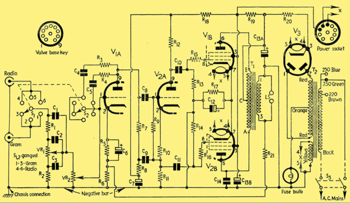

Hello everyone,
What can I use instead of the EF86 used in the tube amplifier in the attached diagram by making small changes. I have lamps such as 6n1, 6n2, ECC82, 12AT7, ECC83.

If you are usig a modern source the gain from the EL86 is excess and it can just be removed.
A CCS at the bnottom of the long tail pair. Abd ECC81 (12AT7) can be substituted for the ECC83, its transfer curve is nicely in opposition the the EL84 and you get a more linear vtransfer curve.
Have a look at Elin Dutton’s El Cheapo for an evolution of this circuit.
We built an EL84 triode Class A variation thatrivels my nSIT-3 — but onlyoutputs 3.2 w at clipping.

No, you can't use a 12AT7 without modification. This is a high-feedback amplifier, so ANY changes you make, including the output transformer, will require significant changes in the design. There really is no point building a design that you don't have the tubes or the proper transformers for. There are plenty of PP EL84 projects out there, like the one Steve links to.

There is no gain stage in the first schema, so although you don't need all the gain of the EF86, I think you would need some. The EL84 looks to need about 20V peak to peak for max output. The ECC83 is a LTP phase splitter, so about unity gain. Your source is likely line level, about 2V peak to peak, so you would need 10x gain with no feedback, more with feedback.
This could be a candidate for an alternative solution: Useful PP Amplifier. The phase splitter is a concertina, so the other half of the triode would be giving you the gain you need. It is a design for an ECL86, but the triode part is like half an ECC83, so the passive components should be similar, and the pentode part you can keep from your original design (but anyway the ECL86 pentode is similar but lower power).

But this version has MUCH less gain; 57x closed loop gain for the OP's Elektor 8R version. This is almost perfect for a Red Book CD player (2V at FS) via a 10k log pot passive preamp. This is true for the original Mullard 5-20 too.
Also the Elektor uses the EF86 in triode mode. This is nearly the same as half an ECC83 so that's my answer if you want to keep to the 'original' circuit. Check the anode voltages of the ECC83 phase splitter aren't changed too much.

You're right, in the original schematic in this thread, there is an EF86 pentode wired in triode, direct-coupled to an ECC83 (12AX7) long-tailed pair. While you can't simply remove the EF86 and use the rest of the design (the ECC83 would not be biased correctly if you do that) you can make a push-pull EL84 amp using nothing more than a 12AX7 and a pair of EL84s.

Actually, the gain of a 12AX7 LTP should be about half the gain of the same triode configured as a common cathode amplifier. You'd probably get about 25X gain from each triode's plate. This is how Eli Duttman's El Cheapo PP 6V6-oid amplifier was designed, except using a 12AT7 instead of a 12AX7. That could easily be adapted to EL84 output tubes.
You can also use a 12AX7 (or 12AT7) as a 'cathodyne' or a common cathode amplifier coupled to a 'split load' phase splitter. The Tubelab Simple PP design uses this type of design. That would give you more gain and is probably easier to get right than a push-pull amp design using an LTP input stage.

EF86 is in triode mode, take a look, so the gain of that stage is not huge.
the problem is high impedance source of the driver stage with ecc83 and in the other sch ecc81
EF86 in triode mode has probably about 6 x gain
Use ecc82 for the driver stage or some double triode with lower Ri as ecc82.

You need only 4 x gain from input for max power.
I suggest to use 1:5 step up transformer followed with ECC82 as the buffer and driver for EL84.
in the same time this transformer is a phase splitter...
Without feedback.
Instead of the triode connected EF86 you can use one half of the ecc82; Cathode R becomes 2k2. If possible vary ths resistor to get 60v at its anode. But even when it isn't exactly 60v the amp will work just fine.
