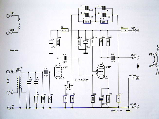

Lots of similar and better circuits all over the net . I would rather avoid this one as the designer was clearly not into serious hifi - just have a look at the silly coulpling cap values - and elcos!
And, ha, ha, a coupling cap after the transformer. What a moron!
Mmmm
Yes, the input cap is weird.

ECL86 RIAA Preamp
Can you share some links to these ECL86 RIAA preamps.
No, i have never noticed ECL86 preamps and see little reason one should force this tube for phono.
ECC83 is probably not the best sounding tube but is widely available and easy to use. I still have warm memories of Marantz 7C phono section and the link to 'Ohashi' or AR SP-3 presents a very similar circuit. Thanks to the CF and NFB output impedance is low and one can feed a pot/power amp directly.
EAR834 seems like another very good choice
I have allready constructed a line preamplifier using ECL-86.Designed by the same author(Experience).
I was so disappointed by the results,that I had to disassemble the device at once,althow I had used high quality parts.
Neither ECL-86,either the designing approach of the author is so audiophile(f.e. in my case,they sugested a center tap of 12.6V which feeds the two fillamentes in series).
And the gain of the pentode section is totally useles.
Not to mention that this tube is available from Mullard and Chinese manufacturers.I don't know if you could get some pair NOS from Telefunken.
It is not my intention to judge others works(tut mir leid) but they must improve their design.

Grrr! 😡 I've should have made this question before buying the parts from Experience Electronics. I'll build it anyway, just for fun, and then I will go to try planet10's circuit. Thanks Dave! 🙂
pingfloid said:Grrr! 😡 I've should have made this question before buying the parts from Experience Electronics. I'll build it anyway, just for fun
Potentially most of the parts (except OPTs) for a nice little SE power amp -- or without OPTs for a headphone amp.
I take no credit for the design except the drawing (& the scan in the other thread). RCA had this pretty much sorted out when i was still in diapers.
dave
Have made the math for planet 10´s circuit. The 22k in the Riaa network must be a 24K to get a correct 318 uS. 2 * 12 K in series will do.
