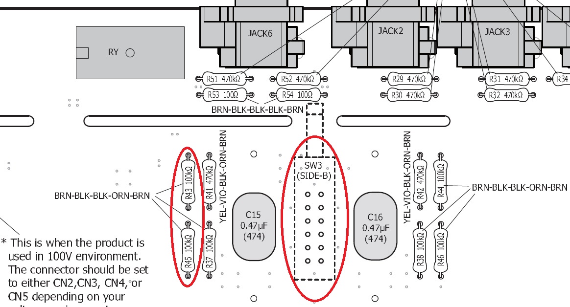

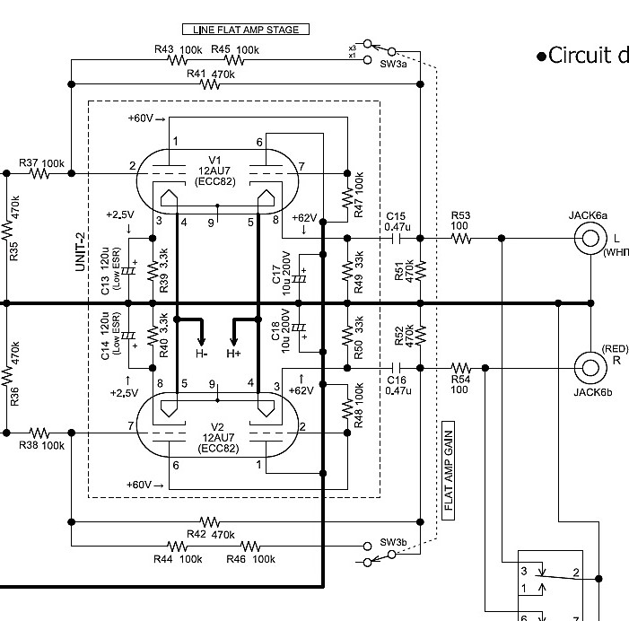

The flat gain switch is giving me odd behavior. When changing to 1x gain it seems like
only one channel, the right, is going to the lower gain while the left says at the same level.
I'd use an ohm meter on the unpowered unit, to check the switch and related components.
There are two of these push button switches. I tried to see what each of the poles did with my meter but wasn't able to see anything that made sense. Looking at the schematic it isn't clear how the poles control what on the board is switched on and off.
Ding ding ding! We have a winner!
Bad solder joint. I found one but re-flowed all on the output.

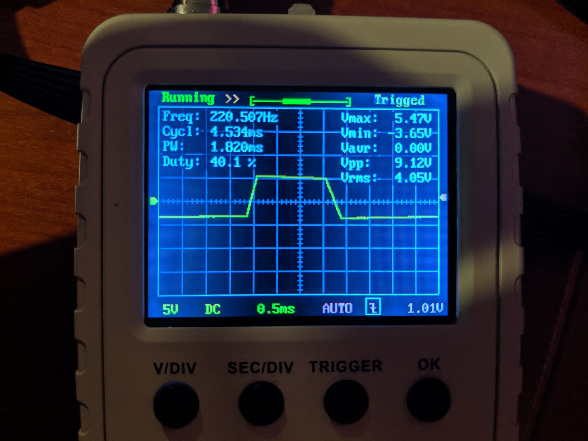

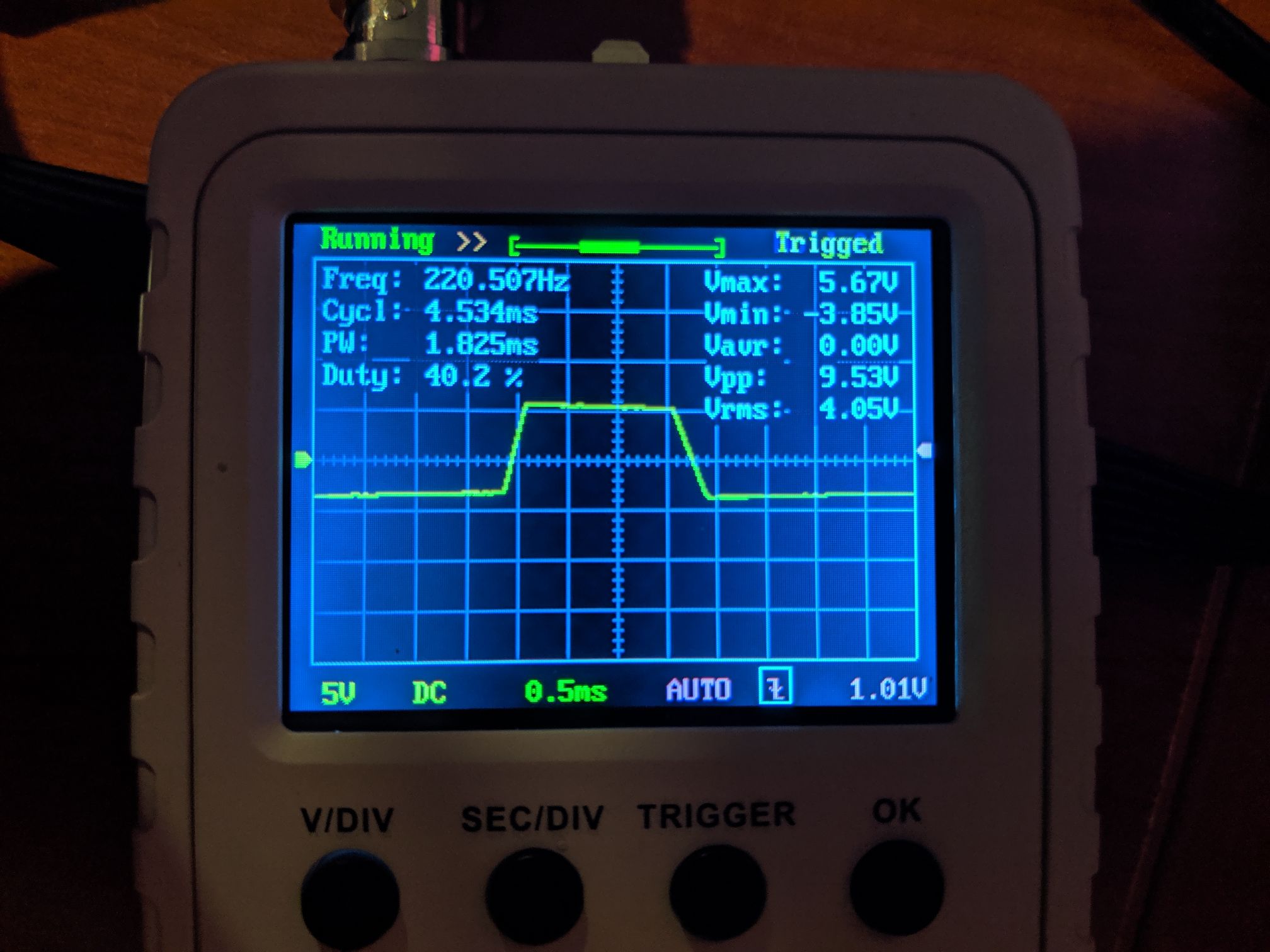

I hooked up a signal generator and a oscilloscope to the preamp on one of the line inputs and the phone input. Attached is the left and right channel outputs. I don't recall which channel is which. I assume it's not a standard curve because of the RIAA equalization. Is there enough difference to warrant checking further?

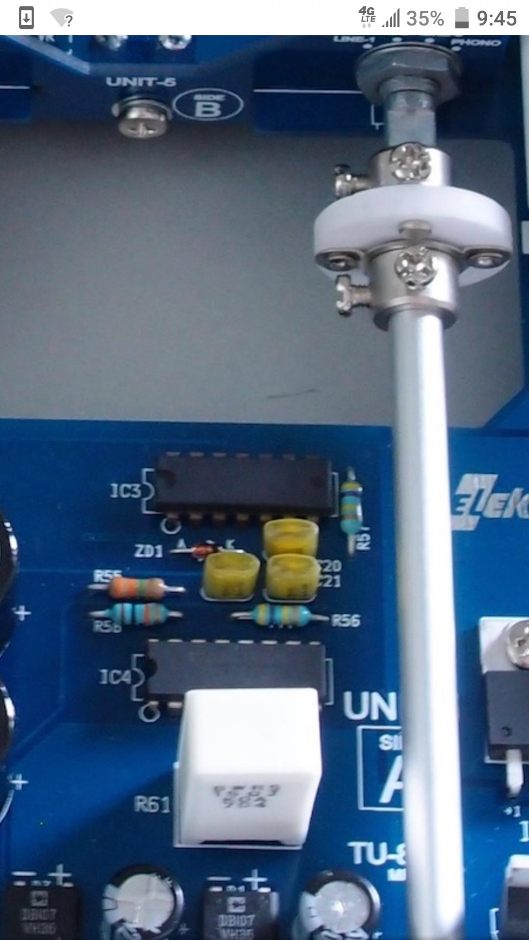

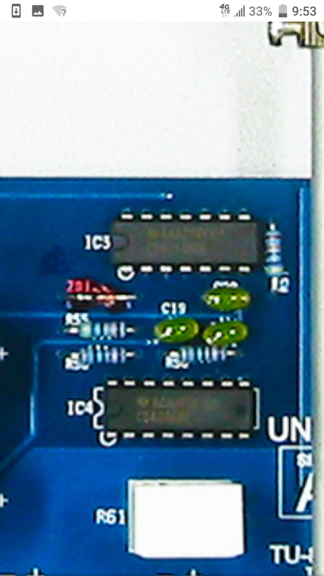

Check what you installed for R55 and R56.
If you go by the Japanese schematic you get R55=3.3M and R56=470k.
If you go by the English instructions, you get R55=470k and R56=10k. ��
I'm in the process of the build myself and still unsure which R55, R56 values are actually correct (although my guess is that the original Japanese schematic is more likely correct)
I zoomed in on completed build photos of the TU-8500 online and found that unfortunately half the people are building them with incorrect resistance for R55 and R56 and are not aware.

R55 and R56 just set the mute relay delay, so not critical as long as the delay is long enough to mute power on transients.
