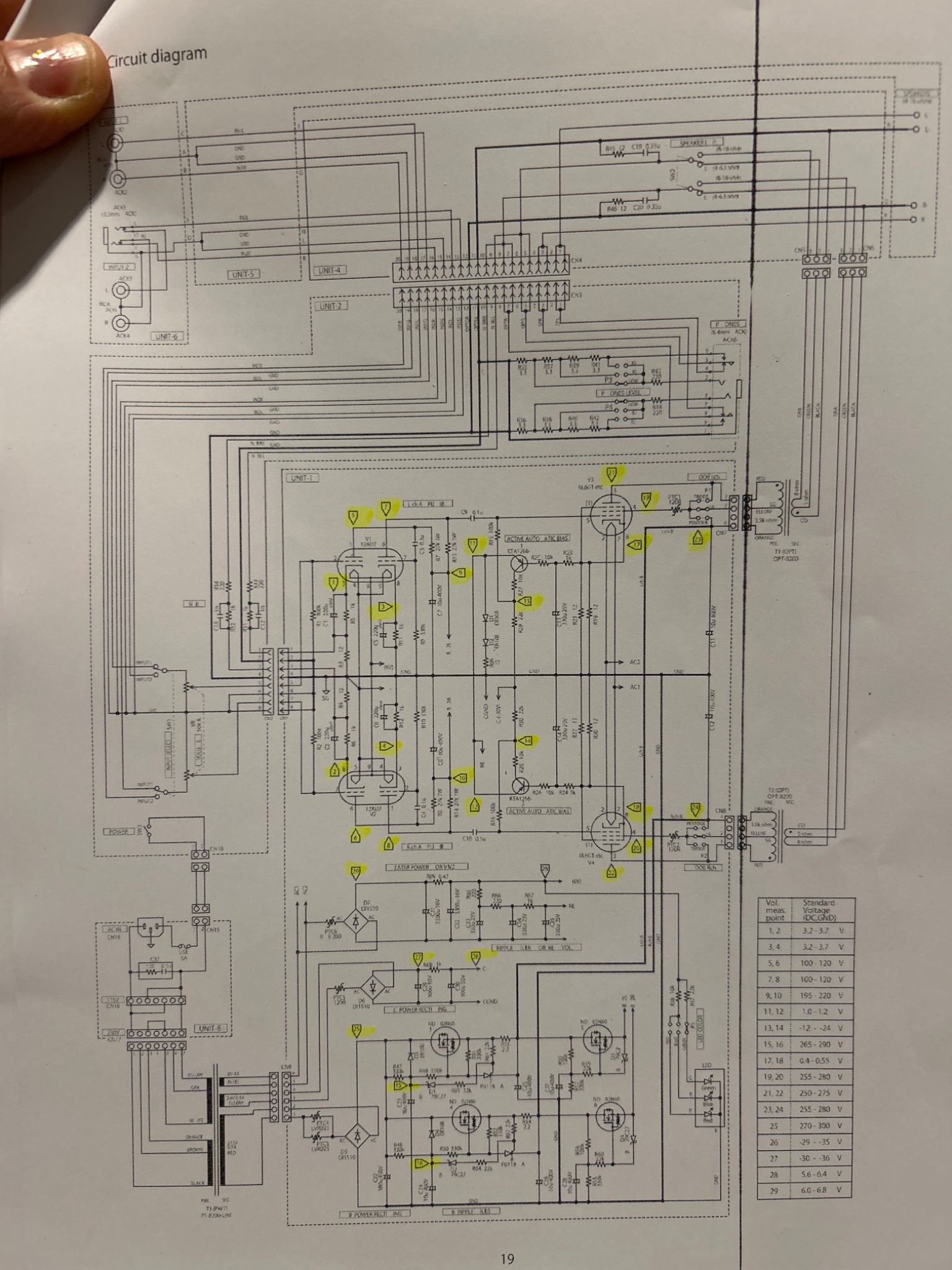

Hi all!
I’ve had an Elekit TU-8200R for about three years and it’s run beautifully.
Recently a crackle started in one channel that wasn’t addressed by swapping out the speaker, cables, or tubes.
On voltage testing I’ve found that test point 2 = 1.6V (3.2-3.7) and point 6 = 52V (100-120V) Everything else tests normally.
I don’t have the electronics knowledge to know what to do with this.
Any help would be really appreciated!
when you have the new tubes please send me the new tests points
if you have uncontrolable low level hum it is the FET issue.
Thanks again for your help. The tubes don’t change the test voltage levels. What do you think I should try next?
