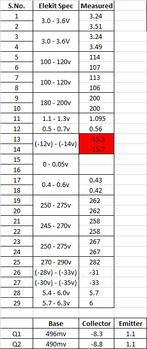

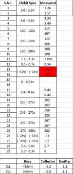

Any in particular I should check. All voltages as per the build guide seem to match as I posted here.
I saw an old post with transistor measurements and when I checked mine, found the difference. Have managed a pair of the A1015, should I go ahead and replace ? Here's the voltages I measured on Q1 & Q2.
Q1 - Base (496mv) | Collector (-8.3v) | Emitter (1.1v)
Q2 - Base (490mv) | Collector (-8.8v) | Emitter (1.1v)

These values look perfectly fine.
