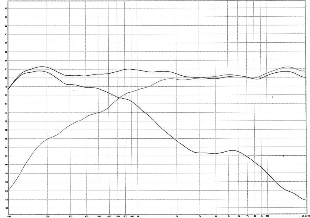

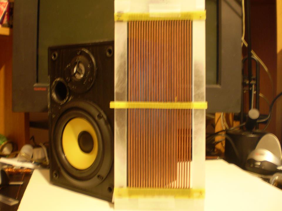

I was using a D/S of about .072" and I have increased this somewhat on my newer version for better room for Diaphragm movement in the 200Hz to 300Hz range.

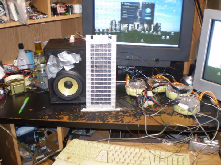

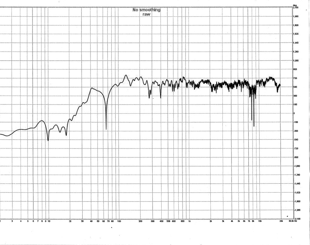

The photo is of my latest untested version (that I had made two years ago), designed to meet the above requirements and push the bias level even higher toward 10Kv-13.5Kv.

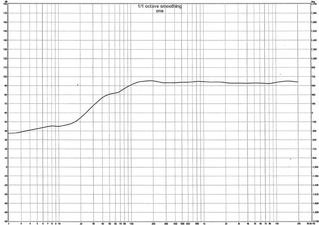

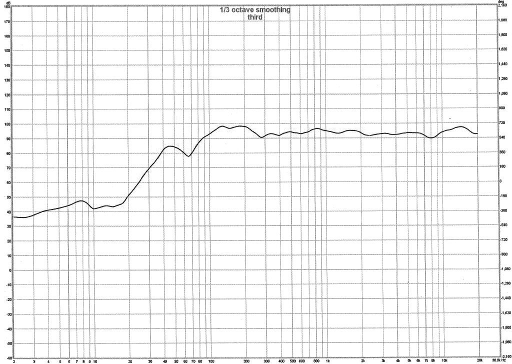

The next set of photos are of my test panel as described in the threads and the calibrated measurements of it the very day I pushed it to far and it finally gave up for good.
It really wasn't designed to be pushed as far as I did it, but it was a trooper to work well enough to do it several times and allow me to finally get some solid data.
The measurement were set at 95db and at a 10v peak signal into a 1:160 transformation ratio and i think my normal 6.8kv of bias. 🙂
Running the bias up to 8.5Kv-10 Kv range yeilded me another 3-4 db of efficiency with no change in the drive level.
I ran them at 10Kv for quite a while on this last test, But it was pushing the integrity of my stator coating until their final ultimate demise. 🙁
The efficiency of this setup at 6.8KV was measured at about 89-91db with a 5v peak signal feeding the step up transformers.
There was slight 3db peak slope in the otherwise flat response curve that accounts for the 91db and is probably some sort of room reflection of my test setup when I did the test.
Those conditions where refined for the calibrated curve as shown and the 89db for a 5Vpeak corresponds to the 95db level for a 10v peak input using a sine wave test tone.

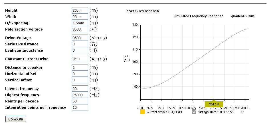

If we target a 110 dB SPL to around what ever is needed to cross over with a good 4" to 6" mid-bass driver. How small can we make the electrostatic speaker, and still require no more than 30 W to drive it and about the same power to drive the bass. I assume we will go active.
If 110dB @ 1m is truly the requirement you would need a 23cm diameter ESL to cross over in the 2kHz - 3kHz range. If you can move the crossover a little higher (or lower your SPL requirement) you could manage with a 17cm diameter ESL. The output capability increases +6dB for every doubling of panel area.
Just to clarify, these area and SPL numbers are for a dipole ESL panel.
You can calculate them for yourself at this site:
Electrostatic Loudspeaker (ESL) Simulator
With typical 1.5mm D/S spacing, use 3500V polarizing voltage and 3500Vrms Drive voltage to get a good estimate of peak output capability for an ESL. Change dimensions and distance to see effect on SPL.
More details on using the ESL calculator here:
http://www.diyaudio.com/forums/planars-exotics/258958-help-esl-simulator.html#post3988441
Attachment #2 of this post shows how to get a flat response using a series resistor:
http://www.diyaudio.com/forums/planars-exotics/258958-help-esl-simulator.html#post3989632

In reality it took about 100watts to get 110DB with a 6.8Kv bias.
My as measured efficiency was 89db for a 5V peak signal (close enough to 4Vpeak for a 1 watt reference).
So for 100 watts=20db 20+89=109db !!
And then for everytime you double a voltage it means +6db of more SPL.
Doubling of the bias is the easiest.
So if I can run a 14Kv bias than it would only take 50 watts at 20v peak to get to 110db or so.
I did this a couple of times but my stator coating was starting to fail at anything above 12Kv.
I was running a 8.5Kv bias and about 50v peak input when it happened (burned for the last time).
Anyhow 10.2Kv of bias gave me approximately +3db more so now my efficiency is now 91db as measured.
So from 5v to 40v (for a 100watt amp) this is a doubling of the voltage of three times for a +18db.
Therefore 18+91=109db as measured with my SPL meter in my test at 1 meter from the panel.
