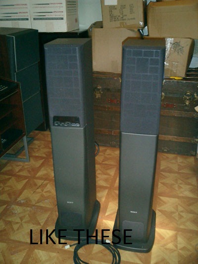

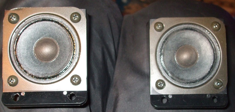

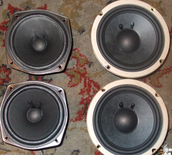

I had some large (and I mean tall) Sony home component speakers. I love the way the vocals sound. Took them out and they are 4ohm via tester. How can I tell how many vocal watts these can handle? Before I buy new components I am going to try these in there as the cabinents got ruined due to basement flooding... Pretaining to crossover points how can one determine what these were originally crossed at? I love the vocals they produce. I know I am cheap, disabled and cant work anymore 🙁.. So I try stupid stuff like this to keep my mind busy

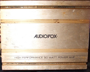

Just re-reading your post. Guess I could always use mono for bass, kac-927 for the fronts, the small one I pictured for the tweets as a starting point, then later add an additional amp directly to the HU for the rear fill as the rear speakers are cheap dual that light up and are more for show anyways. Would this be optimal setup till I get a new head unit? Could always sell them together (HU & crossover) to add towards the cost of a better radio. Just went crossover because I dont want to get stuck with certain radios that have crossovers strictly.... Anyways thanks for all of your brilliant responses, I know in the future to ask here before I spend money. Although I did repair my mono block so that saved on costs 🙂

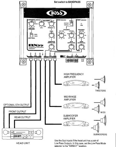

I found this one which appears to have a bandpass filter like these radio have
http://www.amazon.com/BX55-Electronic-Crossover-Subwoofer-Control/dp/B0002VMT24
Should I get this one instead? I post because I dont want to order it like i Did the last one, and it be lacking something. I am sure I can always sell the original one online or ebay as it is new.. But will this do everything the builtin ones on the radio do?
was doing some researh! couldnt I set the crossover I purchased to act as a low pass, and the amps internal to act as a high pass thus creating a bandpass for my mids? or vice versa? then connect the sub, and tweets to the crossover, thus triamping? or would I have better chances with the one I posted above?
Downloaded the manual for that boss crossover this is exactly what I want to accomplish. Can someone confirm? Also all the radio's I looked at have set filters, None have the old school variable settings. Then again I could be wrong. If I went this configuration, Then that only leaves rears and I could always add a small amp to give small amount of full rear sound, possibly even using the full comming out of the headunit correct?

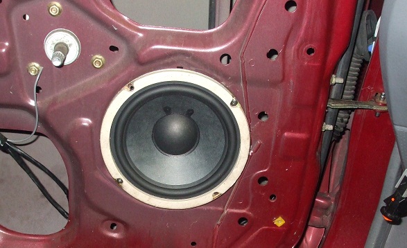

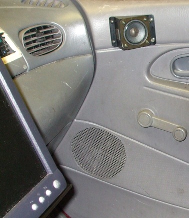

Well I Installed them today. They dont sound that bad.. I still need help on my above question of the crossover so I dont blow these.. Anyone?
Also added a utube video of the install if anyone is actually curious how these sound. Might take a while 4 video to be processed by utube
