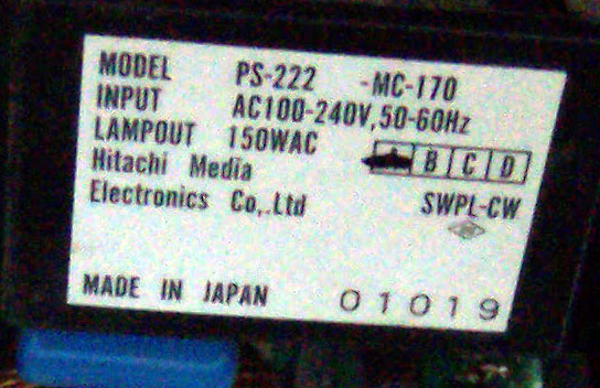

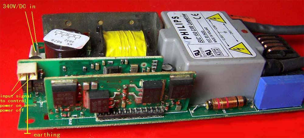

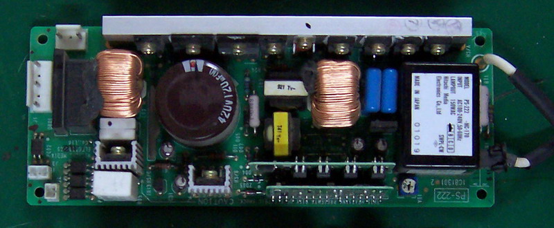

I have some ballasts, like this:
do you have some oic of your ballast?
is it?
is shp lamp?
