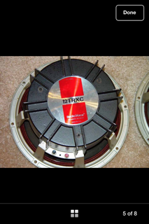

I just purchased a pair of EV 12TRXC 8ohms at ebay, and would like to build the enclosure. I studied about this speaker and find out that “it is integrated 3 way speaker”- http://www.electrovoice.com/downloadfile.php?i=970305 but some other documentation says it is two way full range speaker-http://hf-antenna.com/Flotsam/EV/How_to-build_a-EV-spkr_system.pdf
1. Can anyone tell me which definition is right?
Also there are two inputs in this unit – looks like one for tweeter the other for woofer,, but I am not sure how to hook it up to utilize both inputs.
2. Can anyone upload a diagram?

Really? I only recall one set of exposed power terminals.

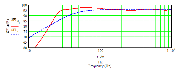

Anyway, the 1st sim is the 20 ft^3 example based on a 38” seated ear height, 0.75” [19 mm] material thickness, all dims i.d. and approximate:
H = 60”
W X D [CSA] = 576”^2 [suggest a golden ratio 30.5” x 18.875”]
Vent = 9” dia. [or 3” x 21.25” slot] x 0.75” baffle thickness
driver up 37.25”
Vent up 6.75”

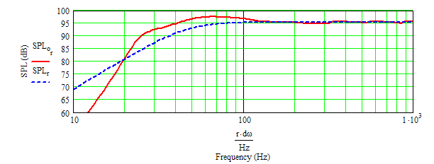

The 2nd sim is the ~12.667 ft^3 reduced footprint version, which of course has much less low bass, though may be sufficient in room:
H = 60”
W X D [CSA] = 364.81”^2 [suggest a golden ratio 24.31” x 15”]
Vent = 6” dia. [or 1.375” x 20.56” slot] x 0.75” baffle thickness
driver up 37.25”
Vent up 6.75”

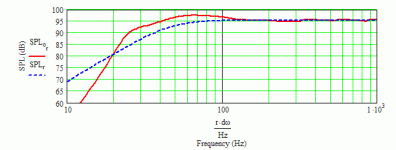

OK, final design:
H = 60”
W X D [CSA] = 432”^2 [suggest a golden ratio 26.43” x 16.375”]
Vent = [3] 4” dia. [or 1.875” x 20.125” slot] x 0.75” baffle thickness
driver up 37.25”
Vent up 6.75”
Damp to ‘taste’. FWIW, I prefer 1” acoustic fiberglass insulation on the top, one side and back down to 40” and add more down further and even its floor if need be to quell if there’s any in-room bass ‘boom’.
