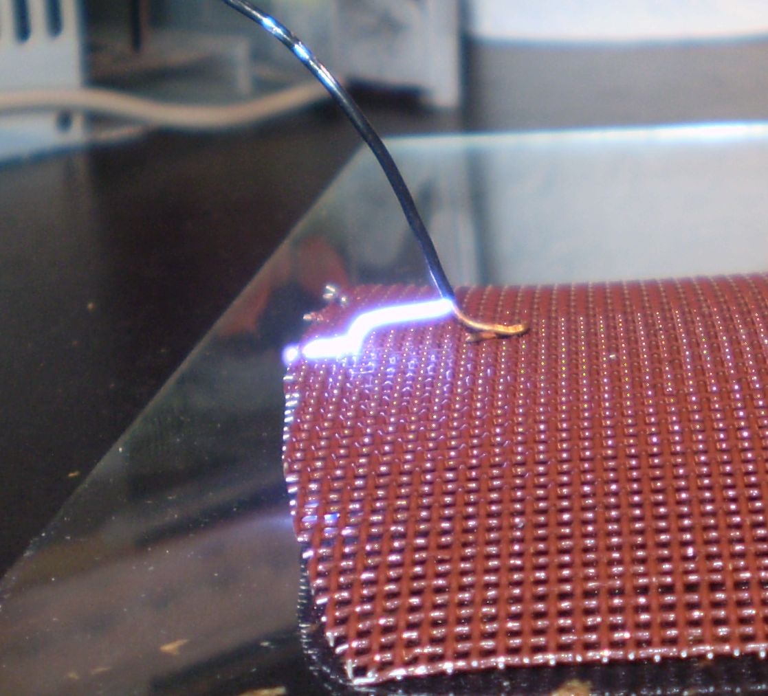

When you select your hole size you also have to consider the build up thickness of your coating .030" dia. is definitly way to small in that manner.
Typically 5/64" to 1/4 has been used by most as that is what is available.
Powder coating can give you a nice base to start with, But getting a consistant coating that doesn't have any micro cracks can be a bit of a challenge.
I had this problem when I had my window screen stators Powder coat, then about 7 years later they started to develop cracks and chips.
I was able to reseal them with some clear acyrlic spray paint.
Also getting your coater to get a thick enough coating may be an issue as well not to mention double and triple coating them.
My coater could only do a doulbe coat for me and refused to do a triple coat for what ever reason.
Powder coating worked great if it is done right the first time but if it is not, experimentation can be costly and very time consuming.
Your best bet is to use the porpe paint trcks I have outlined in another thread.
As WrineX has pointed out sharp edges are your worst enemy, just one sharp edge on my Experimental PC stator was the cause of there final demise of being badly burned.
Once this happens it is nearly impossible to repair them and hold back the voltages needed to get great high performance out of an ESL.
Transformer voltages can swing as high as +/- 10KV or more and with a bias of up to 7Kv or so.
I was one able to get as high as 25Kv Peak to Peak but I had never reached that again after the First Time they failed!!
I got tired of trying to fix them using more coats of clear acyrlic and sealling the bad spots with clear finger nail polish with teflon, SO I just let them burn for the last time and decided to make a new set that could handle the voltages.

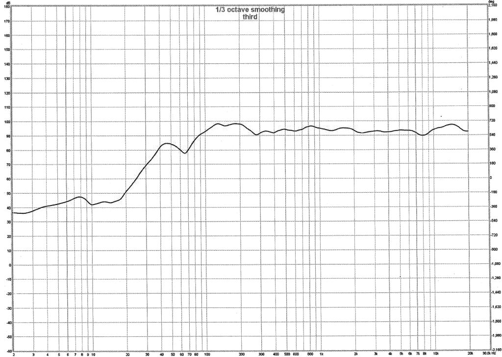

I was able to get great results considering my quite small hole size and my open area was estimated to be about 35%-38% for my first painted models or so, but a bit higher to about 45% if I recall with the PC coated ones.
I liked the sound of the PC ones due to that they had increased open area, but both models were incredible do to the nature of ESL's .
Folowing the advice I gave in the thread that I posted, I was able to get a very high performace coating that rivaled my PC coated stators and was much easier to construct.

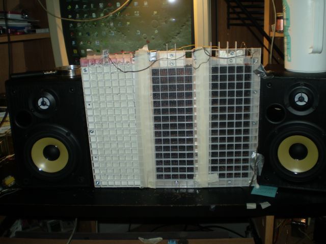

If you are looking to build a Full range setup you may want to consider a electrically segmented design using TIG rod.
CharlieM and one other DIYer ( I forget the name at this time) has built such a panel using TIG rod and likes it much better than his original perforated metal panels.

P.S. Pictures are of 14KV arc coating tests and my original panels and the FR graph of them.
