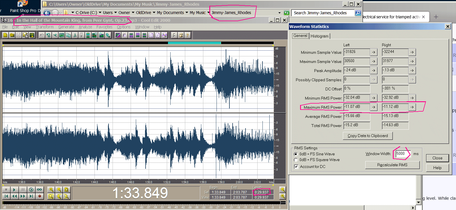

Someone has been pruning my music files. Nothing normal?? FWIW, the Dead's Feedback from Live Dead, normalized, has a passage at -8dB RMS over 50mS. But I can't stay in the room with that track on today's weak drugs.
James Rhodes Live in Brighton, In the Hall of the Mountain King, last 30 seconds "becomes increasingly loud and frenetic." James Rhodes is a rocker of classic piano.
As my well-pump shows, you can't melt a line fuse (much less line wire) in anything like 50mS (my analyst's default). In fact power wires at mild overload will hold-in for minutes. Fuses for the purpose will hold for many minutes at twice rated current (and we used to test this curve with 2 to 3 tea-pots in adjacent offices).
So I scanned for max RMS over 5 seconds. The value seems to be -11.1dB or 0.28 of voltage, 0.078 (8%) of power. 0dB @ 3100W, this is 240 Watts. Under 270W including class D losses.

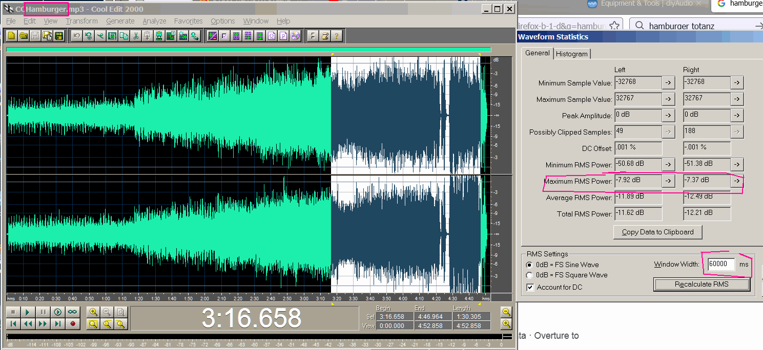

Ah-ha. I thought I had stuff more interesting than piano. Here is Hamburger Totentanz, an oddly compelling work for pipe organ, on a sweet little organ in a stone church and a very simple recording rig. IIRC, zero limiting, I only normalized-out my safety margin. (Even clipped a bit, I see; I bet my working WAV was clean and the MP3 process put a few peaks over.)
Whether 50mS or 60,000mS (a minute, let the heat build), the max RMS runs -7dB. Which is 640 Watts on your rig.

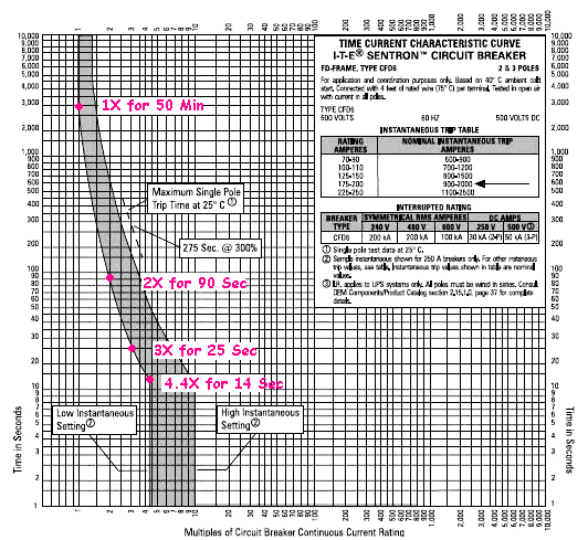

A common residential circuit breaker is rated for 3 hour continuous current. It can handle 10 times that current for a good fraction of a second.
So unless you are running long full volume test tones, a single circuit can handle several big power amps playing music or movies.
But it may require turning the big amps on, one at a time.
I'm not finding time-current curves for my residential breakers.common residential circuit breaker is
I find a plot for 70A-250A molded breakers, and the wide range suggests that smaller models will be similar, they just don't publish them.
These breakers are "adjustable" for short-term overload. Yes, 10X overload for 10 seconds or 4.4X for 14 seconds, engineer's choice.
3X for 25 to 150 seconds. 2X for 90 to 600 seconds. These are very long musical crescendos.

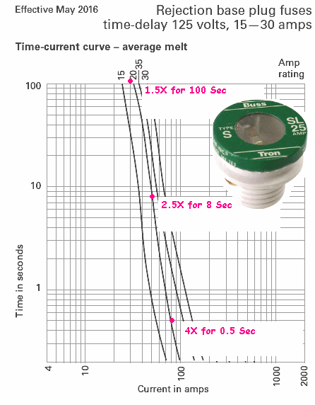

Since I did not find actual data for 15A-20A domestic breakers I turned back the clock to fuses. Although widely frowned-upon by insurance, I still have fuses in the garage. That data (there's effectively only one brand) is easy to find.
These medium-duty fuses melt faster than the breakers. (The ST series holds longer for large long-hard-start motors; wood-chippers etc). 2X overload for 40 seconds, 4X overload for a half second (still longer than a rim-shot or piano attack). And correctly picked fuses are well-proven to be safe for even fragile domestic wiring. (Insurance distrust because classically you could use an up-size fuse or a penny to restore service; this particular part requires a permanent adapter for the design current.)
