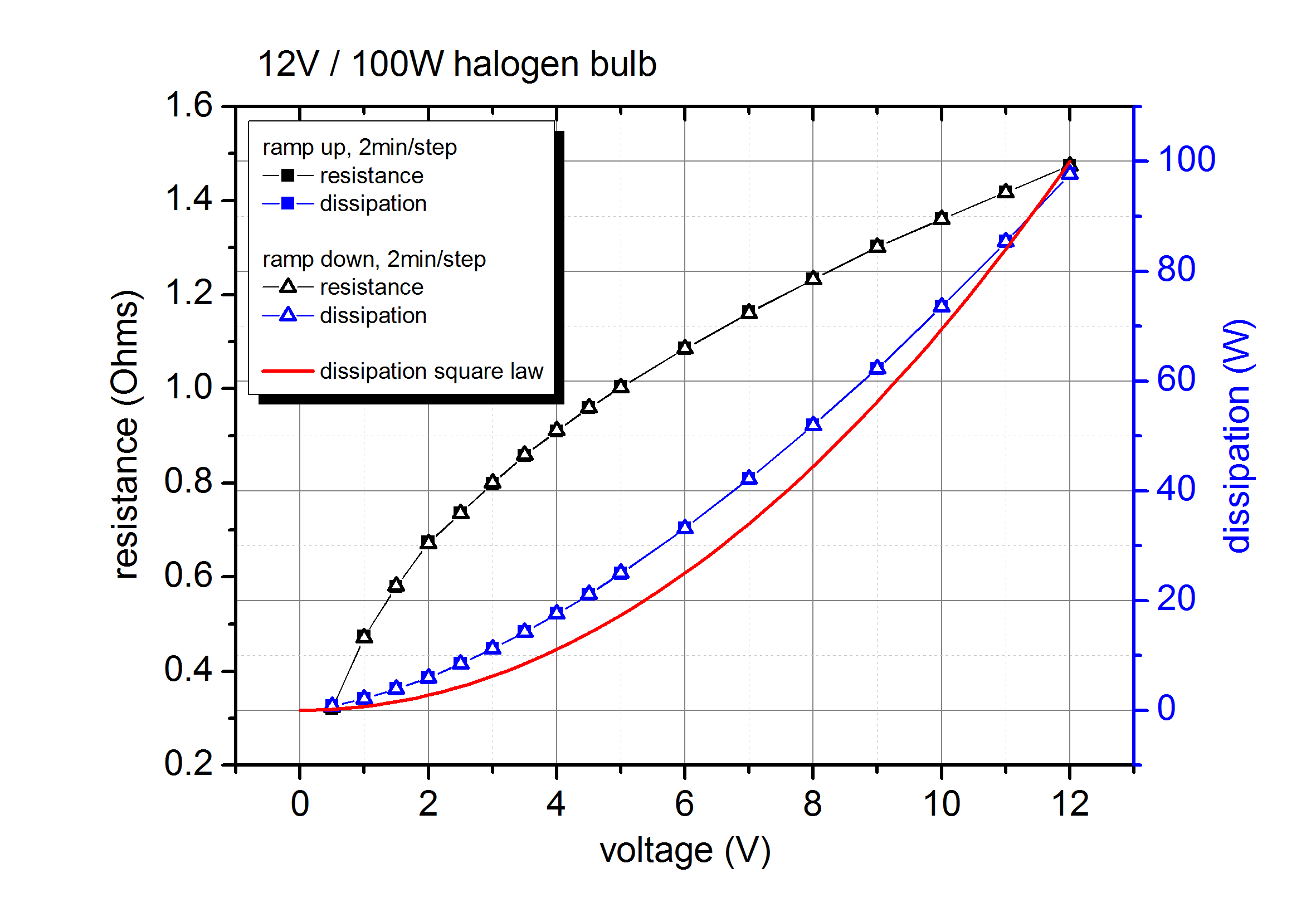

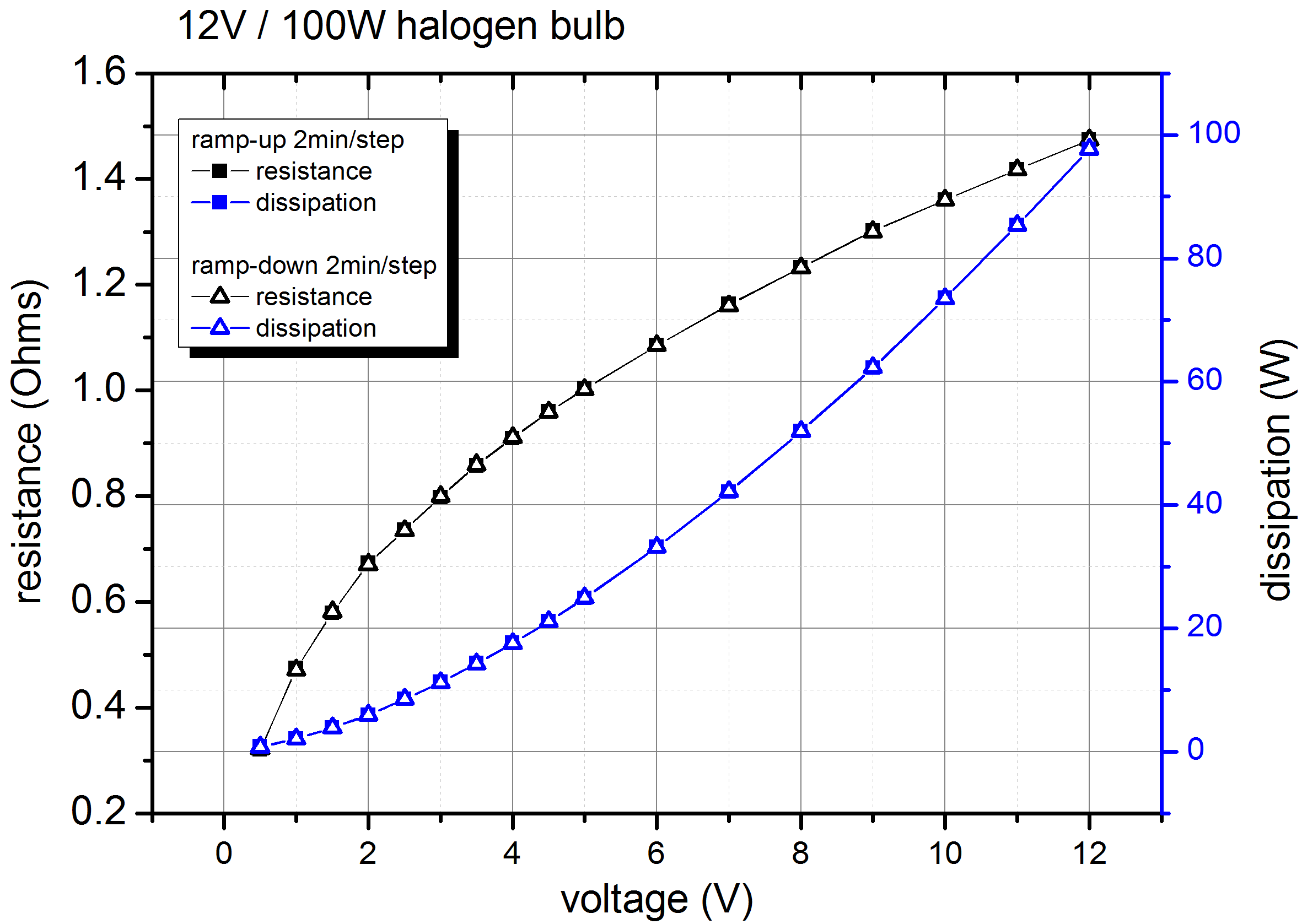

Well, never trust calculations if you can measure. So your 60+watts against my bet of slightly above 25watts 🙂
The data above were taken in my lab using a 12V/100W halogen bulb. You can see nicely that the resistance (black) is not constant due to the changing filament temperature. This leads to a dissipation that does not follow the theoretical square law, especially at low voltages.
But how large is the effect:
At 6V applied, the theoretical expectation for a constant resistance would be 25watts, real world says 33watts due to lower cold resistance.
The 60+watts dissipation you estimated require approx. 9V to be applied.
25watts vs. 33watts = 8w underestimation
33watts vs. 60+watts = 27+watts overestimation
Rundmaus won 😀😀😀

Hey,
did a nicer version of the figure, with the theoretical square law in it.
Andreas
Andreas
