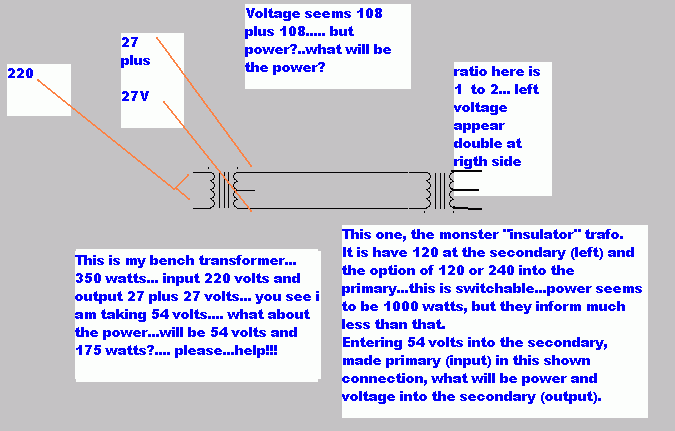

Well friends, i need your help.

I am thinking to use it in series with other transformers to have other voltages..but i have doubts about the power result.
Can you explain me the result of the image provided...the power expected?
Thank you in advance by the kindness to explain me that.

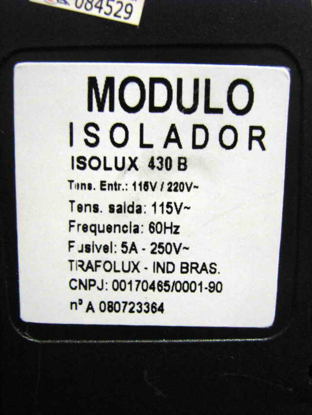

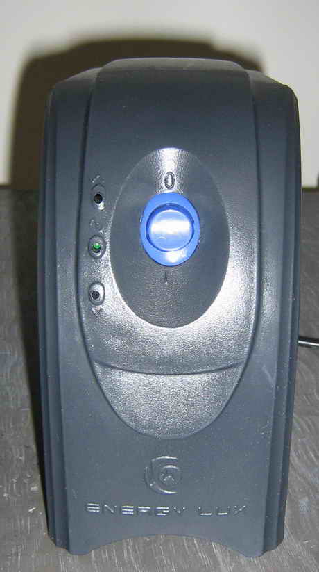

Transformer inside is huge... enormous type of transformer, traditional construction E plates and I plates trafo.
Secondary over the primary layers.
The size seems to be a 1.2 Kilowatt transformer...very big.
But specified as 300 VA..... and made sense to me when testing.... real power is not big.
Bad design i think...that iron could produce much more than 300 VA.

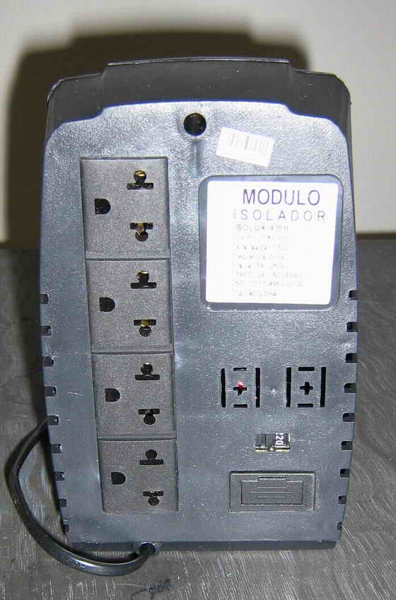

Well, the unit was made with the purpose to "create" a ground to you
And to protect your computer against main plug invertions...as the wall have two pins and the plug has three...people use to remove the ground and inject those two pins into the wall.
This produces some problems, i imagine, as one of those wall pins is 220 alternated (Live, Phase)...and the other is neutral (Zero, return)
The unit has 2 pins plug into the input and 3 pins into the output.
It could not feed power enougth to my Sempron 3 Megahertz together my power audio amplifier (class D) and my electron tube monitor, the conventional Samsung.
The supply could not keep the voltage stable enougth...had losses of voltage.
So...this "do nothing" thing will not be used into my computer.
I am trying to use it to audio...maybe... and needing informations about the power i will have...watch the sketch i have made showing two transformers and help me, please.

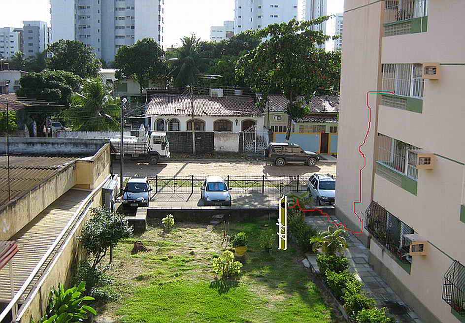

About earth, couldnt you just drive down a long metal rod into the ground and use as earth? hmm ;-) hehe
Yes Nikwall... switching supplies are better...but i have that monster to use
I do not want to make it as junk, to use as a feature to block my door against be shutted because of the wind...not as paper weigth too...ahahahahahaha
I can use the copper rod....but.... building rules, laws, agreements already made, do not let us run wires into the front of the building...nor the back, nor the sides.
So...i can have the rod..the ground..but not the connection to reach my appartment.
The electrical system has a small diameter tube to run another wire together the others already into a tigth space.
Well, my dear, this is third world...thing here are bureaucratic, bad constructed and agreements are very complicated.

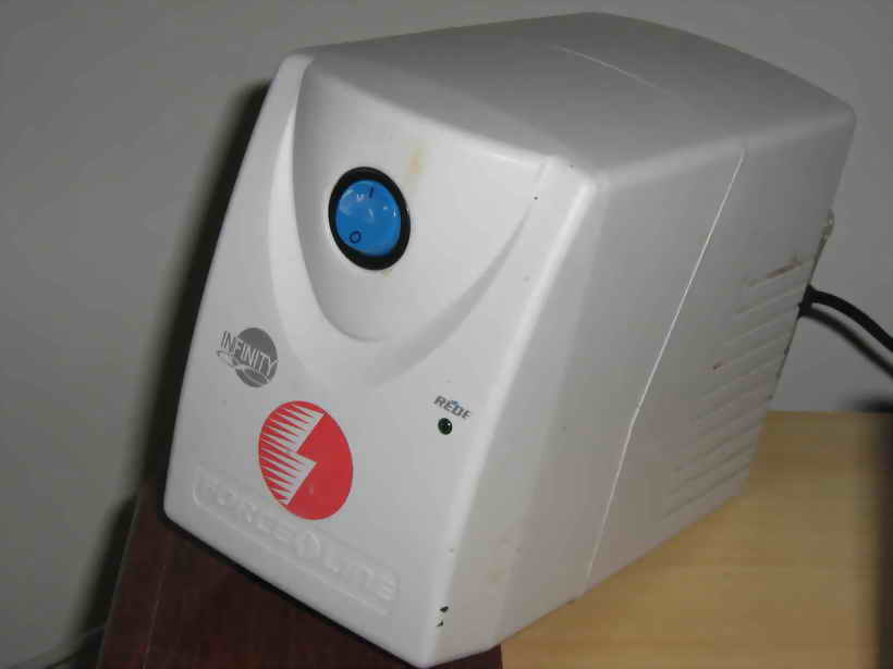

The autotransformer everybody uses here
Works fine...do not disturb too much, only the annoying click of the relays.
The one i use is a real 700 watts unit.
Of course the computer works fine without that thing, because the supply is a switching one and works better than those things.
Gimmick...do nothing...unobtanium.... but it is very cheap...that unit cost 20 dollares only!

Hey folks!.. i need the information... what will be the power
I will have connecting those transformers.
Watch the sketch and help, please!

Well Carlos I think that the power of the whole circuit is determined by the first transformer. No matter how big your second transformer will be, the first one is the bottleneck. So your overall power capability will be power of the first transformer. That's my point of view 😉
after: Conservation of energy rule

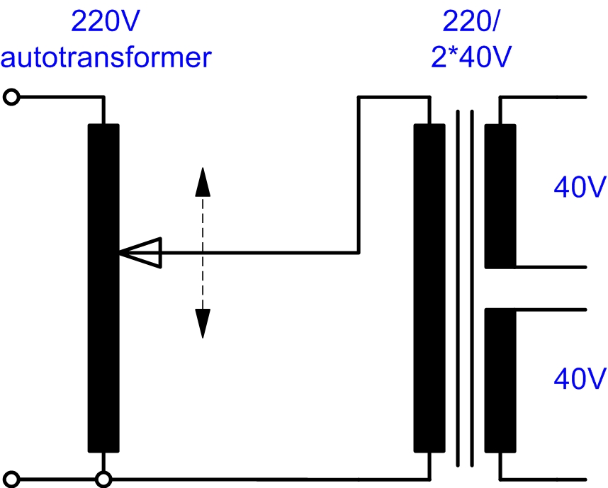

insulating transformers have a lot of losses because they need not to transfer everything from primary to secondary - that is why they do not transfer spikes in the mains supply and can be used as filters....this is not bad designing but designing for a purpose....so Carlos you have that low power on the secondary because you have a lot of losses in that thing...
i would not use that transformer for the purpose that you want and is specified in the mail no.1.....better option is to use rotary autotransformer that you can change the output voltage from that transformer and than to feed that output to your power transformer that you have ... and instead of using that one that has 2*27V you can use one that has for example 2*40V at the secondary and adjust the voltage to your needs on the autotransformer...like in the picture...

Hi D,
re that first post wiring diagram.
The first transformer gores from 220 to 54Vac when loaded to 350VA (~6.5A).
The second transformer when wired back to front gives 1:1 or 1:2.
If you feed full voltage into the secondary you will get full VA from the secondary. But if you feed 54Vac into the 120Vac secondary then the maximum output is roughly halved. If it started out as a 1000VA then you will have ~500VA as maximum throughput.
The power you can draw from the pair will be limited by the smaller VA i.e.350VA.
The voltage at the output will be 54Vac or 108Vac.
However, there is an alternative.
The 350VA transformer isolates the mains from the output.
It is safe to wire up the second transformer as a step up auto transformer. Feed the 54Vac into the ~8A, 120Vac secondary.
Wire one of the primaries (~4A 120Vac) in series with the secondary and you get double voltage out of the pair of windings.
Add the second primary and you will get triple the voltage out of the three windings in series. You now have three voltage tappings 54Vac, 108Vac and 162Vac, all at 350VA.
There are probably a few more ways to wire this arrangment up.
But, do keep at least one transformer as the mains isolation, it can be either the first or the second, the order does not matter.
