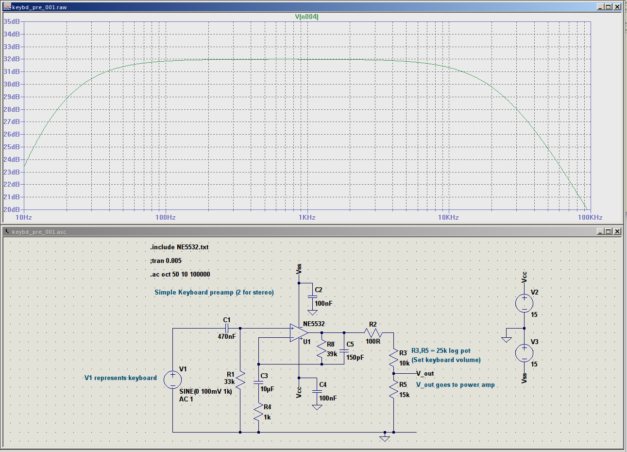

I've got an electric piano (Kawai MP11 to be exact) plugged into my hi-fi amp (Yamaha 7.1 home theater amp). The amp volume is usually set at -45 dB for other inputs. For the piano I have to crank it up to -15 dB.
Is there a simple stereo preamp circuit I could build and put between the piano and amp so that I wouldn't have to mess with the amp volume?

Okay, so you need a simple preamp with 30 dB of voltage gain.

A quick Google search didn't turn up anything that fit the bill, so I designed you one.
This is a very simple circuit, and it's all you need for this particular job. It uses a single NE5532 dual op-amp for both channels. I've set the voltage gain to 32 dB, and there is a volume control at the output that you can use to dial it down if it turns out to be a bit too much gain.
Frequency response covers the entire audio band, without the ridiculous excess typical of today's "audiophile" garbage. For this line level signal, noise performance should be excellent.
To keep noise and hum down, the circuit should be housed in a metal box that is connected to ground.
You need a clean +/- 15V DC power source for it, but that is a separate issue. There are a thousand schematics for a power supply like this on the 'Net, but these days I would probably just buy a couple of small, cheap, 15V switching power supplies, wire the outputs in series, and add an RC section to each power rail to filter out the remaining noise.
If you like re-purposing stuff, a lot of HP inkjet printers use a 0,+16,+32V power supply (with a flat, three-wire plug that goes to the printer.) If you can find one of these lying around the house or at a nearby thrift store, they make excellent op-amp power supplies: wire the +16V line as ground, the former 0V line is now (-16V), and the former +32V line is now +16V. Perfect. (Just add an RC filter to both +16V and -16V rails, something like 100 ohms and 220uF - 1000uF usually works well for me.)
By all means keep the volume control on this preamp at zero - as well as the volume on your Hi-Fi receiver - the first time you try it out. I'm still a bit leery of the supposedly very low output from your keyboard - if that turns out to be caused by a loose plug or something like that, and the keyboard suddenly spits out a volt of signal, this preamp circuit can spit out something over 25 volts peak-to-peak, and you do NOT want that to reach your Hi-Fi receiver input!

Thanks a lot. I also couldn't find anything to fit the bill by Googling.
Sounds good to me. I'll give it a go once I've sourced a suitable power supply. Thanks again.

For quick testing of circuits like this, I often just wire a pair of 9V flat batteries in series. These sorts of op-amp circuits will run just fine on +/- 9V instead of +/- 15V, the only difference is there will be less input headroom, and less maximum output level.
If you like the circuit and it performs for you, you probably will want to buy/build a real power supply, because those little 9V batteries don't last all that long, and it's one more thing you have to remember to power off.
Speaking of power, I forgot to include a power-on indicator in the circuit...I suggest a high-brightness green LED, and a series resistor to set current to roughly 0.1 mA. That's usually plenty bright with today's high-brightness LEDs (anything over 5000 mcd should do.)
We should definitely investigate Printer2's link - if your keyboard has a setting to switch it's output to line level, that might solve all your problems without needing a preamp of any kind.
Another possibility to consider is to buy a small, cheap analog mixer, and use that rather than a DIY build. It might be better-looking for the living room, and may end up costing less, and offering more flexibility and features.
