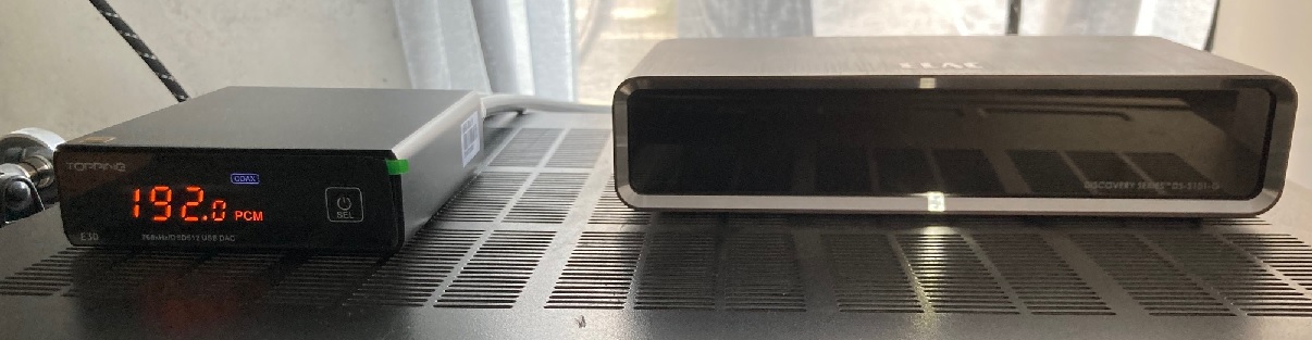

I’ve got one purchased in late ‘18 and it outputs 24/192 via coax when it’s fed it (at least according to my Yamaha reciever). I never tried the toslink.
It’s quite a capable little unit, good control app, good dac (CS4350/OPA2134).....I like it.
Proof.

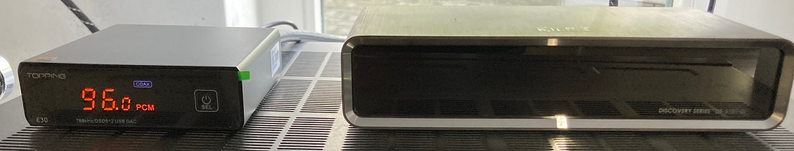

Found a new 2018 one and it was tested for me. It plays 24/96 without issues so I dare to assume 24/192 will work OK too. It will be delivered this week.
Still I think the support of Elac Germany regarding the first 2016/2017 series of devices is disappointing. After some feedback from other Elac Discovery owners I now know for sure that the first series play high res data but only at 24/48 which apparently is not noticed by the owners nor the reviewers 😀 Of course the fact that it simply plays music makes it somewhat harder to discover even though its own interface clearly shows what is happening. The issue is known but apparently only solved for customers in the USA.

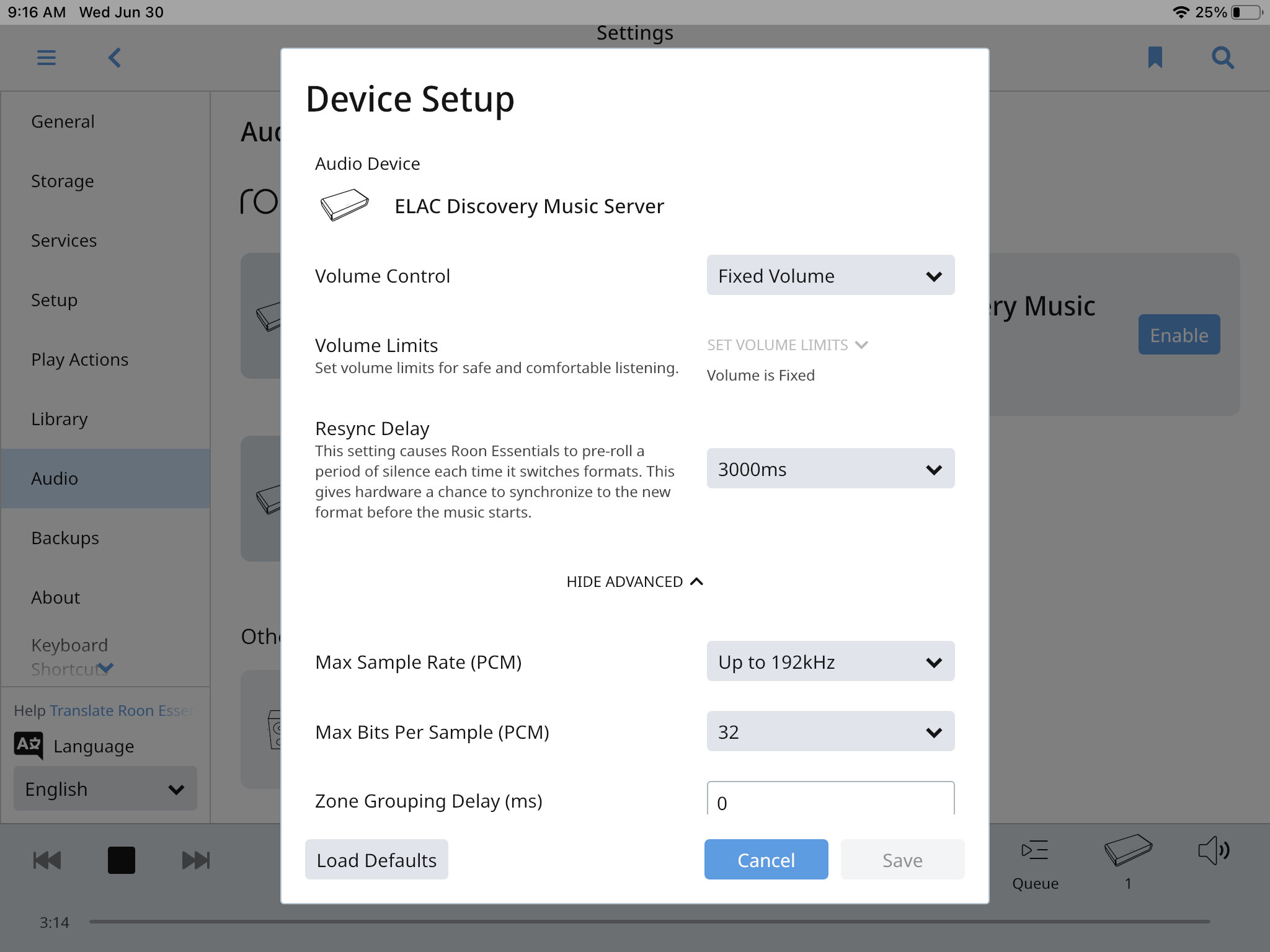

Hey jean-paul, glad you found one…….just to be sure you were aware of it, there is a sample rate selection in settings.

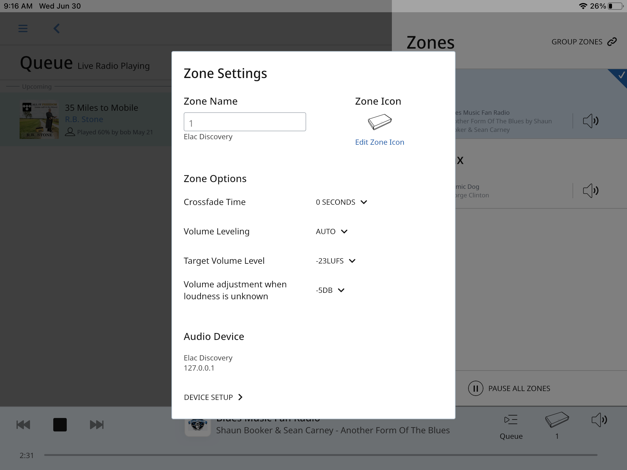

Another thing is the loudness leveling, it really helps while streaming because some albums have a significant difference between them, I find the SQ doesn’t suffer and it has selectable lufs level with default being -14
I find -23 to work best in my system…….you might want to play around with that.
