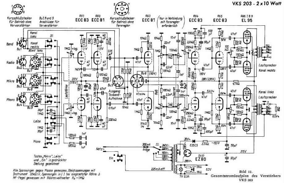

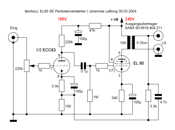

Here is a circuit for the el95 se
I have this in my archive, I hope it helps...

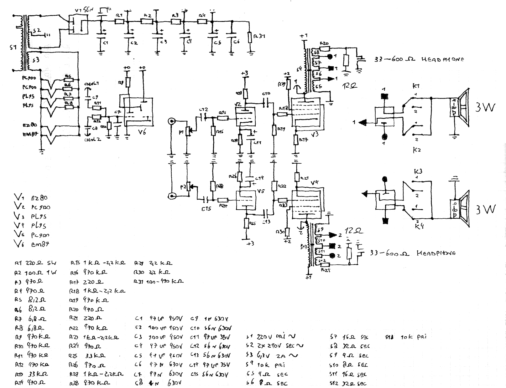

Hello
These is similar like my little Philips amp was. A bit over crowded and abot 2W.

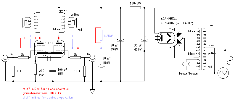

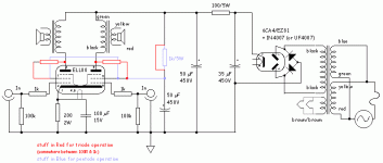

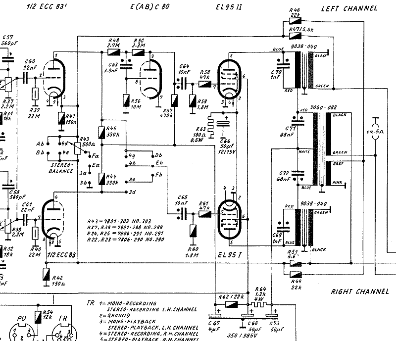

Found another for the el95 PP
Found it deeper in my hard drive, this is push pull.
This may be closer to what you are looking for... 😎

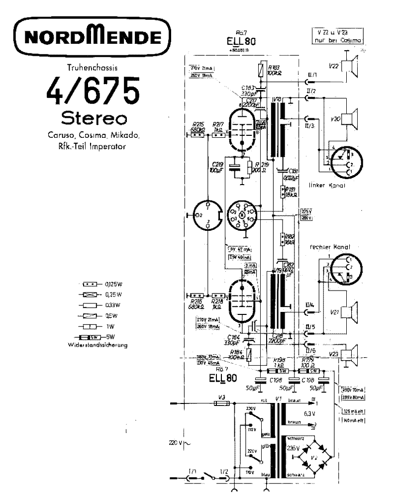

Thank you very much!
At first I like the Normende 3/683 PP. I saved the picture and printed out , impossible to read the parts unfortunately.
PP would give me (I think) 6-8W.
For 2W I need a min.90db sensitive or higher! My Visaton only 87db. That is why I sold my Philips tube amp.
When I listened classical and the sound went up lot of distortion.
May be I wait until I finish my 3 way speaker, that will be around 90db.

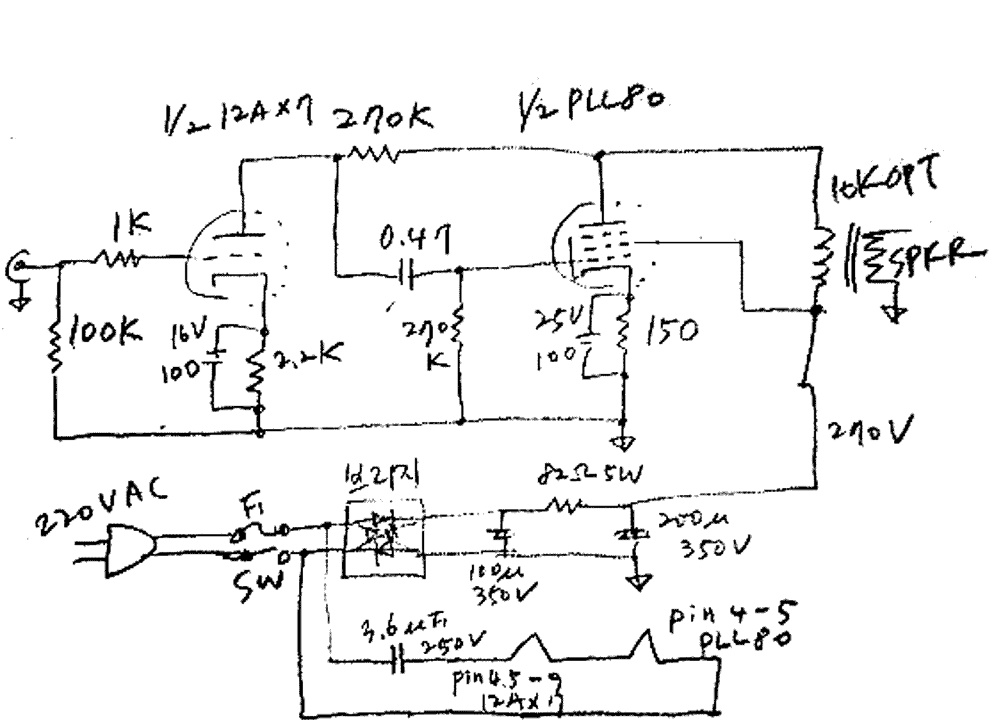

I also had a nice SE amp circuit, I attache the schematic.
Here some info in English
Weeny vacuum tube amplifier on 12AX7 and EL95
The original in Polish
Malutki wzmacniacz lampowy na 12AX7 i EL95
I don't know if I can parallel the power tubes to get a bit more power. The question can the half ECC83 drive the 2 paralleled EL95?
I don't want to use a extra preamp, extra cables, connectors etc.

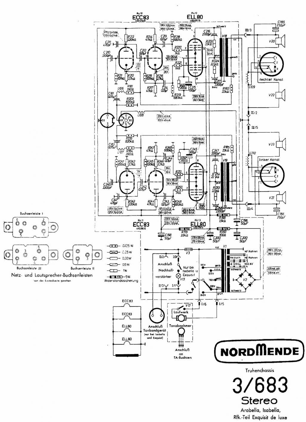

Are sure you got the full res image? I can read it fine.
The front end is "the same" as Red Light District and tubeLab simplePP. Likely a bit better than the Normende.

Hello!
Thanks everyone and Gaborbela for starting the sub-thread!
I will just stick to one of those schematics just to be safe, most likely to the one mltube posted.I will give my amp one last shot with a bigger capacitor to lower the gain though to see how it will go.Thing is that i have only one OT so i will go for only one channel.
