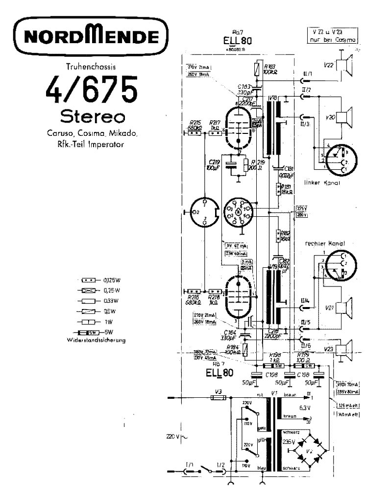

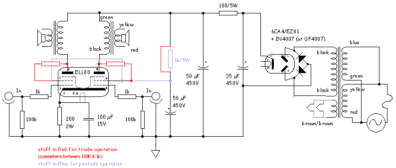

The ELL80 is essentially 2 EL95 in one bottle.

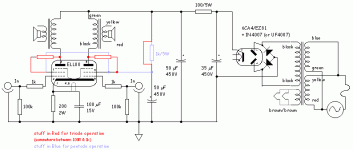

We built an ELL80 spud amp and i gathered quite a bit of data.
Attached is the map of the amp we ended up building. You really need some good drive to get it to full power, so an extra gain stage at the front might be needed.
It sounds fine in pentode mode (especially with single FR speakers that like the high output impedance, but sounded better in triode (but gets down to ~1w).
dave
Dave,
Because of its very low RP, a stage gain of approx. 60X is easy enough with a RC coupled 6GK5. If that truly is not enough, front end everything else with a 12BH7 section whose cathode bias resistor is unbypassed. Do not put the extra voltage gain block inside the NFB loop. Between the natural linearity of the 12BH7 triode and local current NFB (degeneration), distortion is not a problem.

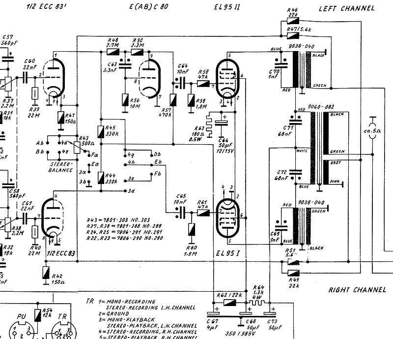

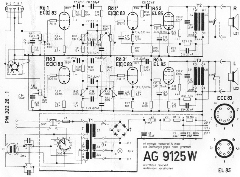

Why one channel use one more tube
planet10 said:
Here is a grundig EL95 SE schema (with a common PP woofer channel)
I read the schematic, why the upper channel use one more tube than the lower, would this cause 180 degree out of phase between L /R channel, need to alter the red / black spk. wire in either one channel.
Re: Why one channel use one more tube
Very curious indeed !
There are 3 output transformers, one per channel for trebble and one common for basses.
The EL95 are used in SE mode for stereo/trebble channels and in PP for mono/basses amplification.
The additionnal unity gain stage is a paraphase/see-saw phase splitter needed for the PP mode to work while the correct phase for stereo/trebble is restored by swapping the connection at the secondary of the transformer (black/green wires) in the -so called- right channel.
Predicting the crossover behaviour looks like a nightmare involving transformers caracteristics, caps accross them and separates feed back loops :xeye:
Not so stupid for a bean counting/industrial point of view 😀
Yves.

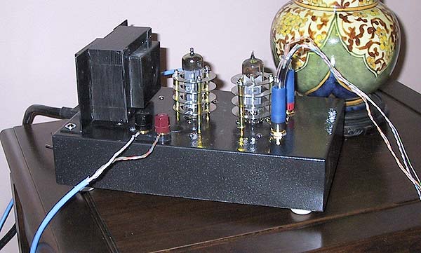

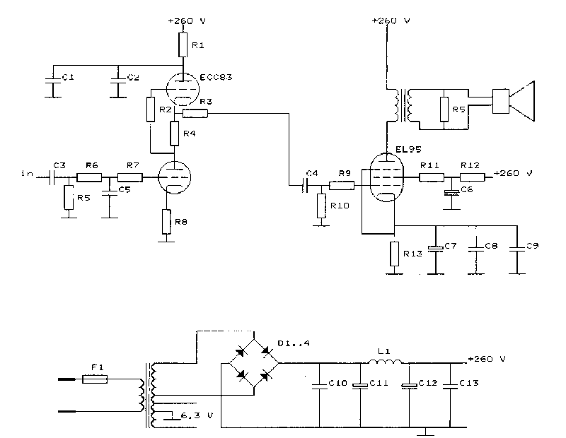

Here what I built some years ago:
A classical very simple circuit, sorry, just handdrawn.
The result looked like this:
As you can see, I replaced the ECC82 by an E80CC, this is a very very fine driver tube for this application!
Backside:
Franz
Cute? Thanks!

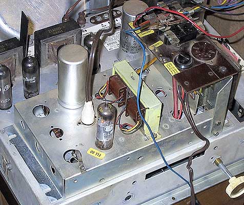

This how it looked inside:
I used two torroid trannies: one to step down to 24VAC, the second one to step up.
The first one had some added windings (black wire) for the heaters of the tubes.
Most of the enclosure is filled with psu parts. Two output trannies from an old SABA radio.
The smallest part of the space is used for the amplifier circuit:
Franz
