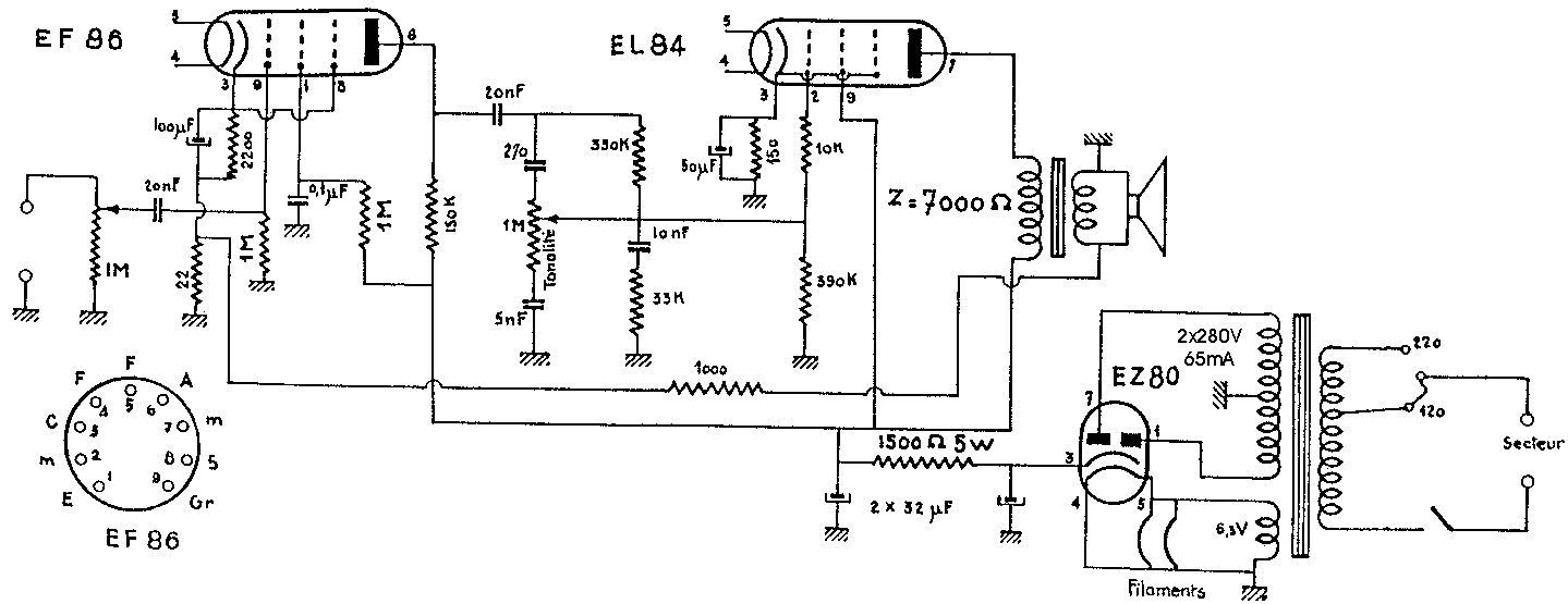

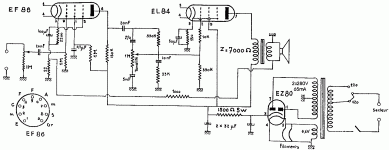

Another one:
http://members.at.infoseek.co.jp/lagarto/el84seamp.png
edit/
in above post, it is a EF86
Another one:
peak power are 4.5W and 5% distortion are 3.8 W.Freq response are 20Hz to 50Khz -3dB at 1W rms. very natural
sound
edit/
