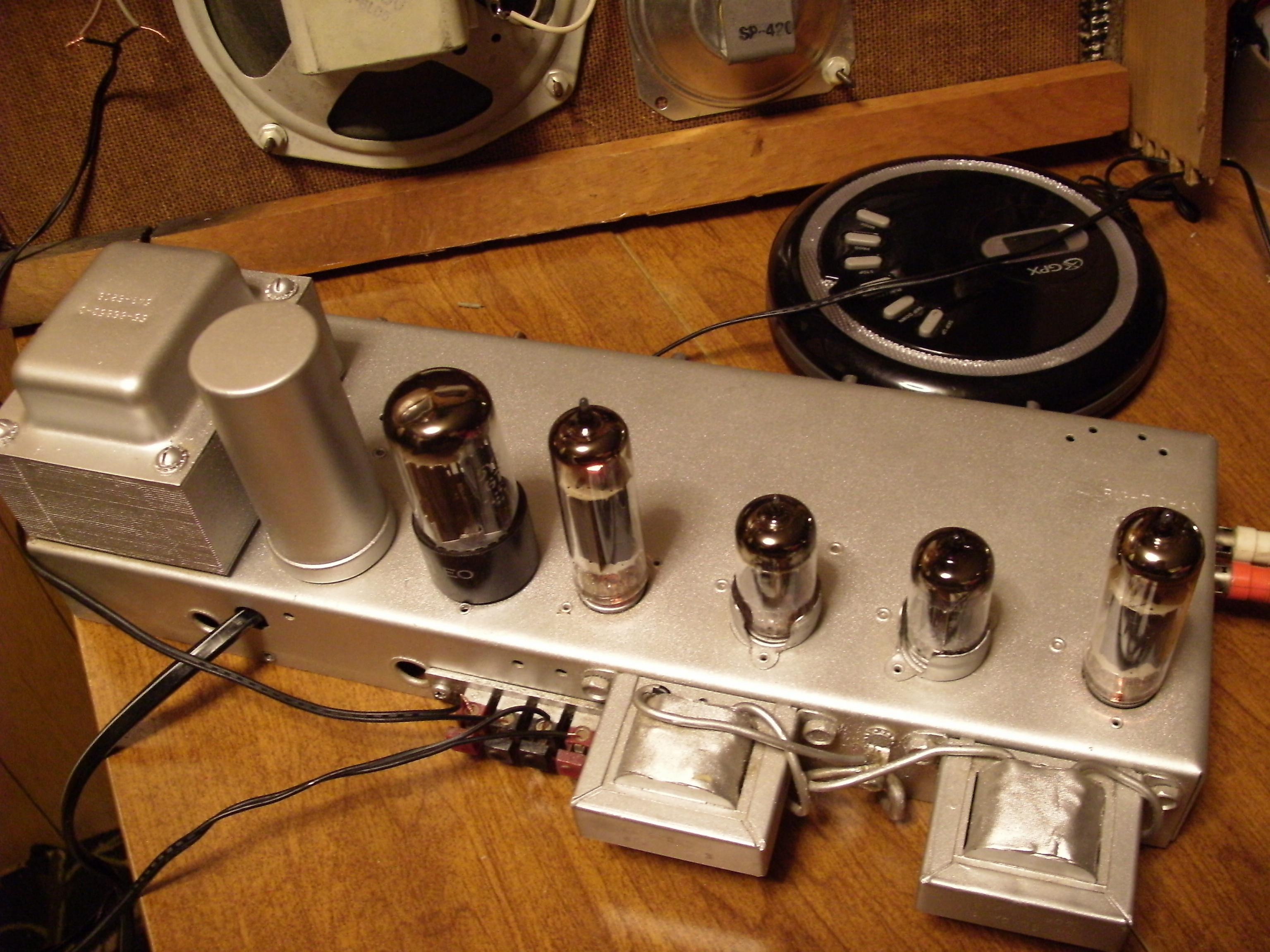

hello my first post here, planing to build my first point to point tube amp from scrap parts. i gathered some old tube projects for years back to get some parts to harvest, a el84 12au7 amp i pulled from a old record player if i recall correctly, also available i have a tube radio with 2x 505c, 12ax7, and 7 9pin radio tubes.
the el84 amp was given some terminals, input jacks, and a power switch, nothing else was done, all original parts, i don't recall the make or model,(if any one knows please tell me).

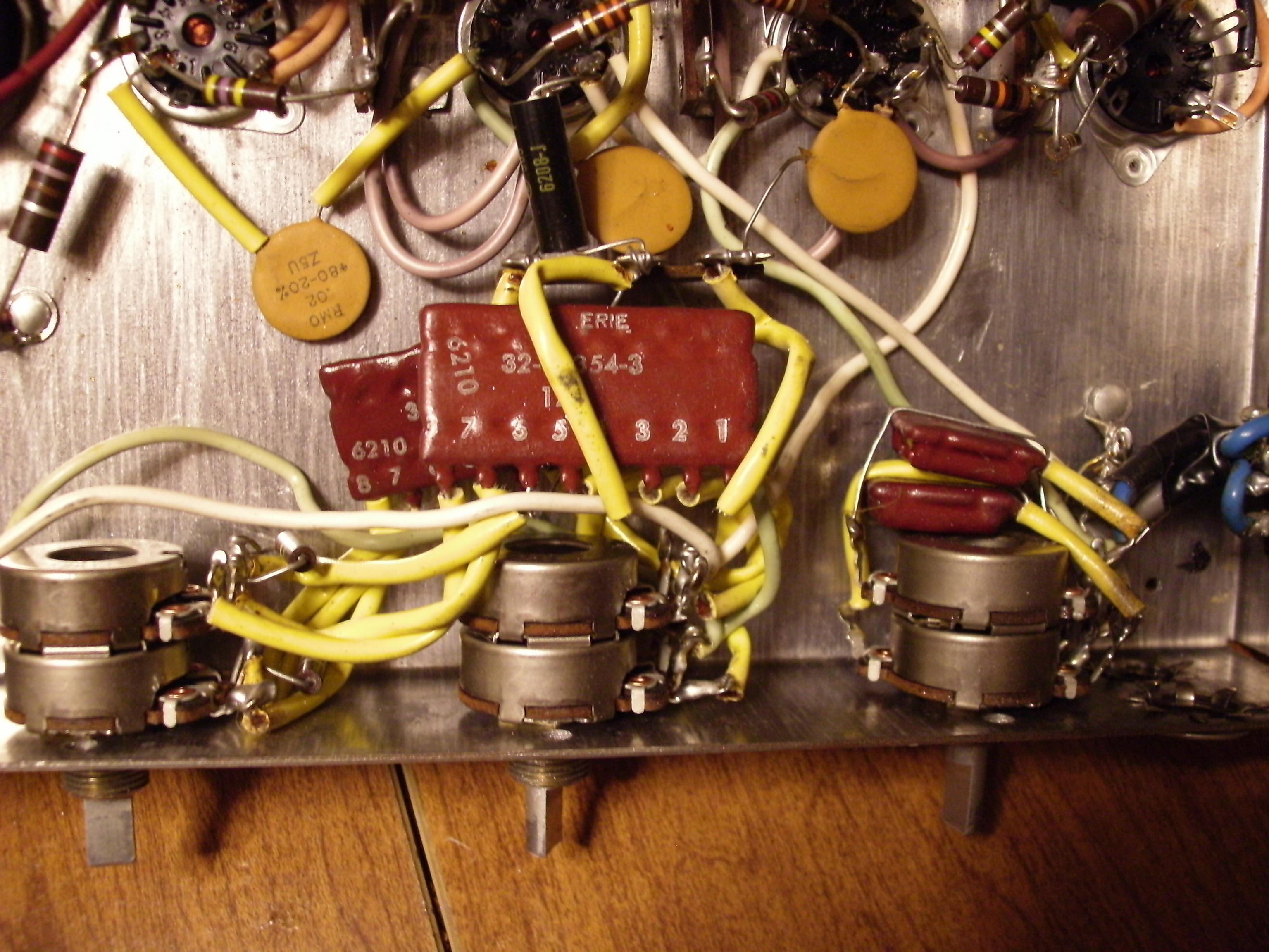

i would like to find a project to make using these parts, just a simple amp with a separate simple pre. now the el84 sounds ok now, i just dont like all the control pots. perhaps i could remove the controls? noob here, i know my way around a schematic and iron. perhaps someone could recommend a good beginers project with no to little budget and my parts available?

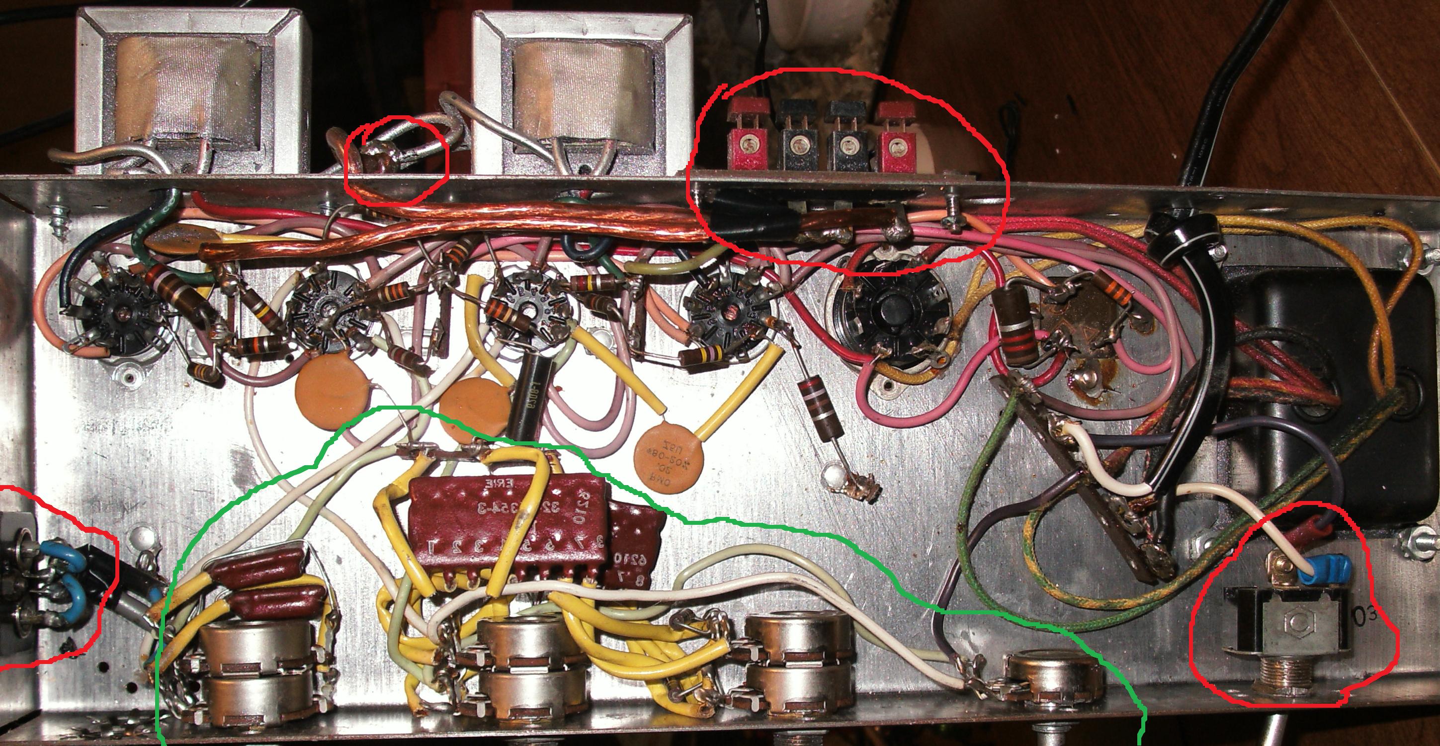

i have here the pics of the amp, the circled red is the parts i added, the yellow is what id like to remove, if at all possible

Looks like a good candidate for an RH84. Adding a choke would be a good idea, and you'd need a 12AT7 for the front end (you should be able to find a used one cheap). That will leave you with a spare tube socket to add another gain stage (pre-amp) if needed (my RH84 don't need).

Both use Greatz bridges, half vacuum (EZ81), half-SS. The second set of amps are monobloks and a fairly dramatic variation on the RH84. The front-end is triode strapped EF86, and the 2nd OPT is used as a plate load for a parafeed output stage.

thank you for the advice, the rh84 looks to be my first project.
