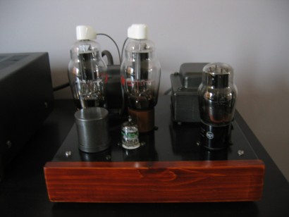

I build both an EL84 and 807 (in triode mode) pushpull amplifier using the same outputtransformers from an old Lafayette amplifier (very popular in Belgium & The Netherlands).
They both performed very well, I found the 807 amp slightly better
than the EL84. No sign of an irritating sss-sound here.
Quescent current for a typical PP-EL84 stage is around 35-40mA per tube so a few milliamps more for a 807 won't hurt your outputtrannies.
Good luck,
Jim.
My PP-807
