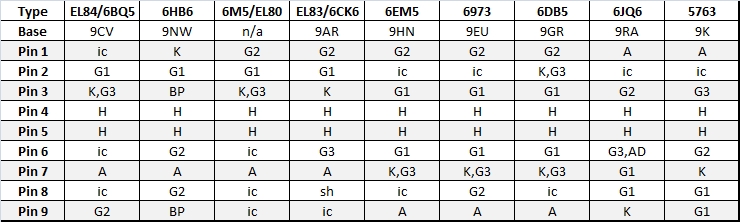

hello 🙂
friend gave me some tubes from an amp he had serviced years ago.
YAY i say! first glance, i have some spare 6bq5's!
they have no label...
well. they are NOT what i expected.
one small, minor, tiny, insignificant difference...
g2 is on pin 1.
pin 9 is just a support for the mica insulation.
so, erm...what exactly ARE these things?
theres that many million numbers i could be searching for the rest of my life...
thanks peoples with more brains than me 🙂

cheers for the quick response, but no prizes yet...
6ce5 is a septal base (7 pin)
el86 has same pinouts as el84.
the ONLY difference with what i have here, is g2 being on pin 1 rather than 9.
not considering characteristics, of course...

6P15P / EL83 ?
316a
Are you shure it's g2 on pin 1 and not g1 ?
The EL85 (or EL805) has pin 9 free but g1 on pin 1.
Mona
Mona
If it is made by Philips there should be a code etched in the glass close to the pins.
You can look that one up to see what it is.
EL83 would be my prime suspect. Etch code mU, T4 or fL.
Can you post a photo?
ooooh, the 83 looks like it could be it....
right. i guess i need to set up a test bench to really check it out.
cheers peoples... im still open to suggestions though!

I was thinking can it be 6GK6, almost same specs and outer look as EL84, but different pinout. Nevertheless G1 is still pin2
This might help
my hero!
1 6bq5.
1 6em5
4 6m5/el80
out with the soldering iron!
hmmm, not so easy to find a data sheeet and most references say theyre pretty poxy anyway...
i have a feeling this was from his "moody blues" amp, being australian and all that gaf.
might suggest modifying it to suit the el84.... if it wasnt already done. never thought of looking INSIDE his amp now, did i?

The EL80/6M5 is ~90% of an EL84, plate dissipation of 10 watts, not 12, and need to be a little cautious of screen voltage. Perfectly useable in EL84 designs though if limits respected. If you have a bunch, light them up, they will be nicely made tubes from Philips Hendon plant, made with Mullard dies (and prob the internals).

thanks for all the help, and that datasheet! some people really go out of their way... kudos 🙂 sometimes the world isnt as messed up as it appears.
