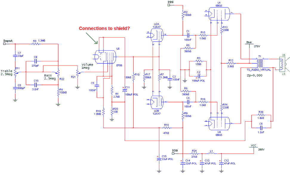

Shield connections go to chassis, normally. Or maybe you are asking about something else?

There is a sketch in Bonavolta's website -- I converted to Multisim -- but am wondering about the shield connections on the EF86.
Tone controls model out pretty well.
C3 connected wrong .
Shield connection to ground of course.
As treble is adjusted up, and bass is adjusted down, the input impedance of the tone circuit will decrease, particularly as frequency increases. Worst case around 240K at 20KHz.
It would be a good idea to add a buffer stage before the tone control.

C3 is on the wrong side of R7 by way of clarification.
Consider a Baxandall based tone control with a CF in front of it to provide a constant input impedance. I expect the current implementation will be somewhat noisy, and good 2.5M pots may be a little hard to find.
