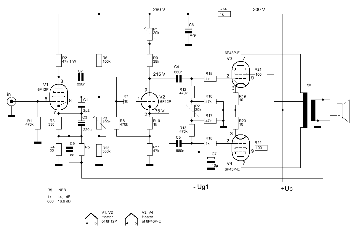

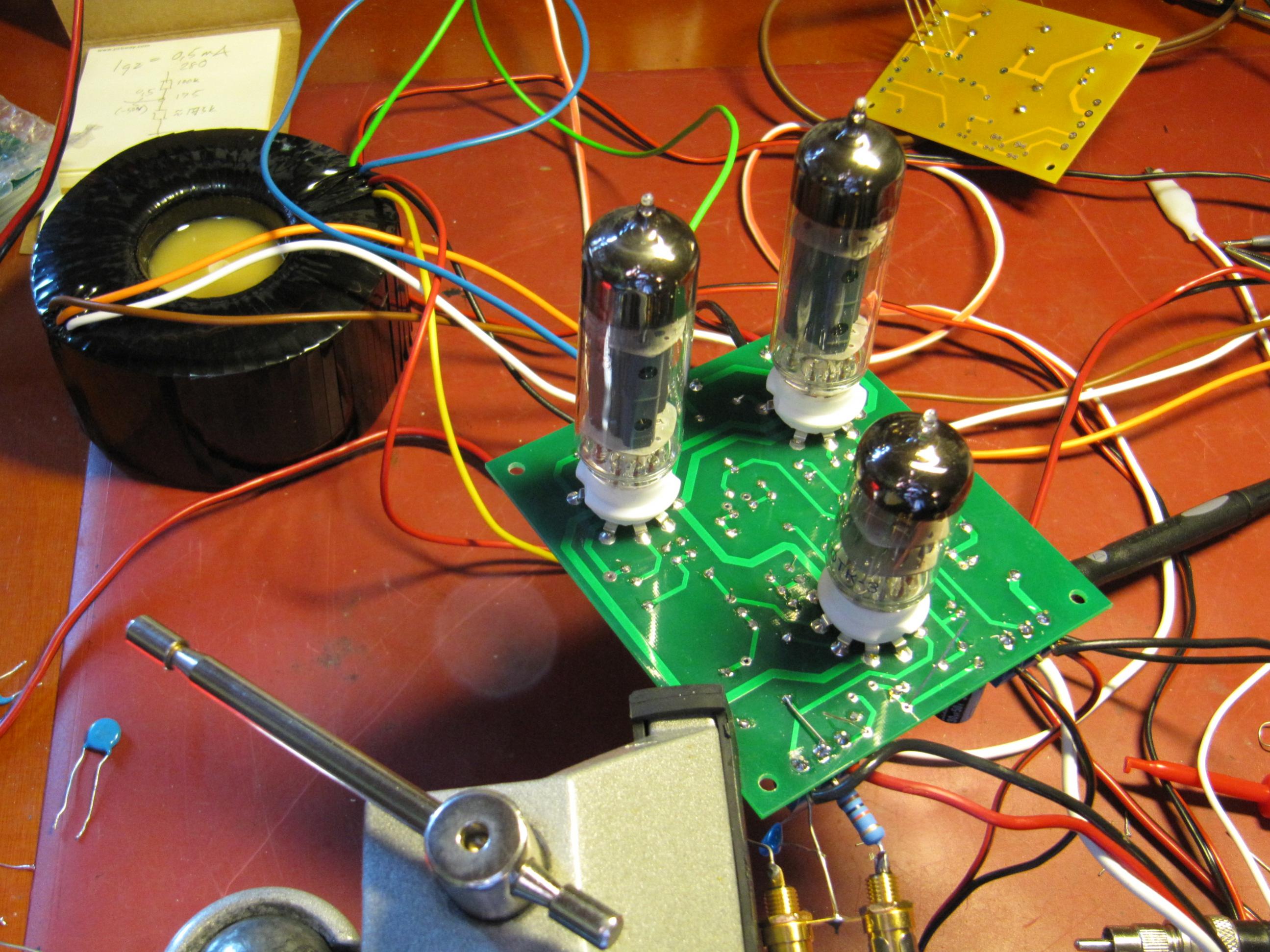

I have built and tested several amplifiers with EL86 (6P43P-E), which is quite close to EL82.
With 300 V supply voltage and 5k UL-output transformer, more than 20 W is possible to get. With 250 V and 4k UL-OPT, it is possible to have some 15 W.
This is my test circuit, a Dynaco-style pentode amplifier/cathodyne phase inverter with 6F12P triode pentode.
Hi artosalo,
where did you find the nice PCB?
regards
Peter

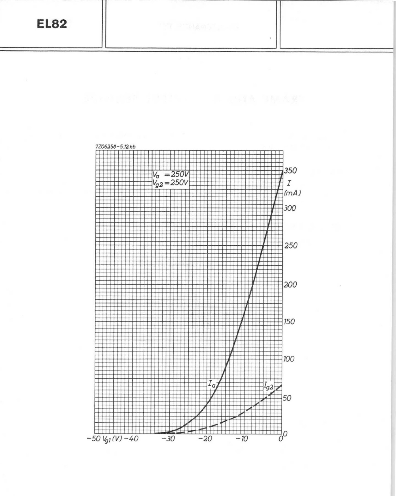

In contrary to what has been said previously, EL82 and PL82 aren't 12 watts pentodes, but 9 watts instead, see also the Philips datasheet excerpt at the Japanese site. EL86 is a 12 watts pentode.
As especially PL82's still are cheap enough, I wouldn't bother with expensive UL41's as replacements, which indeed is equivalent electrically.

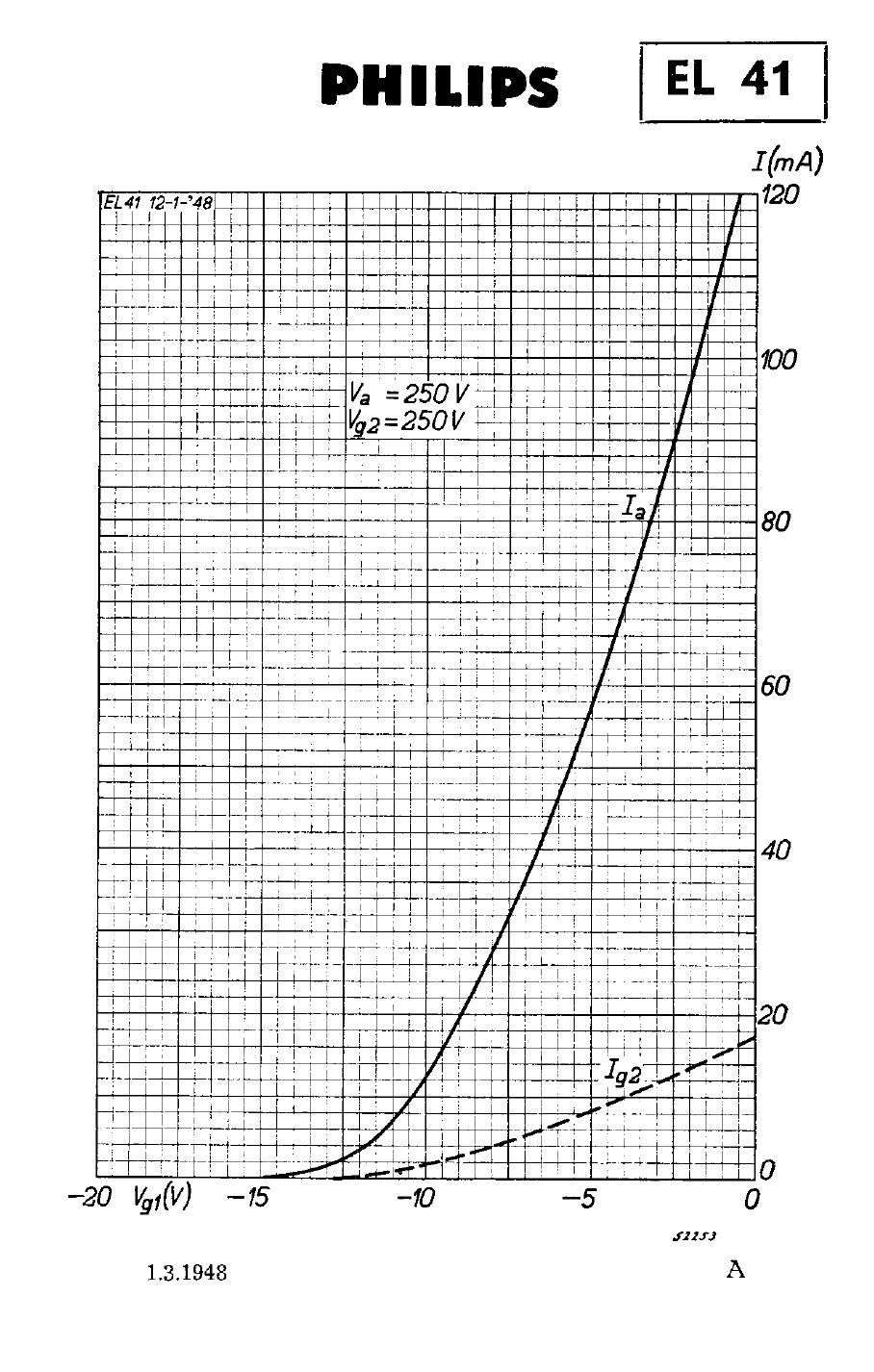

Yes, it's like the difference between EL84 and PL84/UL84. The series heated tubes have lower plate resistances and lower µg2g1, enabling them to operate at lower mains/supply voltages satisfyingly.

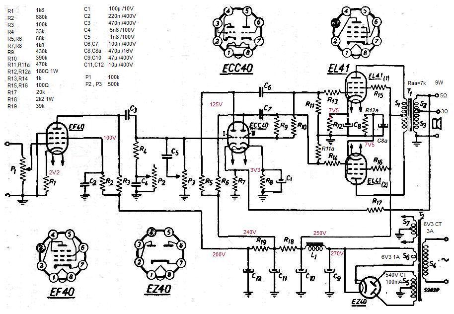

I have a Philips 52HD514a table radio, unfortunately incomplete with missing back cardboard panel and dial cord, that also features two EL41's in PP (and rimlock tubes throughout).
Best regards!
This is an interesting device, especially due to the HF generator that feeds the projection lamp! Anyway, it is more than questionable why Philips opted for UL41's and fed their heaters directly from the power tranny's primary instead of EL41's and safe 6.3 Vac heater windings.
We're still missing a hint to the primary impedance of a UL41 PP amplifier.
Best regards!
Edit: The hint relly isn't that far: The UL41 datasheet mentiones 4 kohms as the primary impedance in PP amplifiers operating either at 100 and 170 V.
