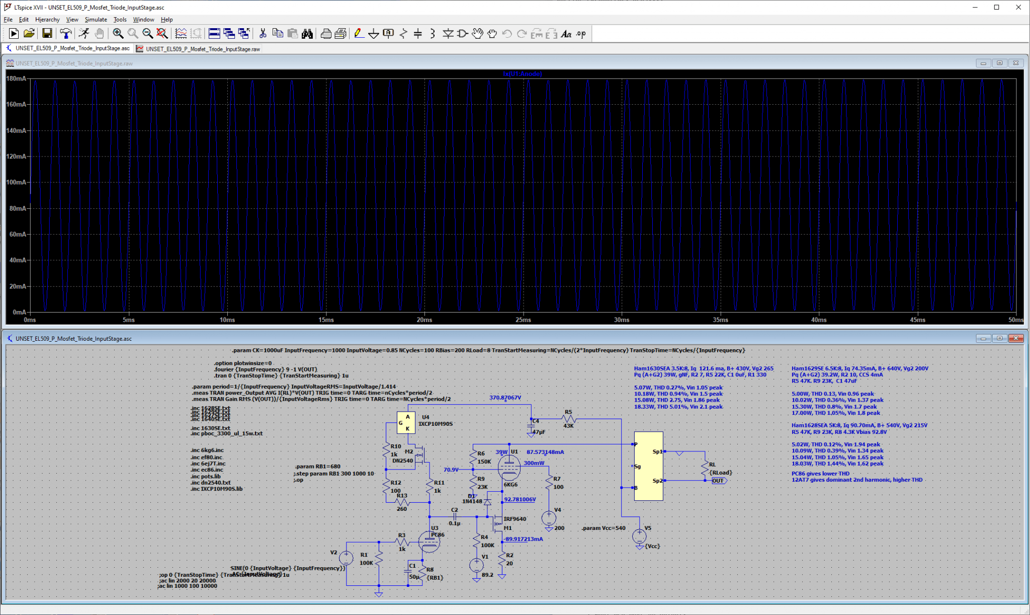

The folks that built the UNSET with sweep tubes 26HU5 and 26LW6 (similar to EL509) seemed to settle on reflected loads of 1.5k to 3k, with B+ voltage below 500V. Does your simulation show better results with a 5K load; at what B+? What driver tube are you using in your simulation? I’m well advanced with my UNSET PCB population but I’m temporarily stuck on the operating conditions for the driver tube that I plan to use (12gn7a on input/driver and 12LW6 output tubes with 3k load and B+ around 450 V).…. I'm planning to use Tubelab's UNSET, just to try something different. Simulations show that up to 22W is possible before clipping, I hope to get 18 at least. Need to buy a 30W 5K OPT though, looking at Toroidy at the moment.
Could you post your raw simulation files for us to play with? (As you know I’m trying to learn LTSpice.😁)
Attached the simulation file. The comments in blue are a bit out of date, but they show the trend anyway. I tried 3K3, 5K and 6.5K OPTs, and lower impedance/high currents result in a much bigger THD, which matches the usual practice. I do not like big currents, I prefer high voltage low current.
