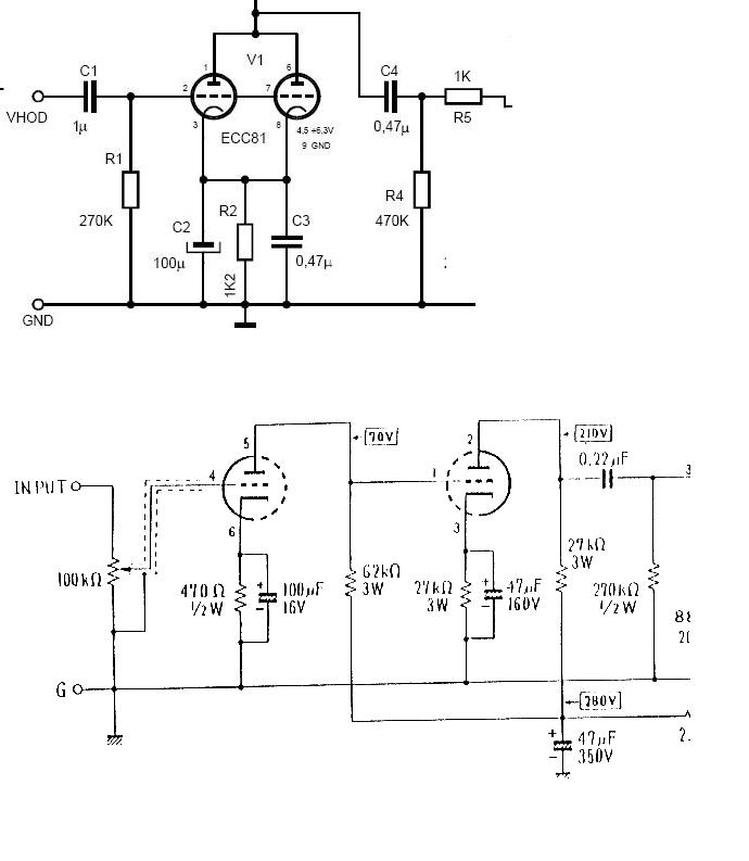

Hi all,
I thought better to revive this old thread instead of opening a new one, as I already found numerous SE EL34 designs....
However, I keep finding two different input stages,
as illustrated in enclosed attachement.
Wich one is "better", soundwise ?
I'm aiming at the best possible fidelity.
Driver tube will be a 12AT7 (ecc81)
oh and as a learning experience,
can you also explain why ?
Empee
