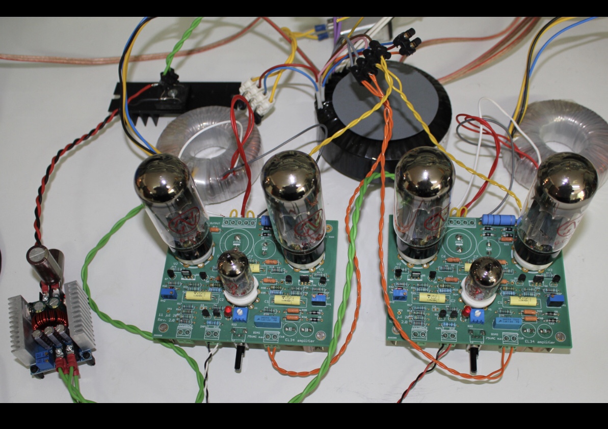

How about KT88 or KT90, 120 or 150? Check out this video series: kt88 single ended tube amplifier build 2018 - part 1

One of the best studio amplifiers for cutting master discs of varnish. Where is the cheap sound here? Yes, feedback is necessary, but unlike the 300B on the 811A, you can tune the optimal internal resistance with minimum distortion, analogy with the UL D.Hafler circuit or as in the partial feedback circuit, telefunken V69 and neumann LV60.

The sound is wonderful can drive any speakers; you would never use 6550/KT88 compared to the 811A GOTHAM PFB-150WA Power .Recently I built one with a Toriody output transformer
