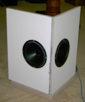

L shaped dipole sub with a pair of 10 inch Peerless polyprops. Damped MDF panels expoxied to paving stone. I have replaced drivers with ETON 8-800 HEX. A dipole rolls off at 6 dB per octave until driver resonance so you get pretty good response at frequencies below the baffle cancelation frequency. A passive line level shelf filter is easy for lower f -3dB corner. EQed dipoles or a transmission line is the way to go for a sub. I like to use stiff 8" drivers with high cone break up frequencies. Something designed for 2 or 3 way rather than for subwoofer use.

Kill it or move to appropriate existing thread. I have noticed some recent interest in L shaped dipoles but maybe it was on another forum. I could provide more information if shown a little more courtesy and some interest.
