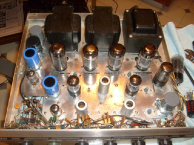

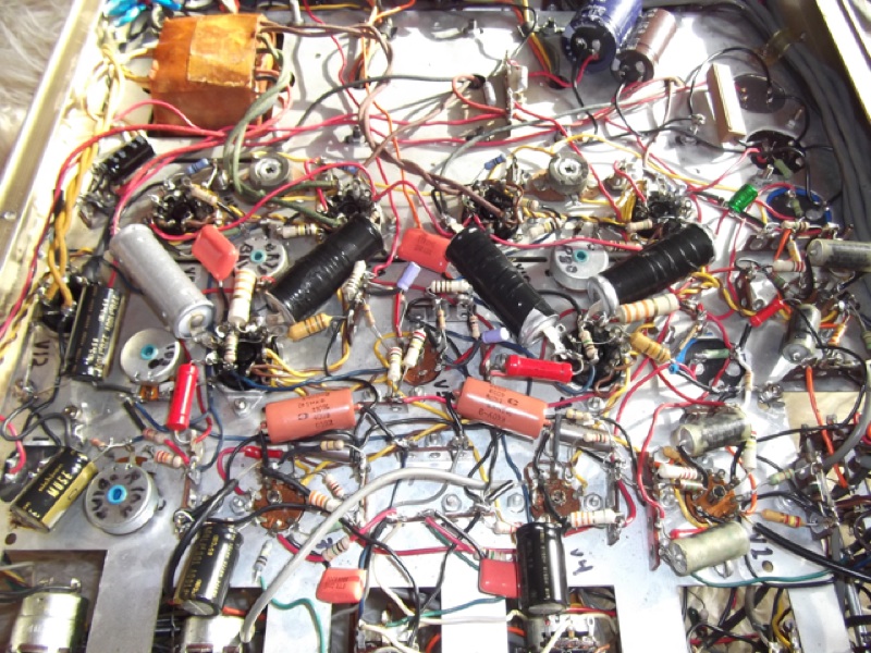

Here is how I did a few of them including my own with 6P3Se tubes.
These are 6L6gc equivalent that is superb only its a bit easier to drive than the 6L6gc.. As Eli had mentioned,the circuit can lack drive so you have to do some resistor changes on the 6sn7s to make them swing a bit more voltage.
The hf50s,60s,hf87 and 89,all have the same basic circuit however,they have no problem driving the KT66 or the 6L6gcs because they running a higher B+ on the 6sn7s. I was able to raise the B+ on the 6sn7s of the ST-70 by about 19vdc and with other complementary changes,it came close to the drive of the units mentioned.
You can see the way i rebuilt this one and I used a film caps for the power supply..I can give you the many parts and resistor I had used..I have paper in oil caps as well as a few teflons and silver micas.

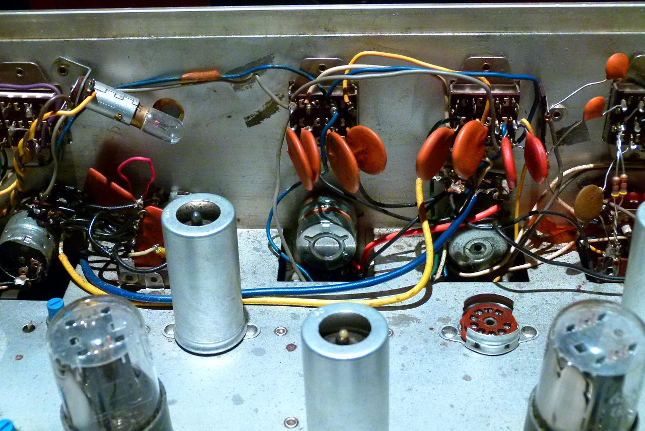

Thanks for all the tips and advice. I went ahead with the purchase and it's now sitting in my garage. I haven't had any time to have a look except that the balance control knob does not line up with the others. I have a feeling that it has been replaced with a non OEM type but I will have a closer look later today. The fellow did say that the volume control was replaced last year with an OEM but maybe he was a little confused. He said he had a tech do it. Could anyone tell me what the Eico part # would be for the balance pot and the volume pot just in case both need to be replaced. Here is a pic. of the Vol. and Bal. pots. Thanks again.
