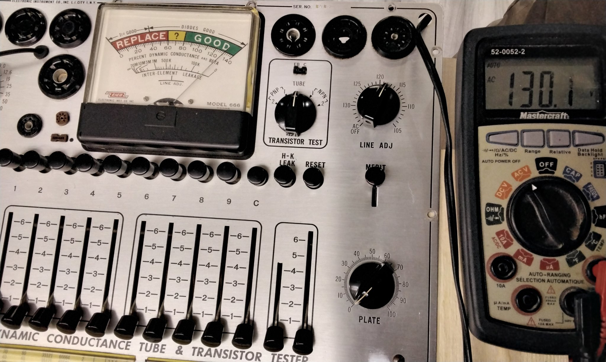

I tried to do calibration tonight, but didn't get past first step. I set voltage to 130, then pushed C button and touched cap lead to chassis, and the needle moved toward "0" on inter-element scale, but didn't make it all the way. It stopped at about 130 on upper scale as seen in attached pic. So I tried adjusting R7, but nothing happened. I moved the knob throughout the full range, but the needle didn't budge.
I then measured the resistance across the centre and outer pins on R7 and the resistance changes when I turned the knob. So it seems it seems to be functioning, but maybe not properly. The document by Mike at MDBVentures.com suggests cleaning or replacing the adjustable resistors if unable to zero meter, so I'll try cleaning first.
Any other suggestions would be much appreciated.

Well, I feel like an idiot. 🤦♂️ I had the calibration pots mixed up. After taking the tester out of the case I put it face down to figure out where everything was. Then I flipped it over and was having a hard time connecting my voltmeter at the back, so I turned tester around so I was looking at from the top down with the meter closest to me. I was thinking R7 was on my left side, but it was actually on my right side.
Before I figured out what I was doing wrong I cleaned the calibration pots and replaced two 270K resistors that were measuring 320-350K. Then I tried calibrating again and it still wasn't working, because I was still looking at the tester upside down. I went back to the "Buying, Restoring, and Calibrating" document and then to the schematic when something clicked and it suddenly dawned on me what I had done.
Now it is calibrated as per the manual and I tested the two 6U8 tubes again. On the first one the needle went all the way to 140 on the end of the GOOD scale, but it didn't go past like it did before. The next tests where fairly normal, around 120-130.
I still need to do some more testing and read through all those documents, but at least now I feel like it is working reasonably well and I don't need to worry about returning it.
