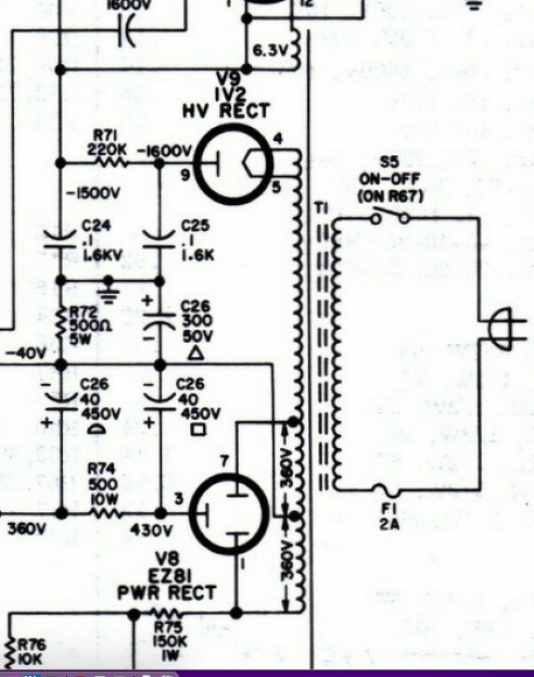

I've ordered an EICO 435 to repair as best I can. I'm trying to replace the 2 Can multi capacitors.
The 2 originals are 40/40/300uf and 20/20/20uf, all at 450V
Would a 500uf be too big to replace the 300uf, or could it be beneficial?

Thanks, I hadn’t noticed that. On the parts list in the manual it says 450v, so I ordered a 330uf 450v
Higher voltage rating is better, especially with actual 430 VDC on the 40uF capacitors in the circuit.
Yes, but it makes for a larger capacitor. I'd use a 63 V.

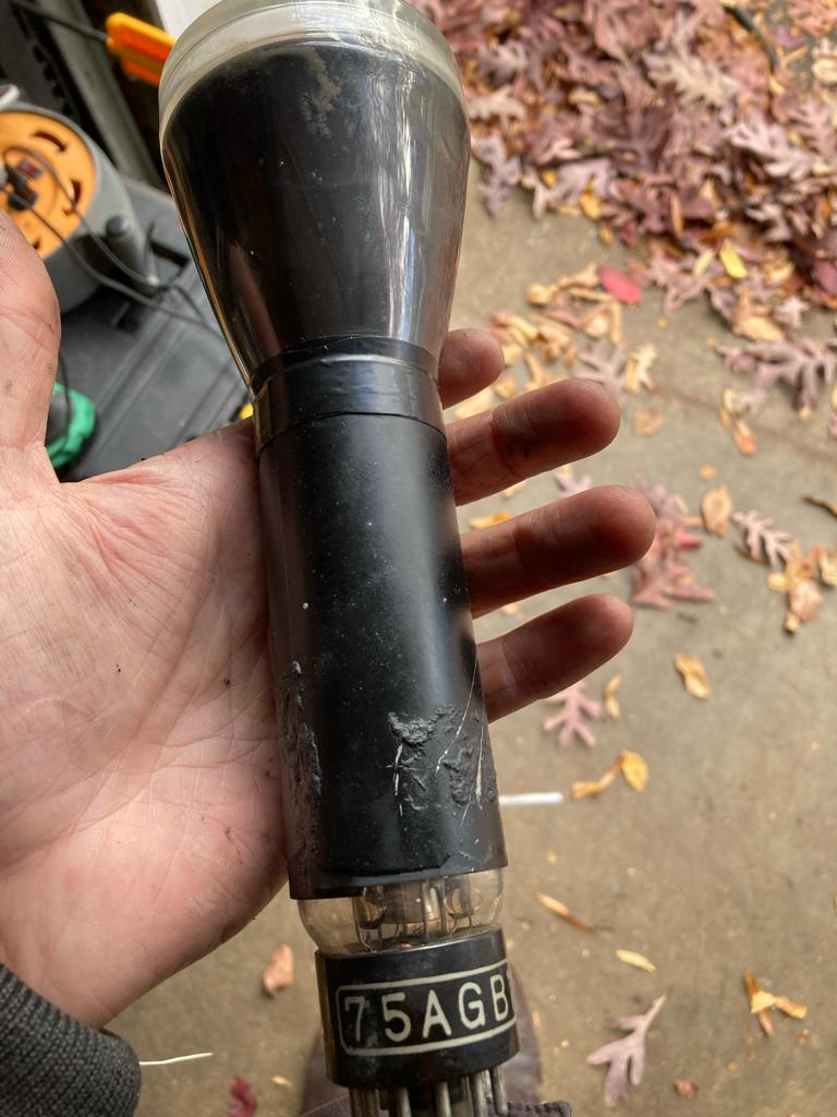

Before switching out the capacitors, I have removed the CRT for general cleaning. It has a metal sleeve between the tube and the bracket holding it in place. There was also an expired gummy material that I cleaned off, which must have been to protect the tube. The metal sleeve was taped to the tube with a yellow tape that had also expired, and I replaced it with 3M electrical tape.
-What would be work well to replace the previously spongy absorption material?
-Is common electrical tape OK to use here or is something heat resistant required?
-When cleaning the metal sleeve, I scratched the paint a bit exposing the metal. Does the black paint serve a purpose?

Don't worry about scratches on the sleeve. It shields the CRT from magnetic fields. You can spray it black again if you want.
The spongy material used to be common foam. The tube only gets hot (more warm) near the base where the heater is. Electrical tape is fine but will probably get gummy over time. You can cut down packing tape, or thicker tape for paper ("Scotch tape").
Once you have it working, you will have to rotate the tube to make your horizontal line .... horizontal. Keep the tube right away from magnets!! Same for the shield you cleaned.

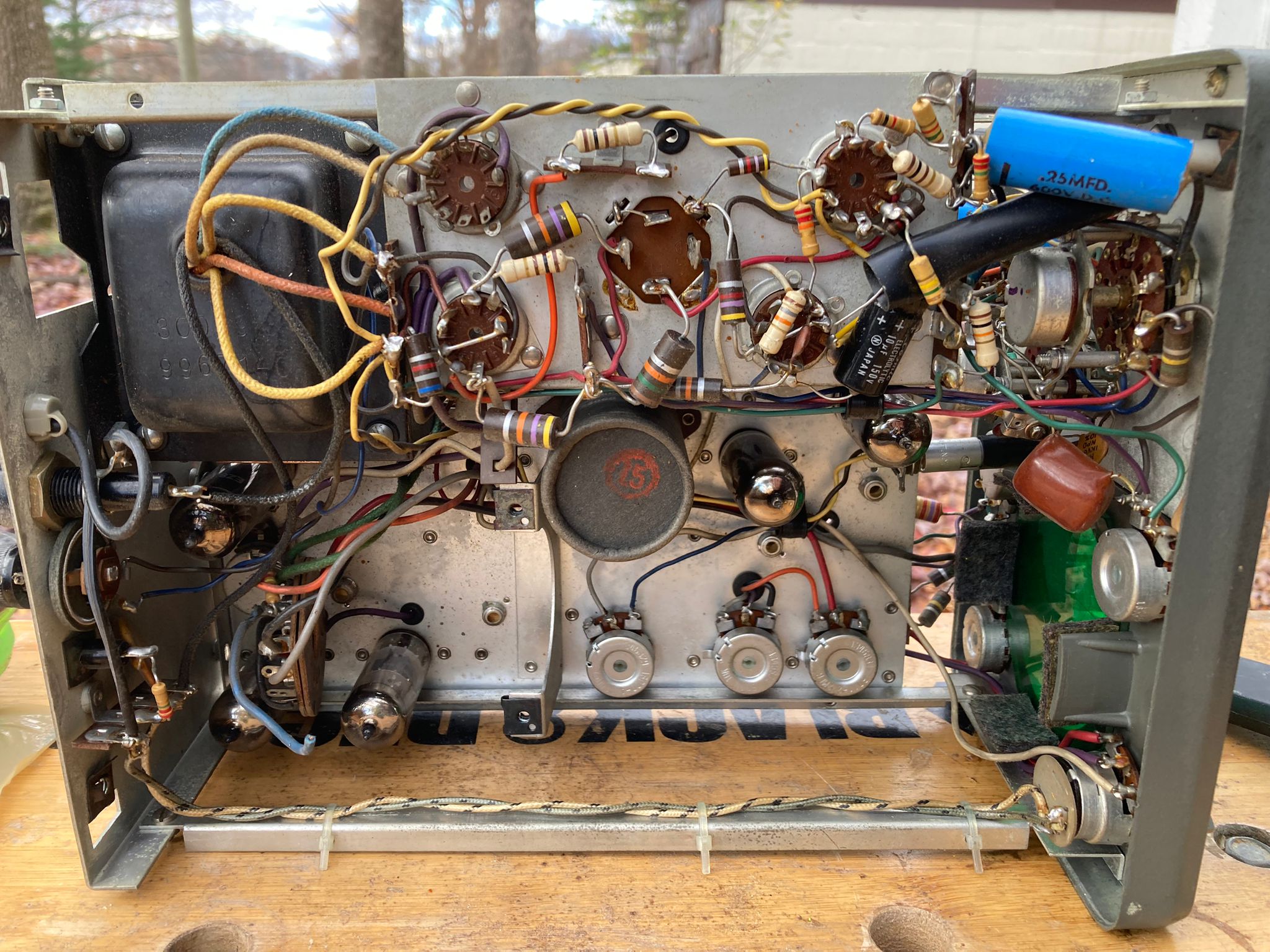

I'd like to change the power cord to a grounded 3 wire.
-Would I simply connect Live and neutral as they are, and the ground to chassis? On tube guitar amps I've bypassed a small capacitor when doing this modification. Would the same be done here?
As I've worked on small guitar amplifiers, I am very careful with the high voltages in the power supply capacitors, and always drain them before touching anything. Ive noticed on the schematic that even higher voltages are listed around the CRT.
-What extra precautions should a take in the case of an oscilloscope of this nature? Do the small value high voltage capacitors store voltages long enough to be of concern?

Yes, pretty much. Remove the line cap to chassis. Just be very aware that your probe ground is in fact earth ground now.
You could install a Corcom line filter assembly (or similar from a different manufacturer).
If I do earth the chassis,
is it that I need to be very careful to only connect the probe's ground to grounded points in the equipment I am analyzing?
Yes. This can create ground loops, or big destructive flashes of light and heat (not good). Or it may simply cause a failure in your unit under test. These are the same considerations if the chassis was not grounded because you could bring the chassis of the scope up to whatever circuit potential you clipped to, then zap yourself when you touched the 'scope.

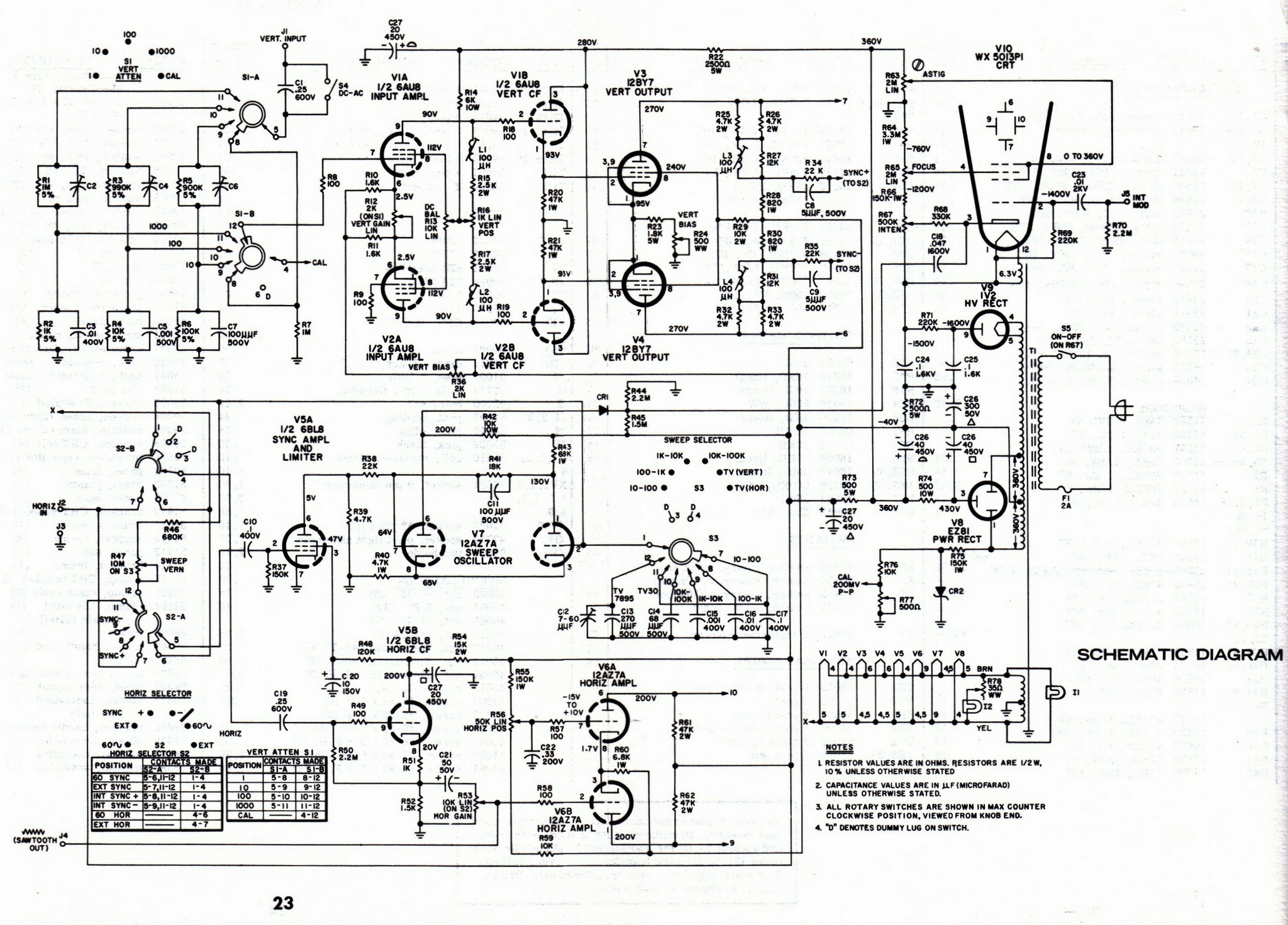

Thank you. When I opened the oscilloscope, I noticed a loose wire between pin 2 of the CRT and Capacitor C23. Can there be logical reason for that modification being done, or did the wire just become loose accidentally?

Repair it. Check C22 as it may have been defective and was disconnected during troubleshooting.
