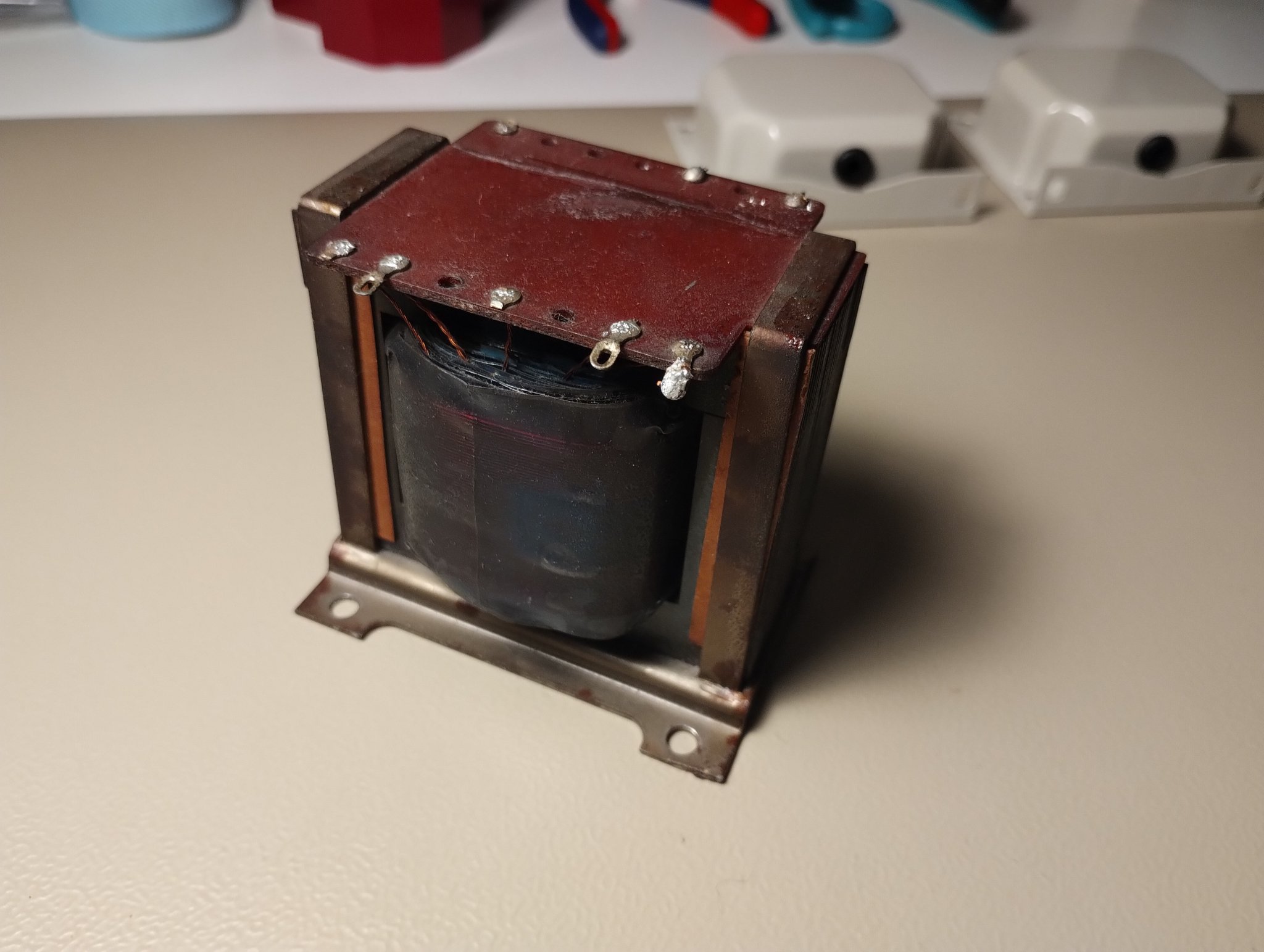

I am planning to rehouse a Philips AD9032 EI output transformer. This transformer did not have any end bells, just some brackets, and a bakelite board with solder lugs for the windings.
Since the core is standard EI-75 type, I want to attach end bells to it to make it safer and prettier.

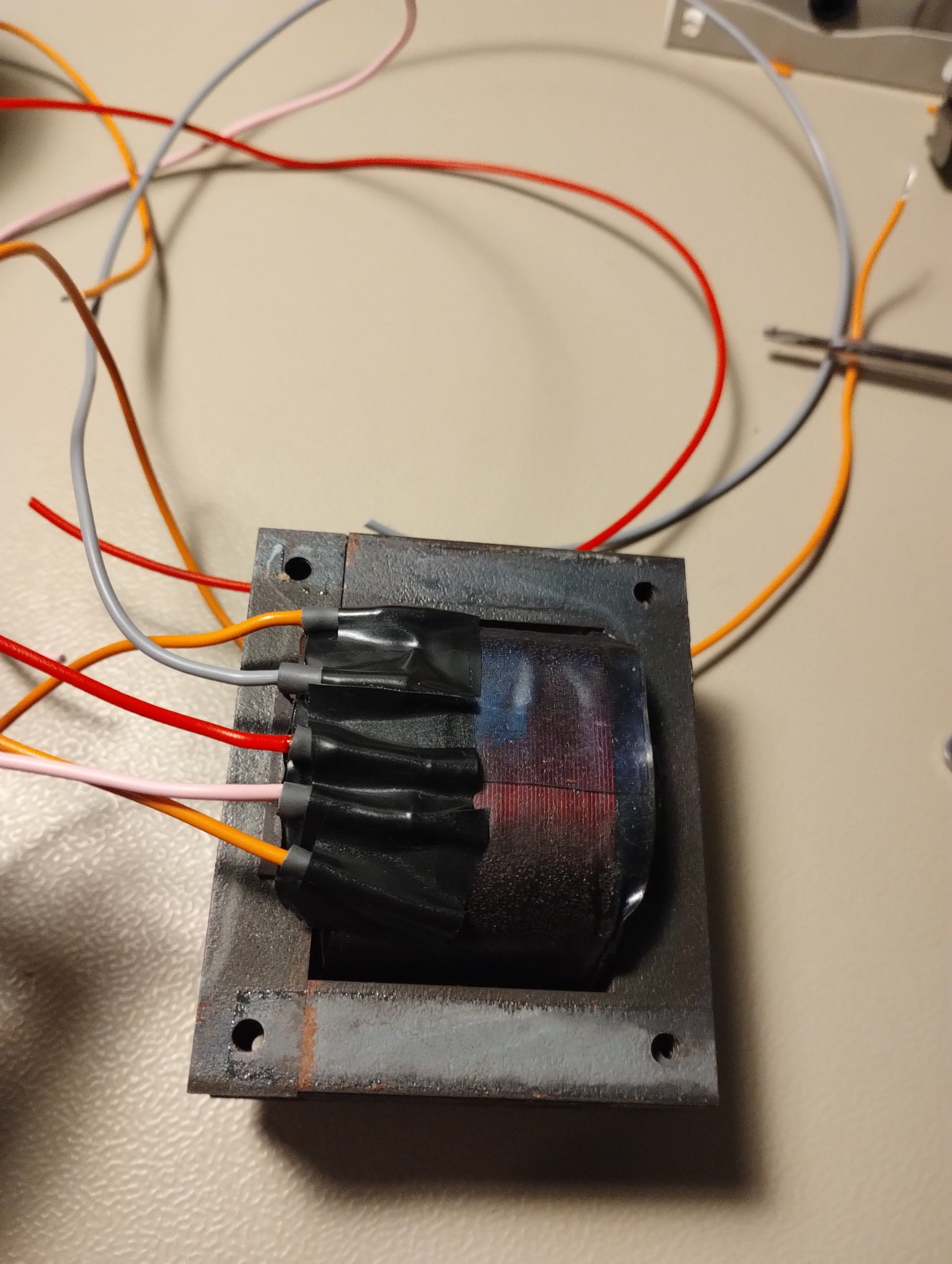

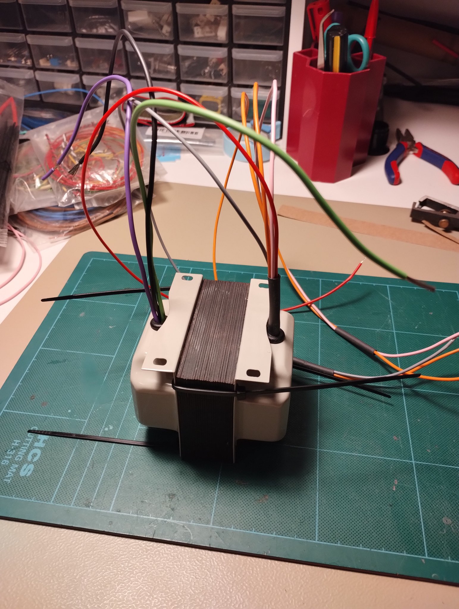

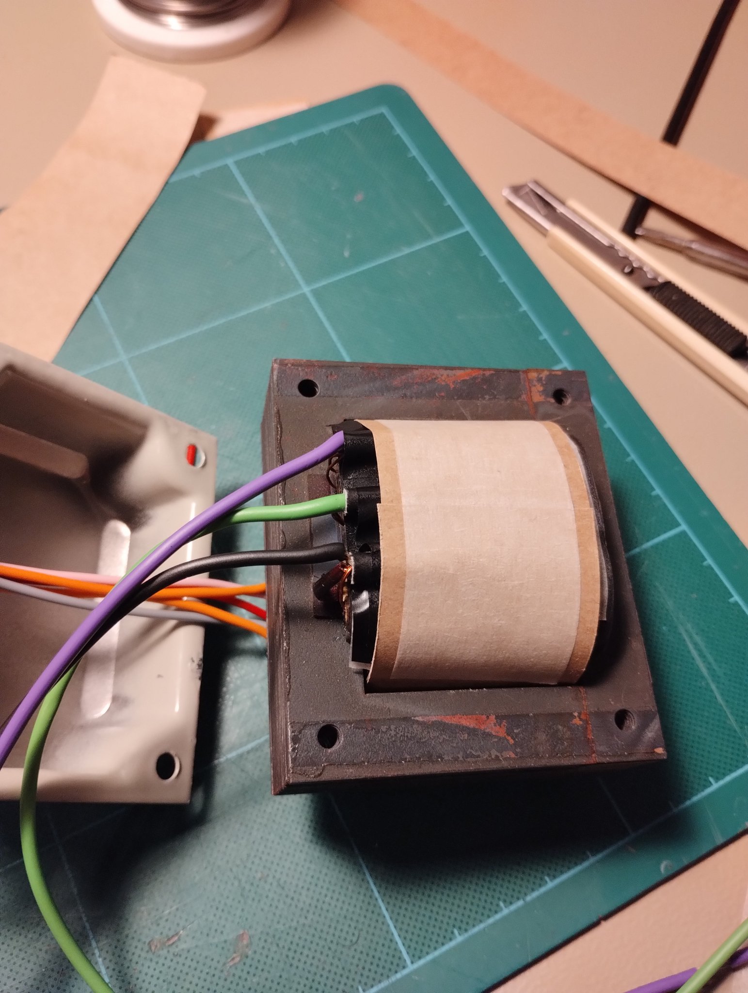

Here are some photos of the restoration - I removed the original brackets, soldered wires, used heatshrink tube and insulating tape, used paper and tape to provide a firm wrap around everything to hold them in place.
It is going well so far, and from your response I deduce that I was in the right, thinking about insulating only one bell from the screws.
Apart from that, I suppose that the screws for attaching the bells to the laminations should not be magnetic (for example galvanized steel), but instead non-magnetic (stainless steel), to follow the "unaltered core permeability" strategy. Is this correct or overkill?

Today I went and checked, with a small magnet, several of my OPTs on the shelf. All seemed to have magnetic bolts. And these are good American made trannies, Stancor & Thordarson, not some ersatz Chicom units. Although non-magnetic SS wouldn't hurt. But remember that all SS is not non-magnetic. Only the austenitic 300 series is.
