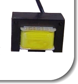

I would need some documentation/formula regarding inductors on EI laminated iron core, where the "I" lamination is missing or removed.. These are sometime called "E-core open ended chokes".
Many hi-current chokes, or inductors, in the market are built on EI lamination with gap to prevent saturation, some are built on just the I lamination (for speakers' crossover), and a few others (to which I'm interested) are built on E-core like this in the image, which is described as "open ended" thus approaching an air core choke performance, with flat inductance reponse.
In particular I would like to roughtly estimate how much factor the inductance will decrease moving from an EI-core inductance (usually with gap) to an E-core open ended inductance, once I have removed the "I" lamination

Computing the decrease compared to a ~closed magnetic circuit would be difficult, but it is possible to compute the absolute inductance, based on first principles.
Inductance is the reciprocal of reluctance: R=l/(µ*A)
l is the length of the magnetic path, A is the effective magnetic area and µ is the µr*µo product, with everything in SI units.
Determining A is a no-brainer: it is the geometric area of the center-pillar, minus ~10% or so of stacking factor.
Because iron has a permeability so much larger than vacuum or air, the reluctance of iron can be neglected, leaving only the air-path. I guess you can approximate this path by drawing a half-circle between the centers of the center-pillar and one the outside legs.
This will give you the average length of the lines of the magnetic field, l.
Similarly, µr can be neglected, thus µ=µo.
You now have to scale the formula according to the number of turns.
The final result will thus be L=4*Pi*10E-7*A*N²/l
You need to know N, obviously. If you have no clue, you can change your inductor into a transformer by adding the missing "I" member, and compute the turns ratio by measuring the voltage from a 1 turn test winding with the inductor driven by a calibrated AC voltage.
As usual with magnetic calculations, the result will be approximative: iron does not have a zero reluctance, fringe fields have a heavy influence, and the winding has finite dimensions.
This will get you in the right ballpark though, and if you need to refine the inductance value you can always add or remove a few turns

Absolute measurement of incremental L with ac over a wide frequency range is also fairly easy with a soundcard setup for impedance measurement using software like REW.
A relatively simple test setup can measure absolute incremental L for a combination of ac and dc current levels (as per power supply choke performance) at 2x mains frequency.
You can then experimentally determine open and closed magnetic circuit conditions, and set up some known gap distance conditions to get a prediction plot of the gap needed for a desired inductance.

Use a contactor....
Coil sits in E, and powering it up closes the I...
Get a few from scrap, and do your experiments.
That means electromagnetic relay, sort of...

Not easy to answer and not that useful anyway because you have no clue on original gap and other EI inductors will be built different anyway.
So forget the original one, I´d rather design/measure/build a fresh one, which is the objective anyway.
Elvee goes straight to the E only problem solution and will give you a close estimate.
Trobbins suggests measuring the one you have, perfect.
Personally I would wind a bobbin with, say, 100 turns, slip the E core in, measure inductance, and then scale up/down as needed knowing inductance follows the square of the turns ratio.
IF curious, I would then add a stack of I´s to close the path and remeasure, slight problem is that rough stacking by hand is not very accurate, so E results will be trusty and repeatable; EI ones not so much.
You may slip different thickness paper/Mylar/kapton sheets for more predictable gap.
