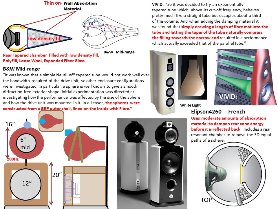

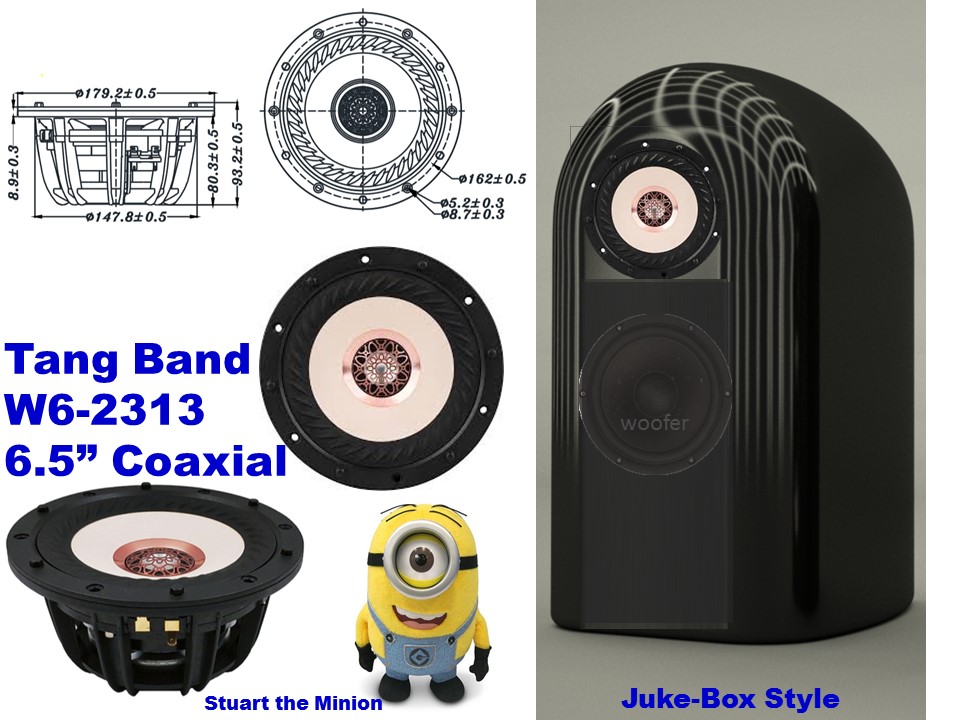

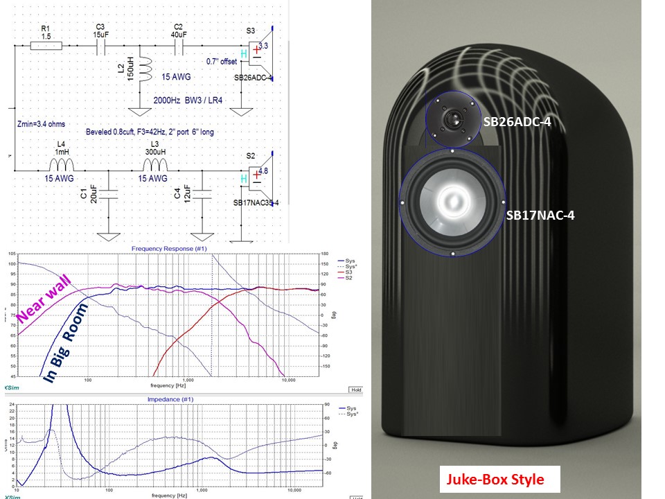

For on desk placement, a "juke-box" shape is both attractive and has very low edge diffraction distortion.
For in-room placement, the genius engineers at B&W proved that a sphere + rear tapered tube generates exceptional sonic performance. Your anti-vibration shock-mount idea can be used. Bamboo bowls from Ikea have been successfully used for a sturdy low cost sphere ... you can always make molds for concrete later ...🙂
Everything depends upon:
--your ears
--your goals
--your room
--your budget
--your woodshop

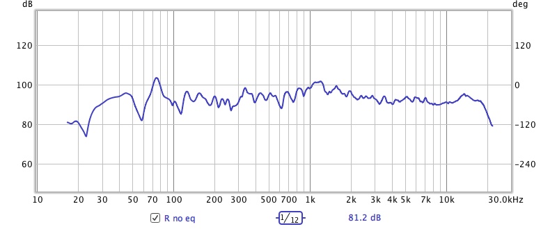

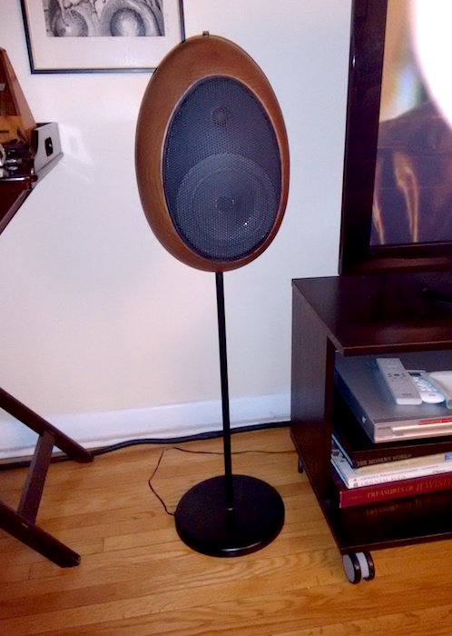

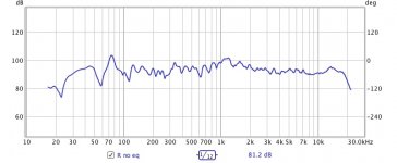

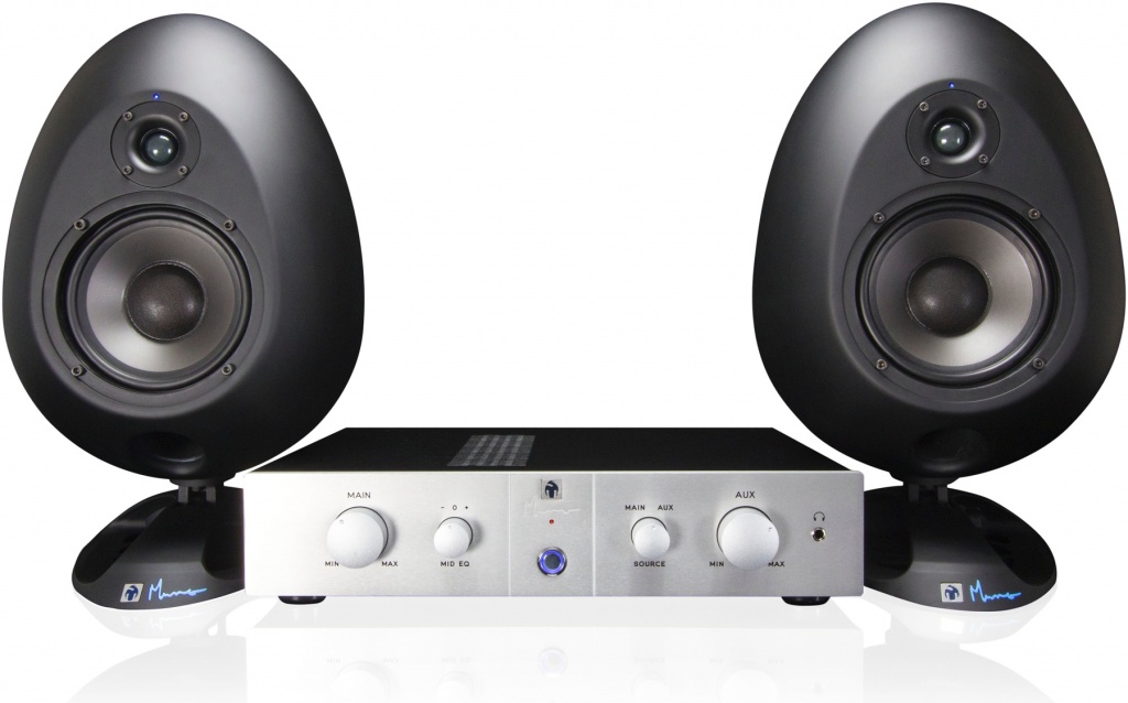

This egg was designed by Paul Young around 1980 for the Dayton-Wright division of Leigh Instruments. Crossover very complicated like LS3/5A and has choice of jacks for near to wall versus far to wall. Hangs, stands, rolls, leans, from top or from bottom, all kinds of mounting came with it. I like the little stands, in the picture. Leigh came to a bad end so it never was put into full production. I own two sets.
I can't say much about the REW trace except 1:12, no EQ, prolly far-field, and seems quite spectacularly good for a little two-way speaker.
B.
B.
