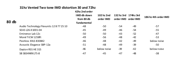

shrub0 has tested quite a few:
https://www.diyaudio.com/community/...fers-distortion-and-15-dollars.360855/page-12
Post #236 has a spreadsheet of IMD results including the SB34NRXL75-8.

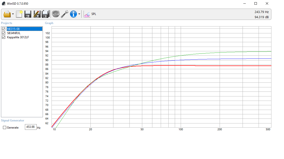

You definitely won't find many subwoofers with high SPL at 1w/1m. That's because the sub-bass area isn't really related to the 1w / 1m measurement. The sub-bass physics are different than the physics where these drivers define their efficiency rating. Consider the WinISD modeling of 3 drivers driven at 1W with >6dB difference in "efficiency" in your proposed 80 liter box with tuning from 22-25Hz... They're completely on top of each other below 50Hz, then separate as frequency rises.
So efficiency is not really relevant for subwoofers in the traditional sense. However, there are discussions on how that efficiency rating may affect sound signature... There is a lot of good discussion on this in the thread that weltersys linked, but it's a lot of reading to get there.
