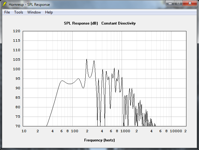

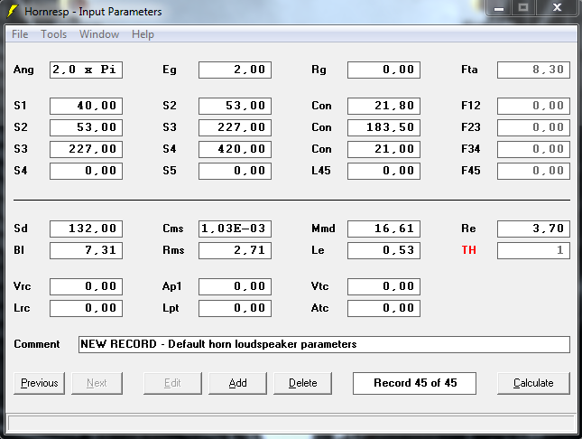

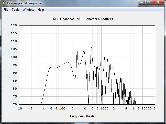

It seems the Silver Flute W17RC38-04 provides quite good price/performance ratio, see the hornresp simulations.
So I have some questions:
1. The Silver Flute has a Fs at 37.5 Hz. That is way low compared to what seems to be the general recommendation for a driver for a tapped horn, with regards to my current lower cut-off (about 60 Hz). What is the drawbacks of this? I have checked quite a few drivers, and it does not seems to be a very big difference.
2. Any obvious problems with the design?
3. Even though THs seems interesting, would I be way better off with a simple ported design and two Silver Flutes instead? It is not really clear how I compare winISD plots with those from hornresp. I don't really like to go above 30 liters in internal volume. Is TH still a reasonable way to go?

If your driver innately has a low Fs, you've lost efficiency over something with a higher Fs of the same diameter (Hoffman at work).
I'm gonna guess that the driver's a ~6.5" midbass, based on the model number (don't have time to look it up atm).
Try some PA drivers - the new Eminence Beta 6 looks interesting.
I suspect you could get similar extension using that driver and a ported box, but with a much smoother response and similar efficiency.
Chris
@ Chris, Yes that explanation sounds reasonable. It does not really matter what driver parameter is changed to lower the fs, in the end it will always strike against efficiency I guess. The Silver Flute is a 6.5'' hifi woofer.

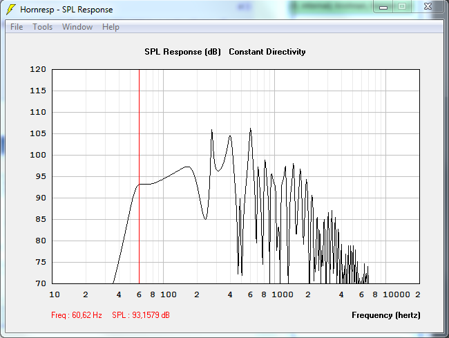

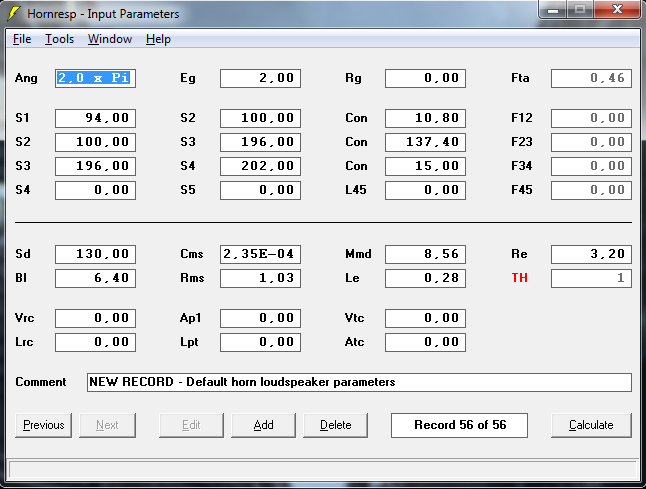

@ Both. The new Eminence Beta 6 and the Beta 8A are both 8 Ohm, so given the amplifier it looses about 3 dB max SPL and then there are no benefit over the SF, but I checked the old Beta 6C and it is really good, it can reach 60 Hz 93 dB/1W/1m in 4 Ohm, and only with 22 liters internal volume. I guess easier to build since it has constant expansion. See attached.
Thanks for pointing me towards the small Eminence Betas!
BTW I did the simulation of the Beta8A, quite impressive too.

Ummh... It should be Eminence Alpha 6C, not Beta....

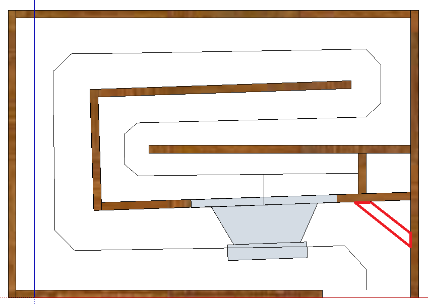

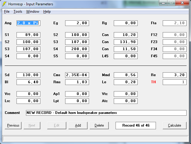

Anyway! Finally I got my stuff together and learned Sketchup and folded the horn. I did not get it quite right so there is a little volume that is lost, but I only made one iteration to hornresp and back. I have planned to do the horn 20 cm deep, internally.
The new path length is a little longer. See attached new simulations of the folded design.
Question1: I have noted that some TH's with the mouth on the side has a 45 degree surface on the last bend. See how I suggested it in my sketchup drawing. What is the purpose of this, should I add that? How does that affect path length?
Question2: I have not taken any account of the back of the driver in the horn path. Does it affect a lot so late in the horn path? Also, if I take it into account, it is the projected area that I should consider or the volume (mass) of the air that is missing due to the driver?

Its difficult to compensate for the presence of the driver in the pipe. Most ignore it, and still get results that are very close to simulation.
I'd view the 45 degree piece as optional. It won't affect the path length much, but would provide a slightly smoother exit. At these frequencies and SPLs, I really wouldn't expect much difference.
Chris
PS - would you be able to post dimensions of your folded drawing?
I'm working on a portable speaker, this would make a great additional woofer. I even have a similar driver waiting 😀
IMO it serves no purpose but to complicate the design. It's basically useless at bass frequencies.
It will have an effect, the magnitude of which will depend on the cross-sectional area of the "horn" at that point. You may want to consider making the cross-sectional area slightly larger for that section of the horn to compensate for the effect.
The s3 is 193 cm^2. Not sure how much the back of the driver takes away from that. So far only the depth in the drawing is correct, the rest is a guess. I will measure it once I have ordered it.

I'm interested in how this turns out for you. The Alpha 6A doesn't strike me as a driver that will work well for midbass duty. Fs is a bit too high for my liking. I'd be tempted to look at using the B&C 6NDL44 instead. It's a much more expensive driver, but the lower Fs and higher Xmax should make it more suitable for loud midbass duty.
Yeah, I agree regarding the Fs but hornresp seems to be ok with it. I hope I have not made any major mistakes.
Actually one of the candidates I had from the beginning was the 6NDL38 which is fairly similar to the 6NDL44, but both of those are 8 Ohms drivers. The chip (TAA4100A) I'm planning to use gives almost the double output into 4 Ohms, so even though the B&C drivers models better the system max SPL will be almost the same and then the price difference is hard to justify!
