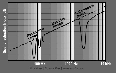

Just a little more information for you (adapted from http://squ1.com/archive/index.php?sound/transmission.html)
Sound attenuation in ordinary enclosures is the result of an interplay between mass, stiffness and damping. At low frequencies (below the resonance of the wall), transmission depends mainly on the stiffness of the wall, with damping and mass having little effect. The effectiveness of stiffness in the attenuation of sound transmission decreases by 6dB for every doubling of frequency (one octave).
At slightly higher frequencies the resonance of the wall begins to control its transmission behaviour. Because every panel has a finite boundary and edge fixings, it will have a series of natural frequencies at which it will vibrate more easily than others. These are called resonant frequencies and consist of a fundamental frequency (having the greatest effect), and integer multiples of this fundamental called harmonics (having less and less effect). The fundamental resonant frequency of a panel can be calculated as follows:

High frequencies cause bending or ripple waves that travel longitudinally along a wall or panel. The wavelength of a bending wave is different from that of the incident sound wave which created it except at one frequency, the critical frequency. Unlike compressional waves, bending waves of different frequencies travel at different speeds. This means that for every frequency above the critical frequency, there will be an angle of incidence at which the wavelength of the bending wave is equal to the wavelength of the impacting sound. This condition is known as coincidence.
When coincidence occurs it gives rise to a far more efficient transfer of sound energy from one side of the panel to the other, hence the big coincidence-dip at the critical frequency.
The lowest frequency at which coincidence can occur is when the angle of incidence of the sound is at 90° (grazing incidence) and can be calculated from:
