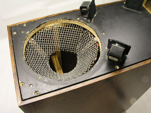

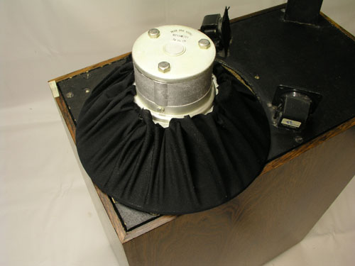

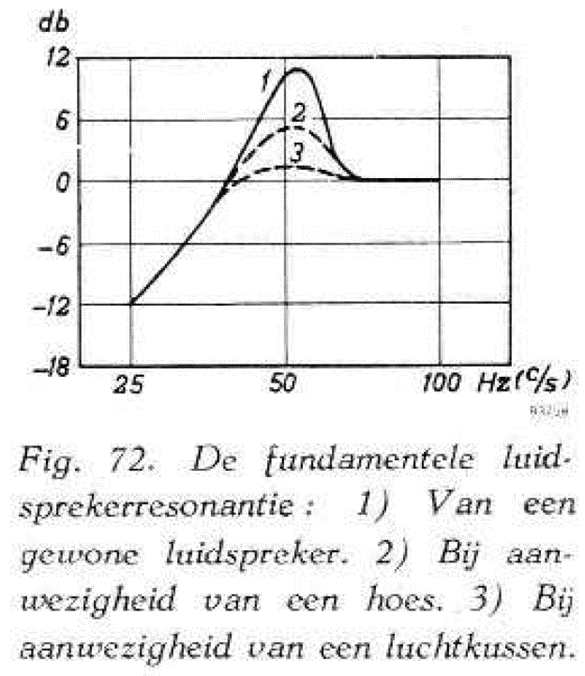

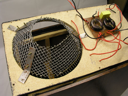

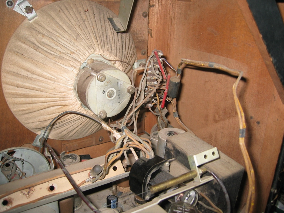

Few weeks ago I encountered a Sonab speaker (I think it was a OA5) fitted with a Philips M9710 driver, the back of the driver covered with a basked lined with damping material.
Photos from Troels Gravensen website here.
Troels descibes the purpose of this construction.

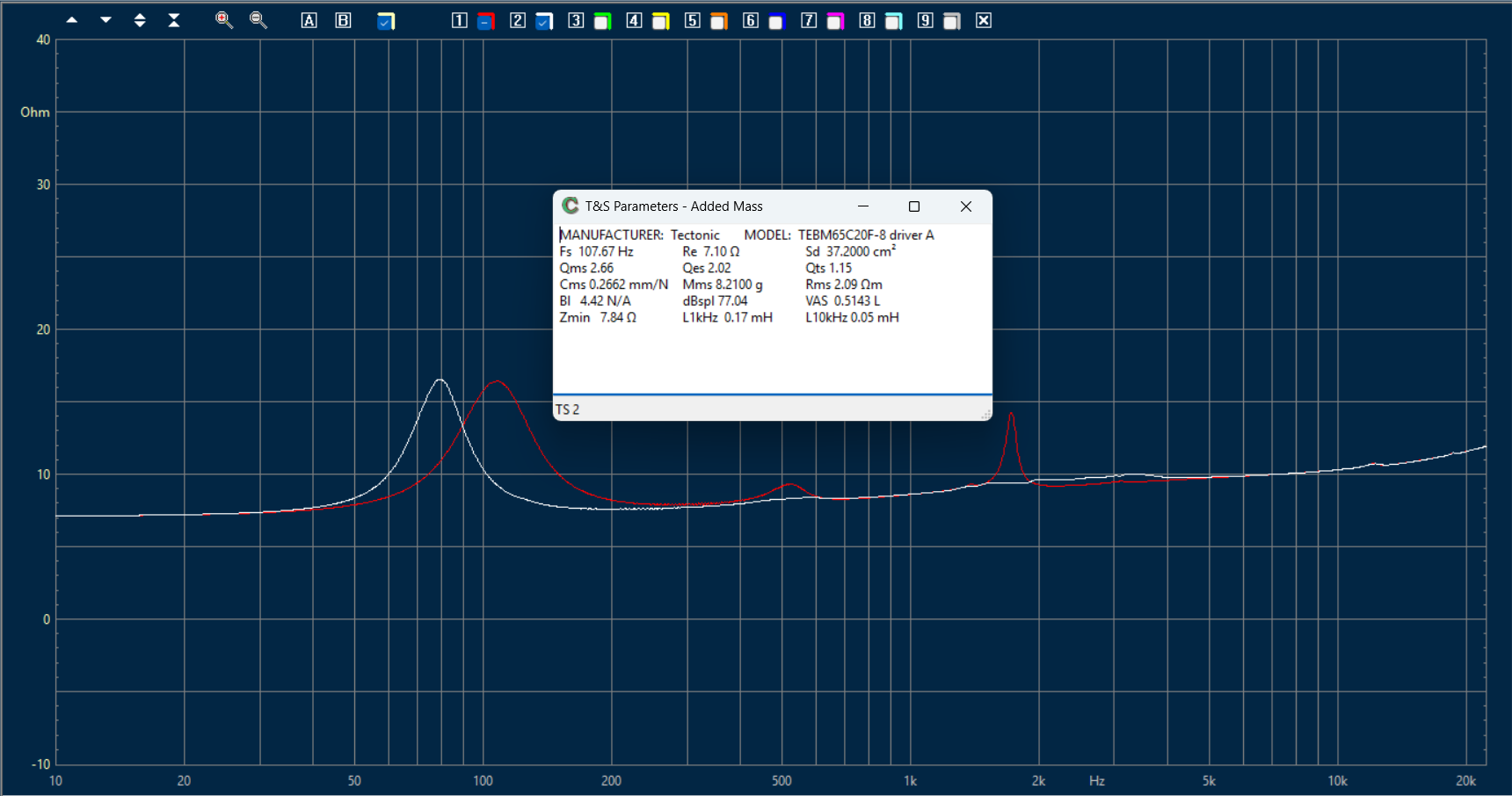

To keep it simple I just covered the back of the driver with gaffa tape.

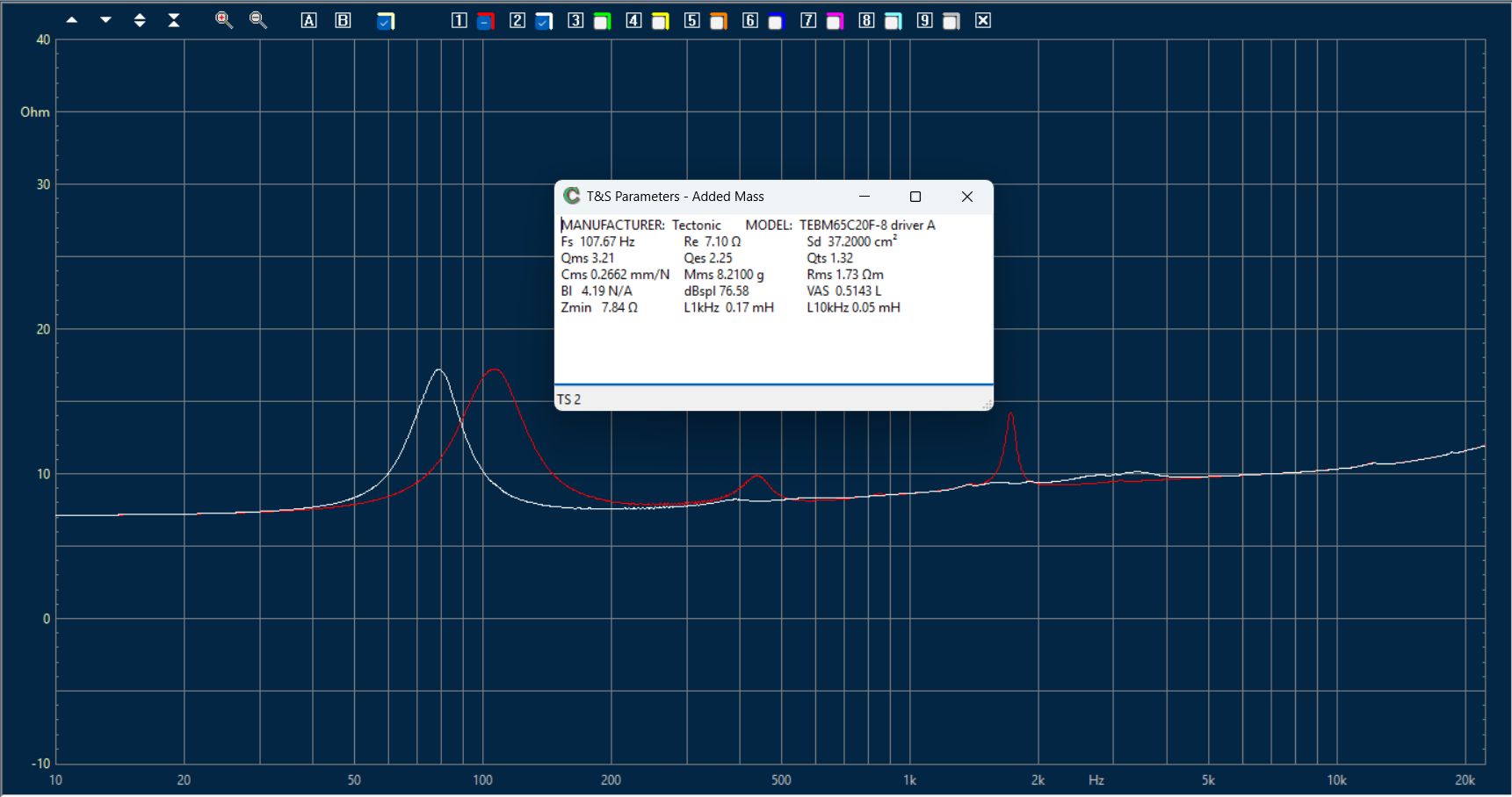

And measured again the TS parameters and impedance. Red is driver impedance, White driver impedance with added mass (7 gram)
Effects:

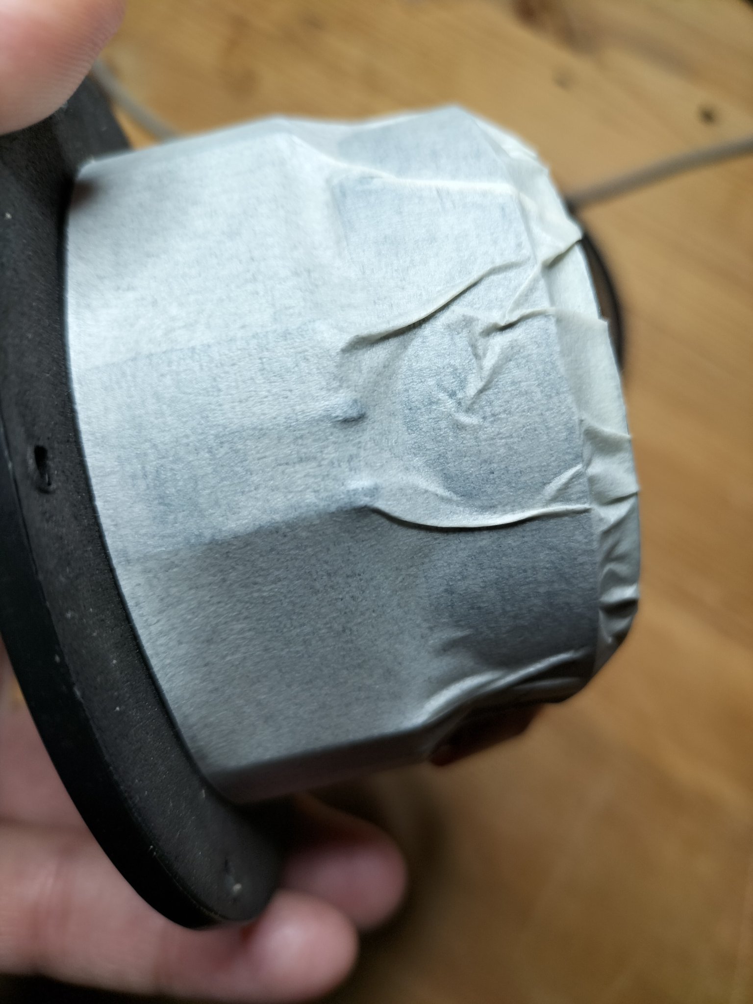

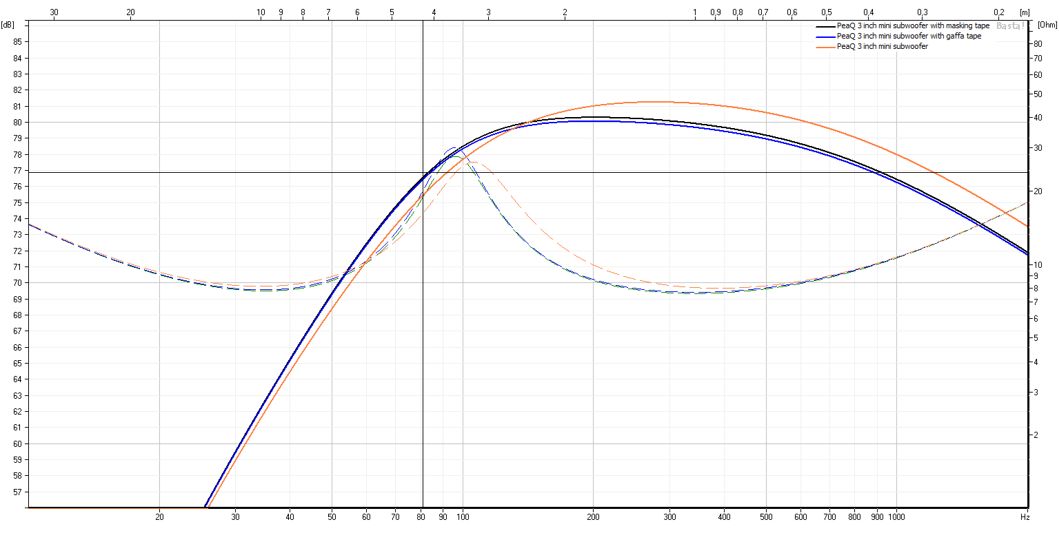

I repeated the experiment with masking tape instead of gaffa tape. The result was essentially the same. To illustrate the effect of these changes I simulated a closed box with Basta:
Box 2ltr
GHP C=1200uF
Viso=80%
Qb=20
driver no tape Fs (-3dB) = 103Hz, Eff 81,2dB
driver with tape Fs (-3dB0 = 80Hz, Eff. 80,3dB
So for a loss in efficiency of about 1dB we can lower the Fc of the speaker from 103Hz --> 80Hz. The effect seems to be caused by the added mass due to the air enclosed between the cone and tape, and the added resistance to the air moving.

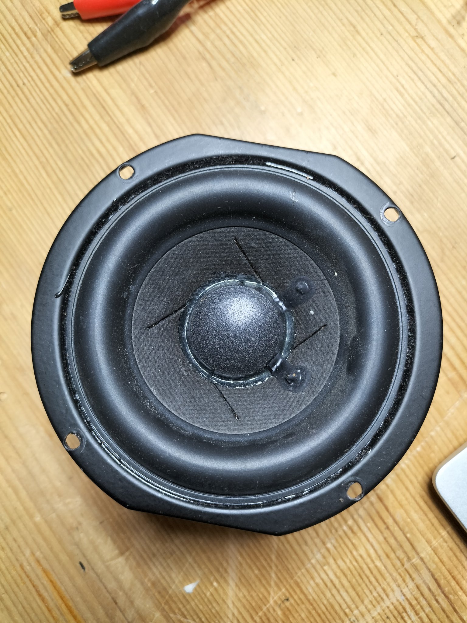

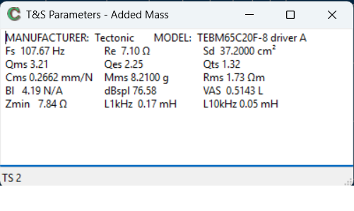

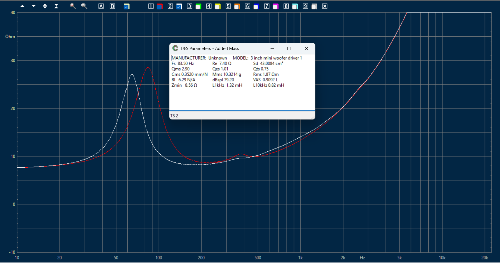

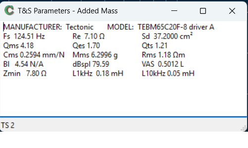

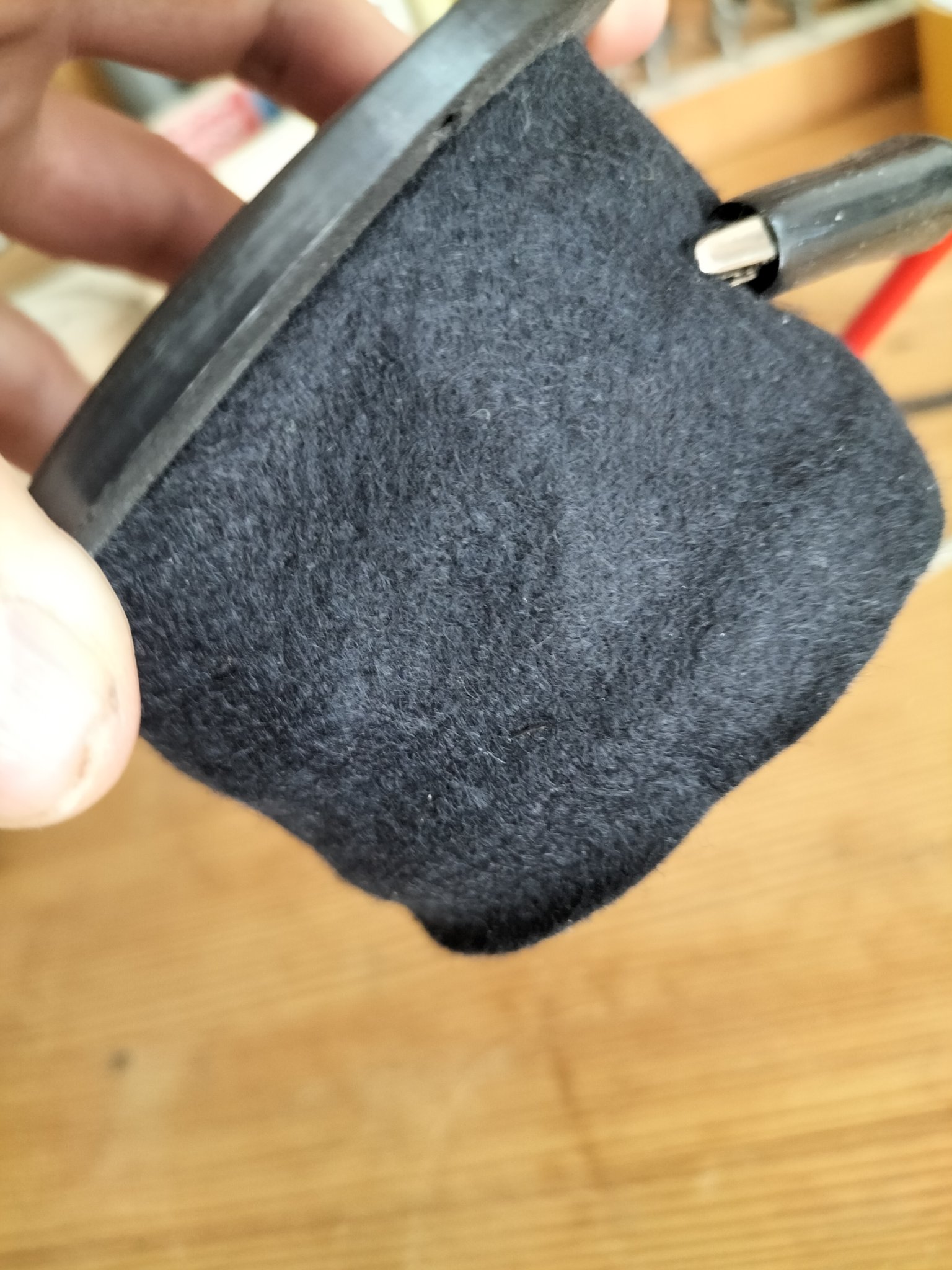

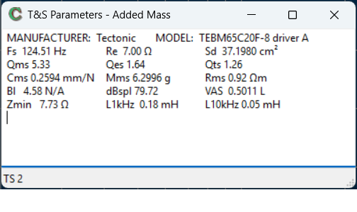

I remember having seen similar constructions in fifties and sixties radio's. Seeing it again made me curious, so I did a small experiment using a pair of mini 3 inch woofers (originally from a pair of Peaq PC speakers). I measured the TS parameters, shown right.the 9710 driver placed in a metal mesh basket with some heavy glassfiber material between driver and mesh, making a low-pass filter that can be adjusted due to the basket being suspended on three screws that allows you to increase or decrease the acoustic resistance of the fiber material. An acoustic vent, sort of. Something similar can be found on some Lowther drivers.

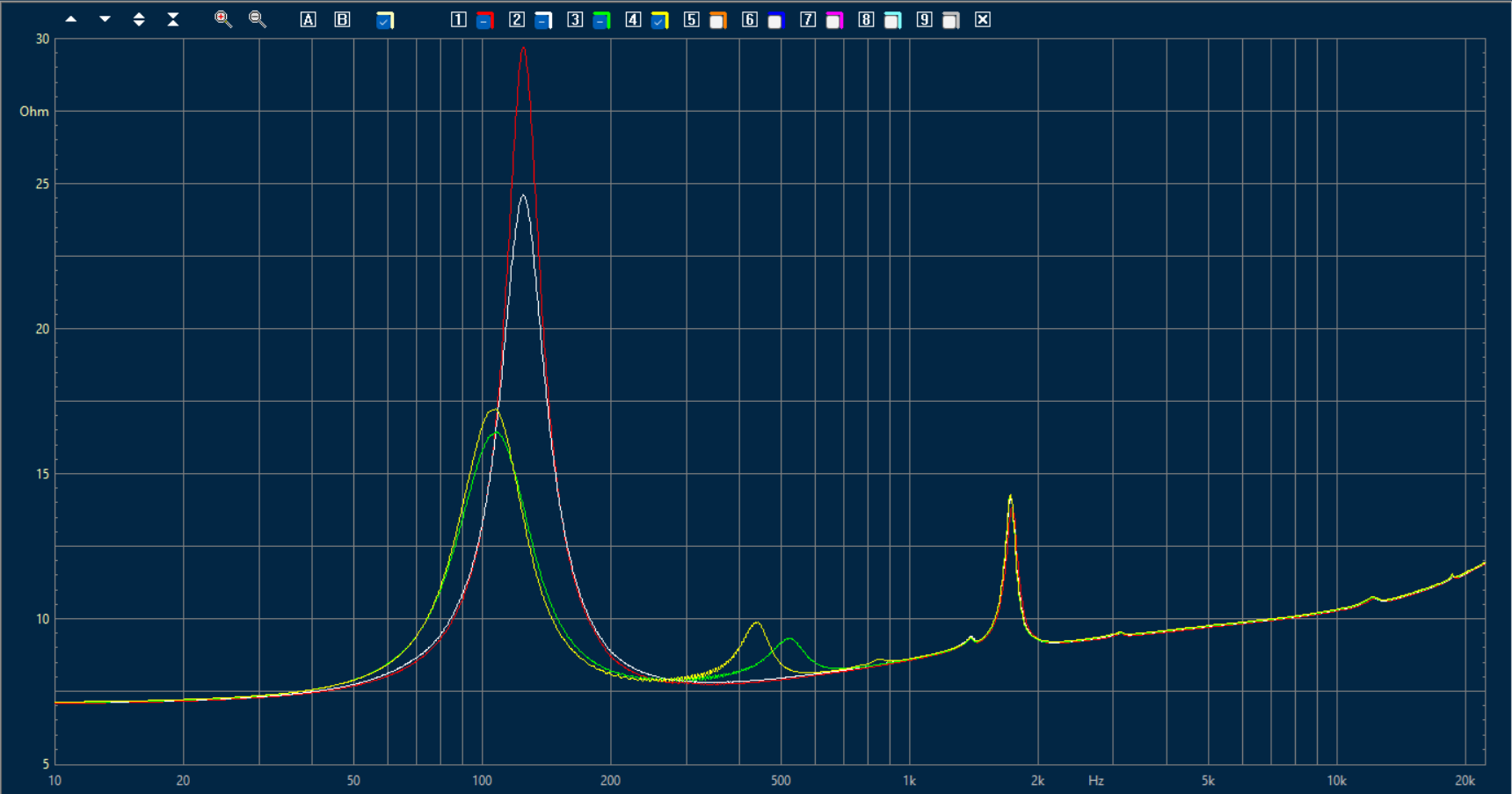

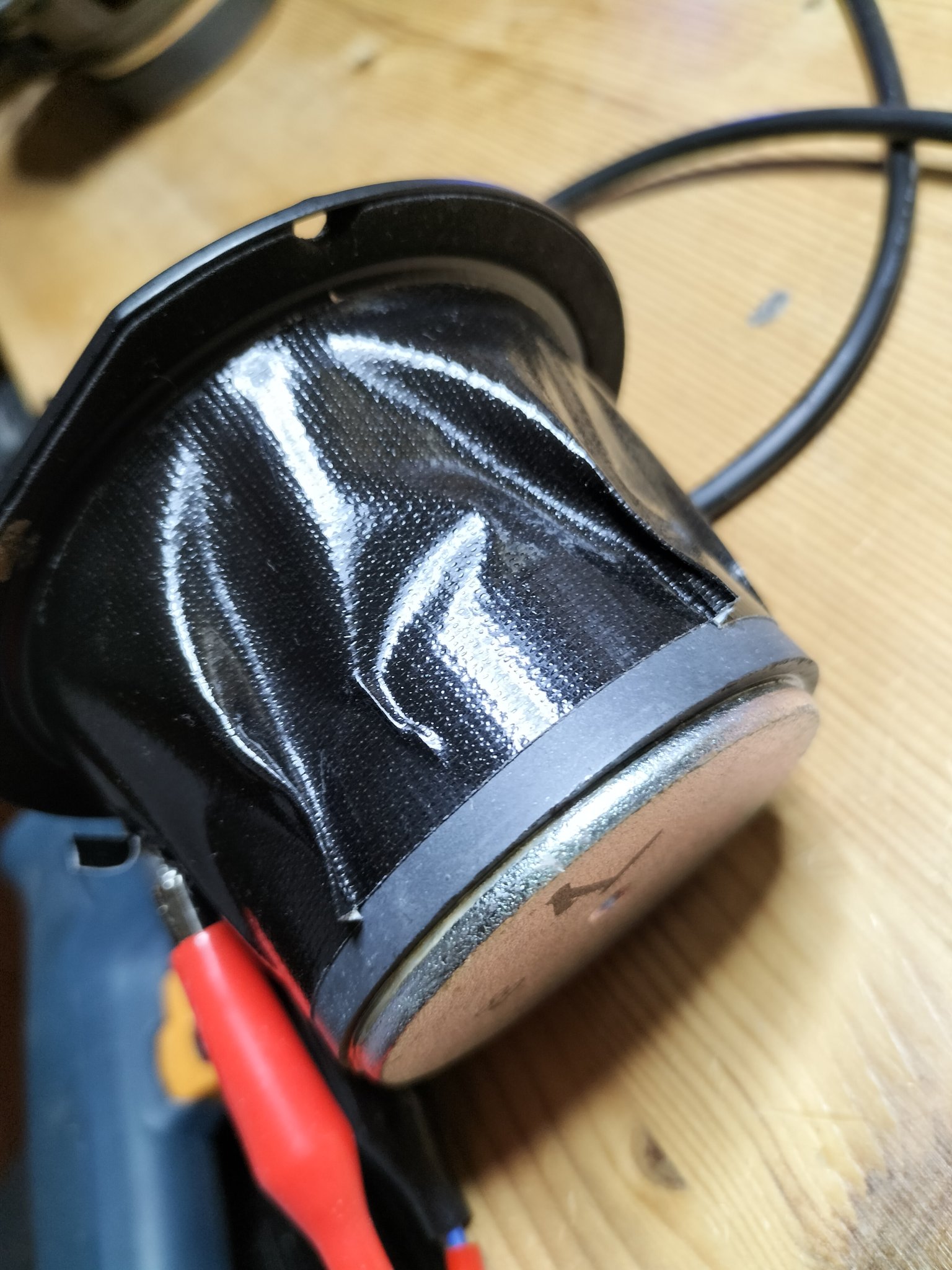

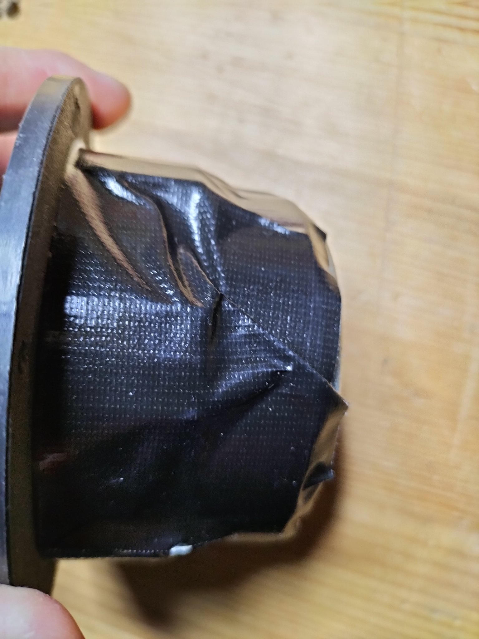

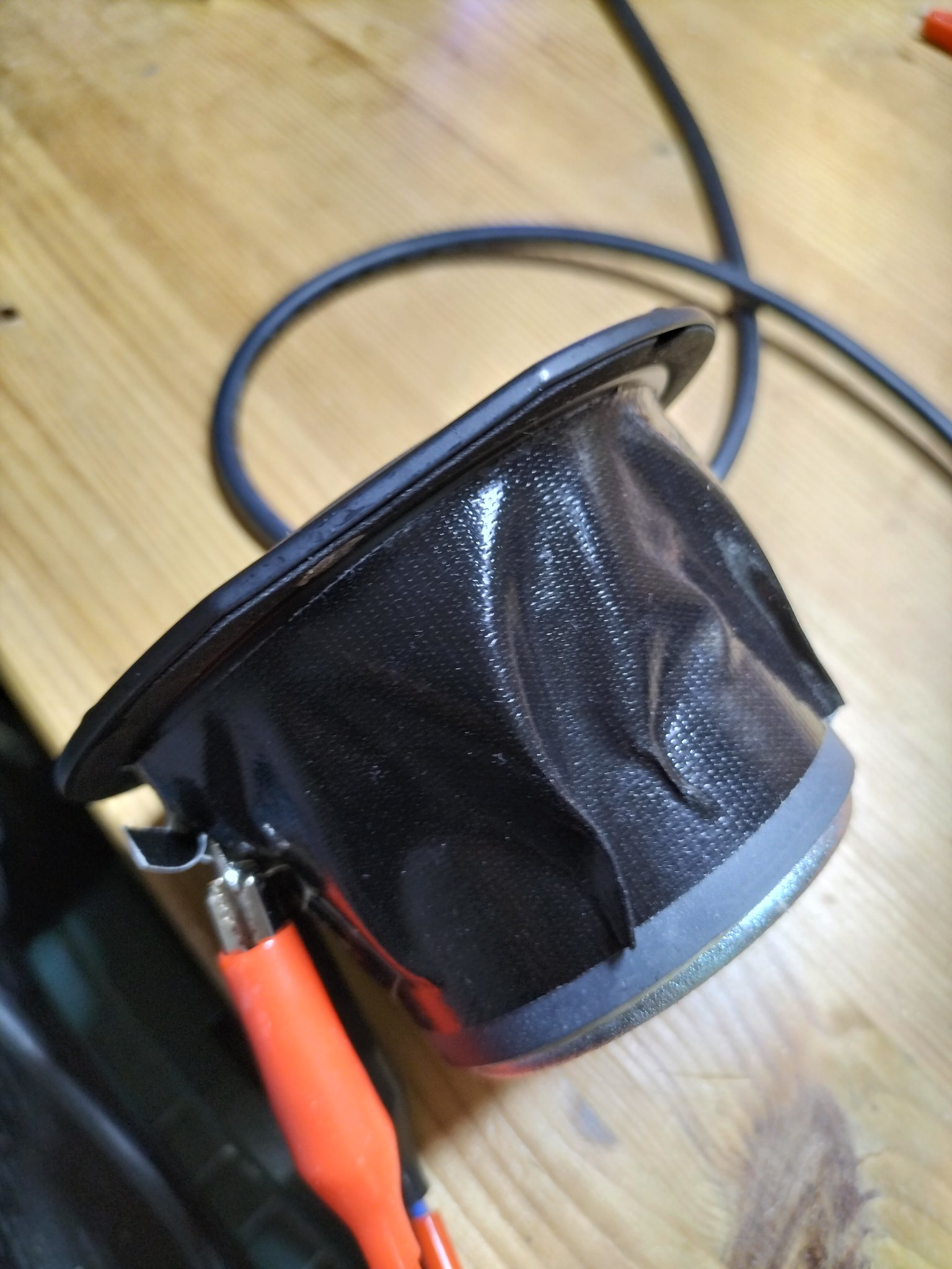

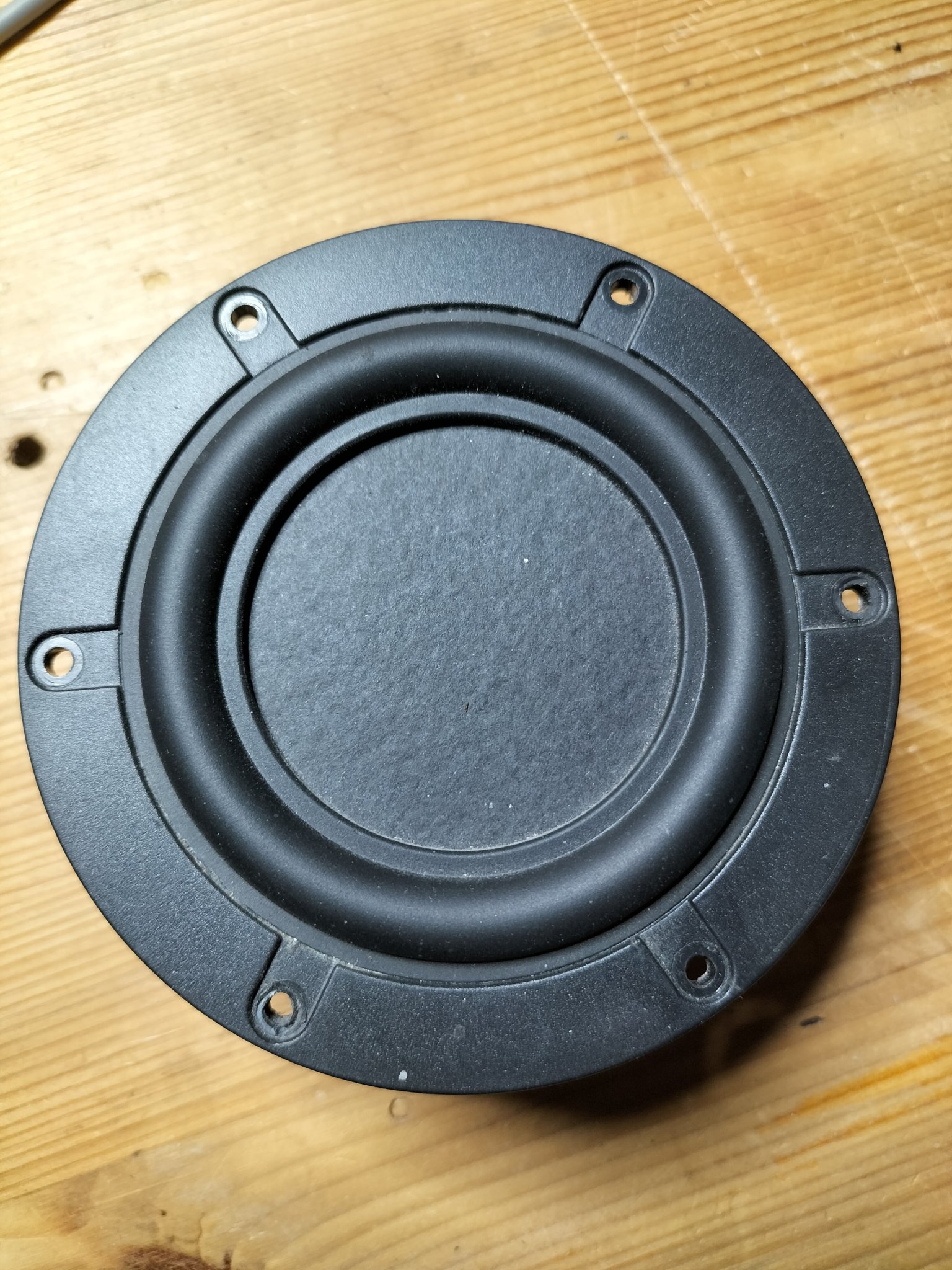

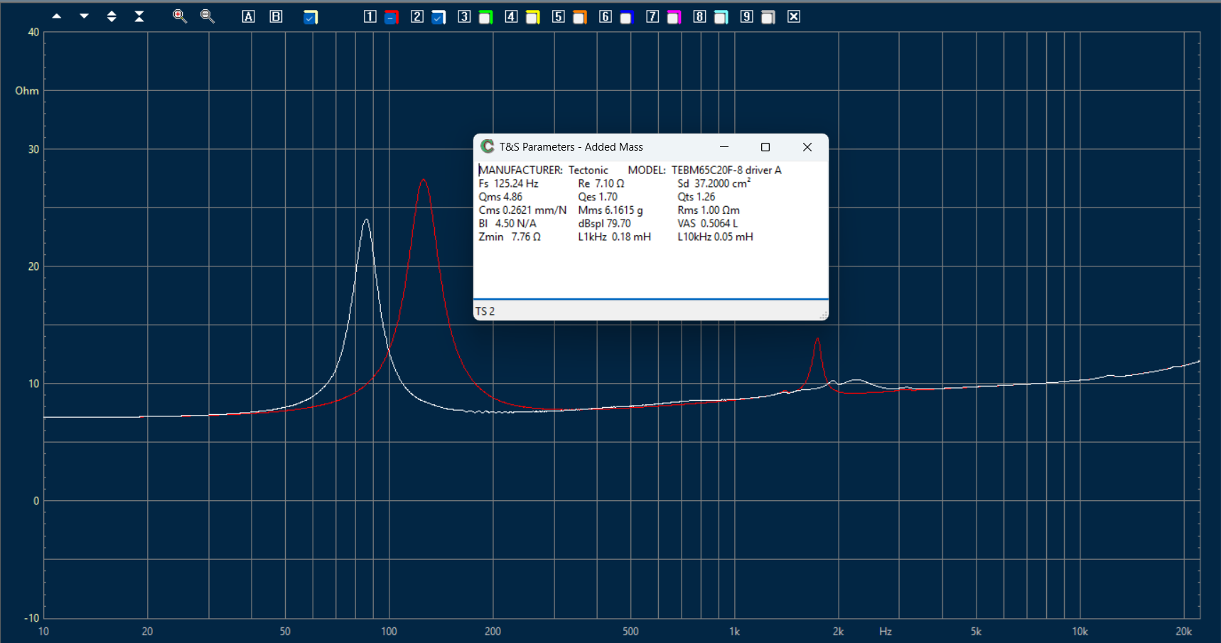

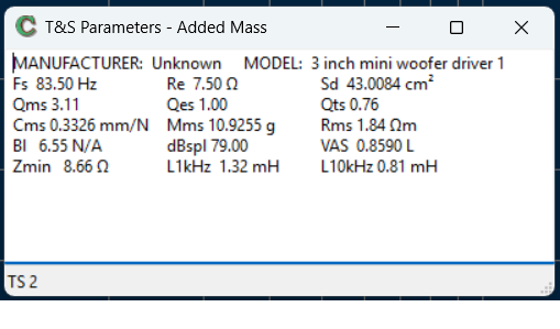

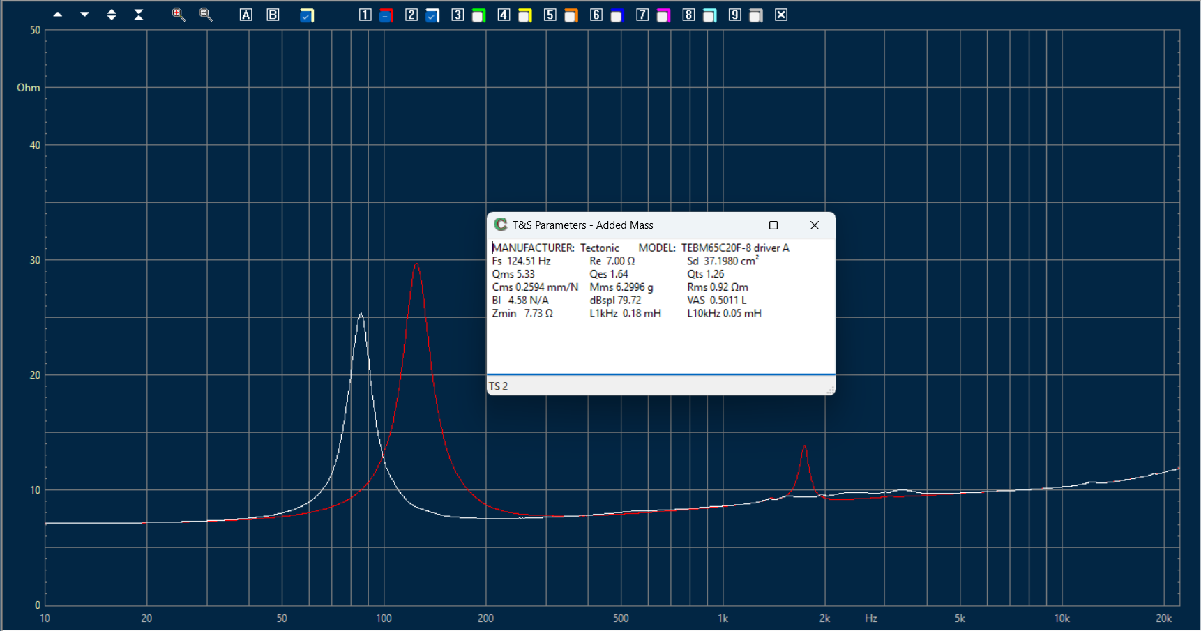

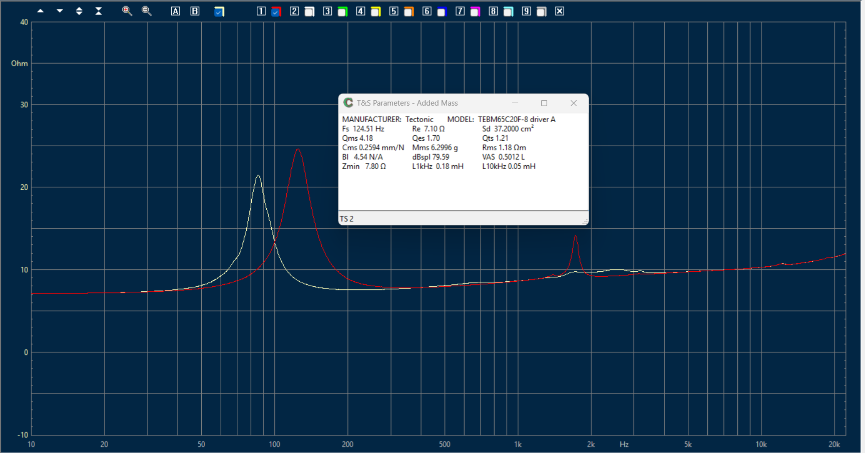

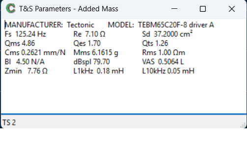

Effects:
Parameter | No damping | With damping |
Fs | 91,5 | 83,5 |
Qms | 4,18 | 3,11 |
Qes | 1,0 | 0,87 |
Qts | 0,72 | 0,76 |
Cms | 0,383 | 0,333 |
Rms | 1,09 | 1,84 |
Bl | 6,24 | 6,55 |
dBspl | 81,4 | 79,0 |
Vas | 0,99 | 0,86 |
Mms | 7,9 | 10,9 |
Box 2ltr
GHP C=1200uF
Viso=80%
Qb=20
The method used by Sonab seems to be a way to control the effect.
