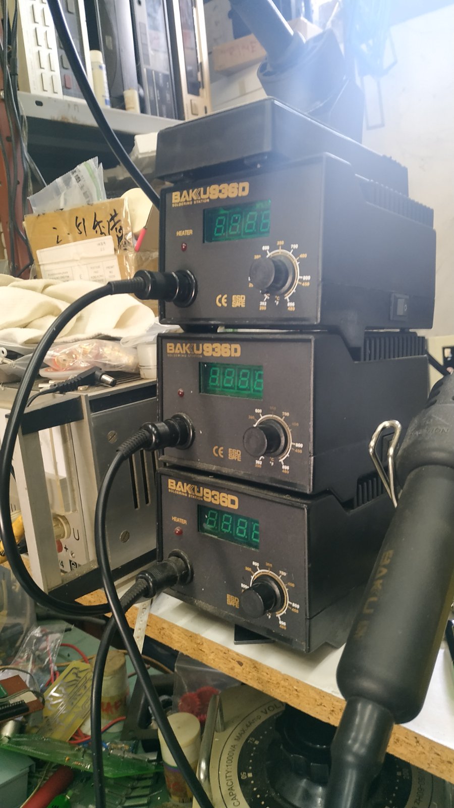

well, those are details you're grasp by osmosis, if you hang here long enough 🙂
- decent solder station with several tip sizes ; Chinese brothers are making great copies of Hakko - I have 3pcs of Baku 936D, each armed with different tip - but most important is mentioning biggest one - chisel form, 8mm wide.. that one cranked tyo max is breeze for soldering fat wires

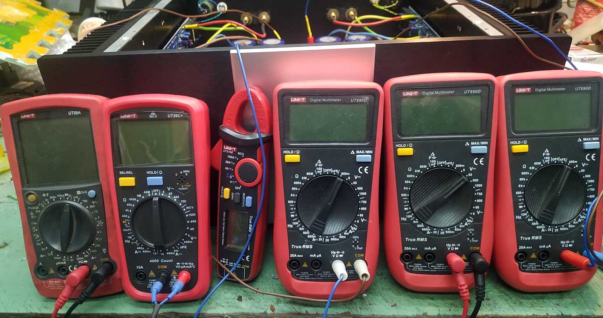

-DMM - good times these are - i have proper stable of UNI-T; absolutely not crying for Fluke or whatnot; had them, have them, but good times these are; buy as many you can - nice to clip in several at once, and just to glance at each, instead of frantically move probes around having one too less or just one

I got it, grab a stack of reasonably priced DMM to test at multiple locations simultaneously.

Great advice by ZM. I never thought of having three solder stations stacked like that. Nice to not have to switch tips. I have three Flukes and use them daily. You need 3 DMMs. Fluke 101 is only $60 nowadays and well worth it. I love the silky feel of the selector dial. You can drop kick them and they won’t break. Good copper solder braid/wick. If you are older than 45, flip up binocular magnifiers for old eyes. Good diagonal cutters and good needle nose pliers. Use premium leaded solder from well known brand. Avoid Chinese made solder. Their irons are ok but not the solder.

Don't think I'll reach the point of 3 soldering stations but I love the idea?appr. half of my stable
Fluke goes for field work, in fire and water, you don't need that
edit- pic of Tower of Power, too 🙂
I ordered a Uni-T 139C to play around with. Look like the current version of the UT890 can also be had a decent price to rapidly expand the flock of DMM.
