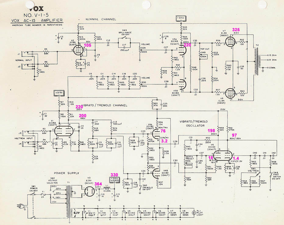

The original Vox AC15 from 1960 used an EF86 in the high gain input feeding, through the tone and volume control, the ECC83 phase splitter, (you will note the pair of 100k anode load resistors, normally 100k and 91k now).
Nothing complicated about either schematics. One can get a gain approaching 100 from an ECC83, much more from an EF86. EL84s have 1k5 grid stoppers, not 5k1.

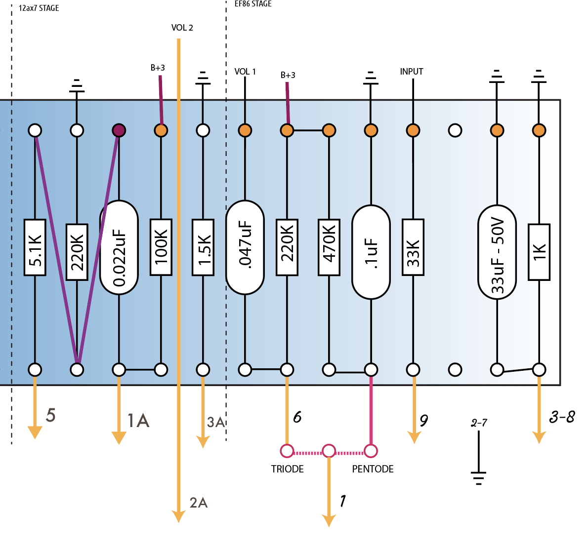

There are some issues with the noise, as soon as I rise the volume there is some audible disturbance. Up to half way is unnoticiable, but after that, it becomes annoying. I thought it could be some bad fiter cap, but now I am not sure. Maybe picking some noise from elsewhere.
I attach the layout here, perhaps it might lead to improve the amp.
